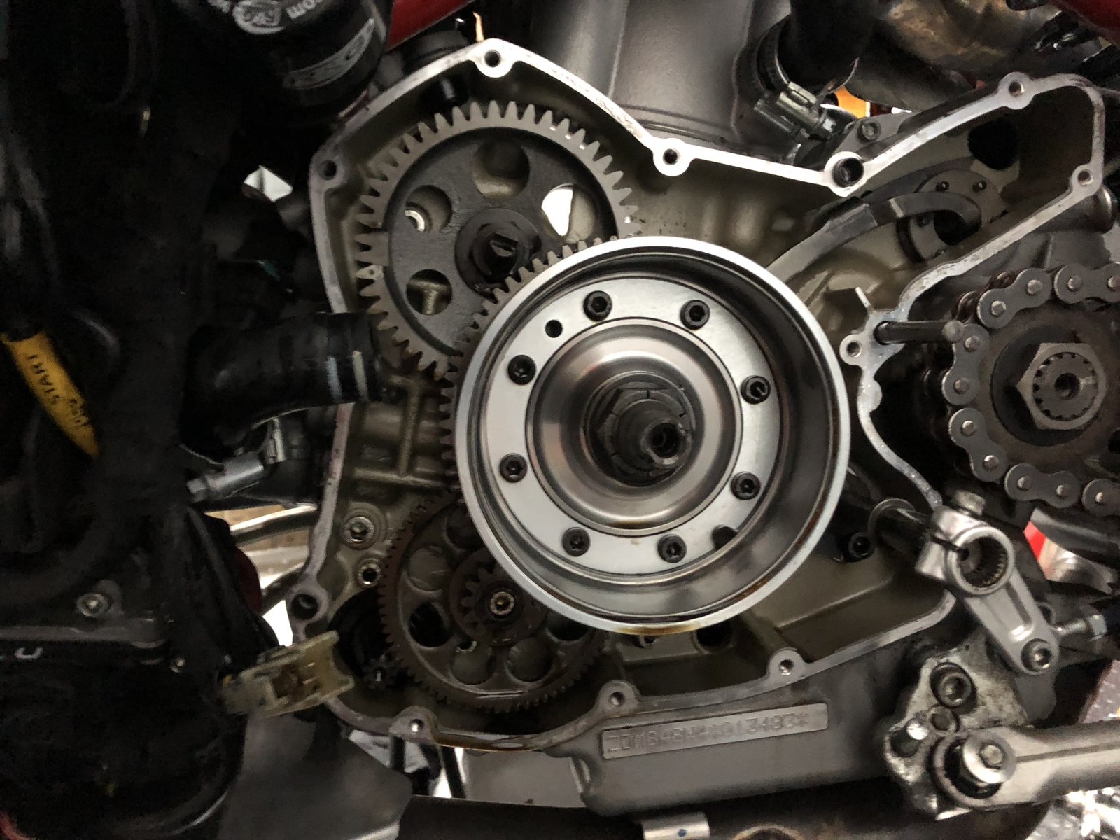

    So, Ive taken both covers off and the belt tension covers the learn the bike and also look for anything obvious and heres where my questions are, on the below picture the starter gear cog which gears up the starter power has free movement back and forth (along the spline, no sideways movement) is this correct??? It is secured with bolt, washer and circlip, everything else looks in order.

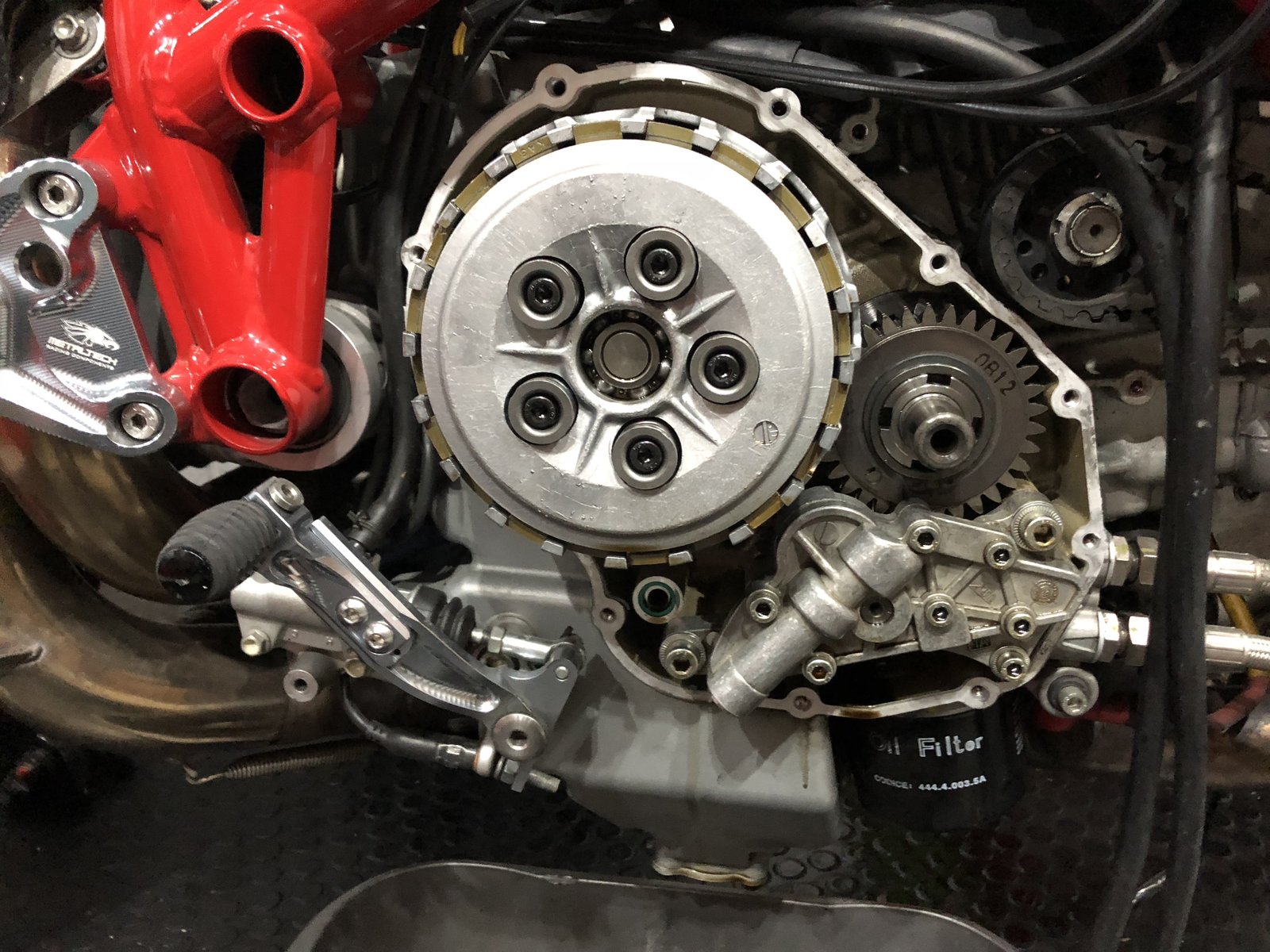

    Secondly, when I took the clutch side cover off (alternator cover, clutch salve was already removed) I noticed the centre bearing(if it is a bearing) that the clutch pin from the slave cylinder pushes into from behind moves inwards by 2/3mm, I appreciate when the slave is connected on the other side this may take up the movement it has but without rebuilding the other side I can't recreate this so thought id ask. fvqcSrtMRG+ZQwfyqzvx3Q.jpg

  2. Update, I have found out that on the intermediate gear it was updated with a floating pin design so that answers the float I have is normal.

  4. Answer to your clutch pin, yes it will move when the slave cylinder has been removed, but I would say your bearing should be a bit tighter than that. When you install your slave cylinder try it again.

  6. Thanks, I’ll rebuild it back up and see how it looks, if this moves more than it should that maybe it would produce the sound I’m having which would disappear when the clutch is pulled in..

    How's my 848 running dude? (Apart from this lil noise) re that, ive had 2 presure plate bearings (1 ss 1 620ie) seieze up, neither were real noisy but a constant chirping sound... easy cheap fix...

  8. I have just changed my clutch and pressure plate and I reused the old bearing that we are looking at. I had to belt mine out of the old pressure plate so it should be a bit tighter than that.

  10. Perfect, appreciate it pal, im in the garage tomorrow so ill pull the clutch off and get one ordered. Thanks for the help.
