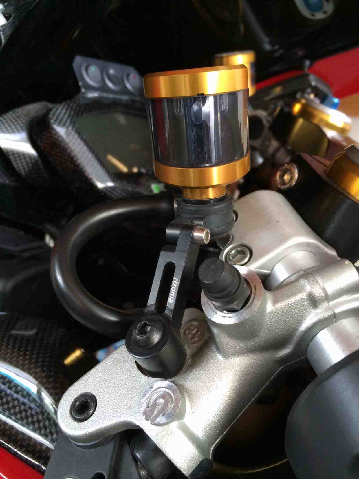

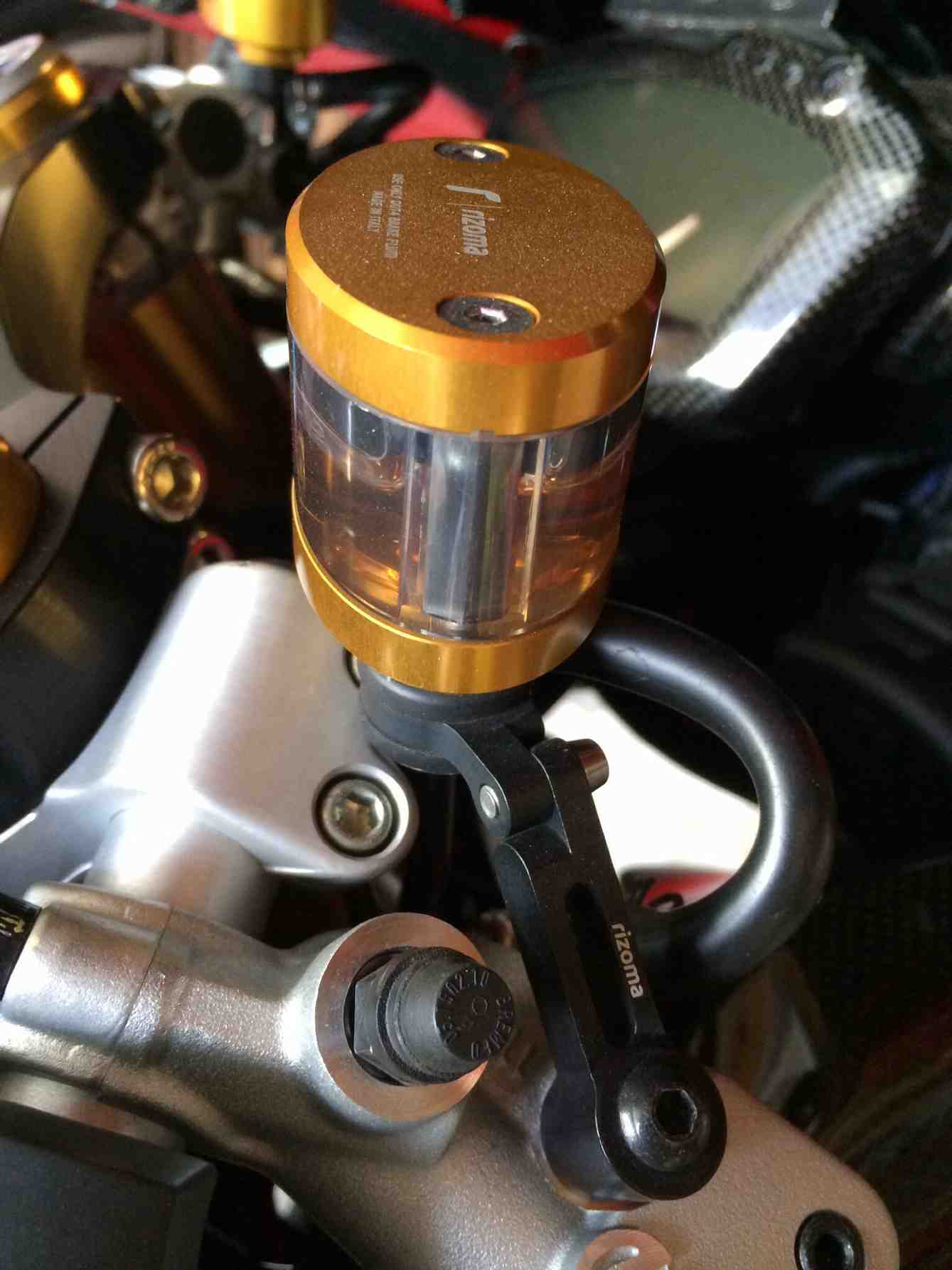

Hi Calle3, yes I do have the same brackets on my 848 & they were a pain in the ass to install but I figured out a very easy solution...put the brackets upside down & your problem will be solved! I went out & took a couple of pics for you so that you can see how they will go on without any drilling or other modifications but straight forward! The clutch side... The brake side...
