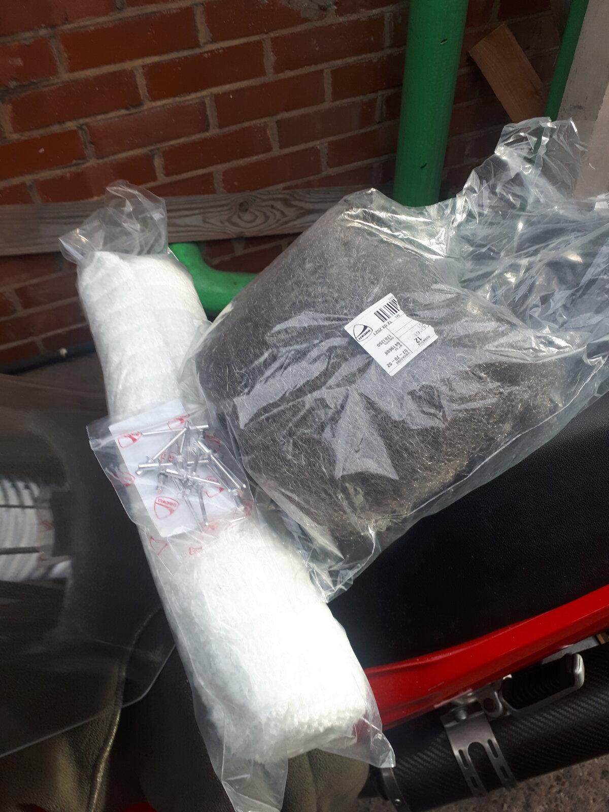

  10. I'm going to repack it myself. Got everything I need from Pro twins £54 shout out to Pete there who was very helpful. 20210526_182923.jpg
