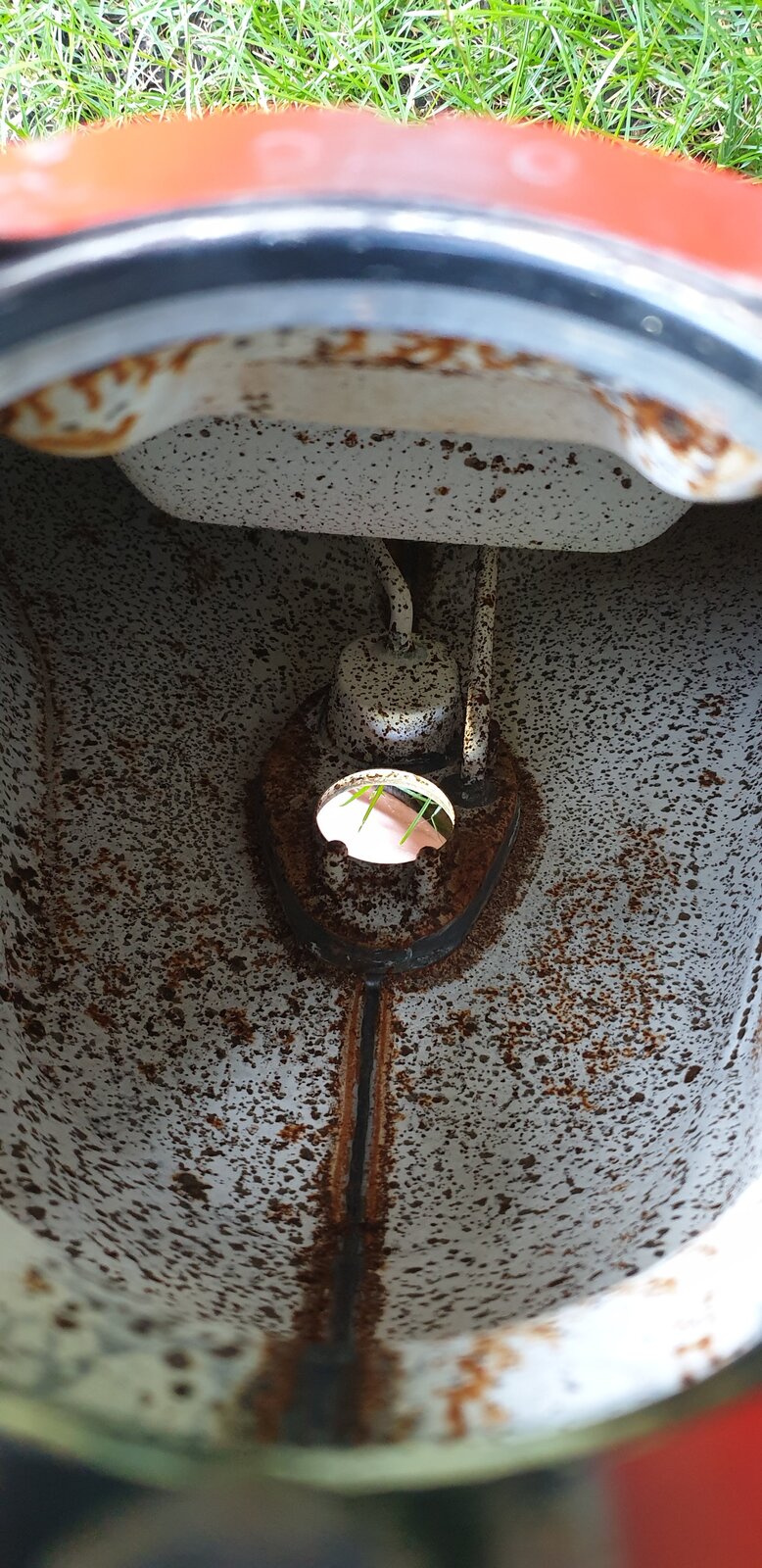

  1. Any suggestions on how to deal with a neglected 999 tank? I'm considering cleaning and sealing with POR 15. Anyone had to deal with something similar on a 999/749?

    I finally found some time 2 weeks ago to flatten back the rust using 150grit paper.
    I was cautious about using any chemicals for fear of flash rusting, if I wasn't going to follow up with a sealant of some sort.
    Earlier in the year i used a more extreme technique involving brick acid on a couple of old yamaha tanks, Then successfully sealed with POR15.
