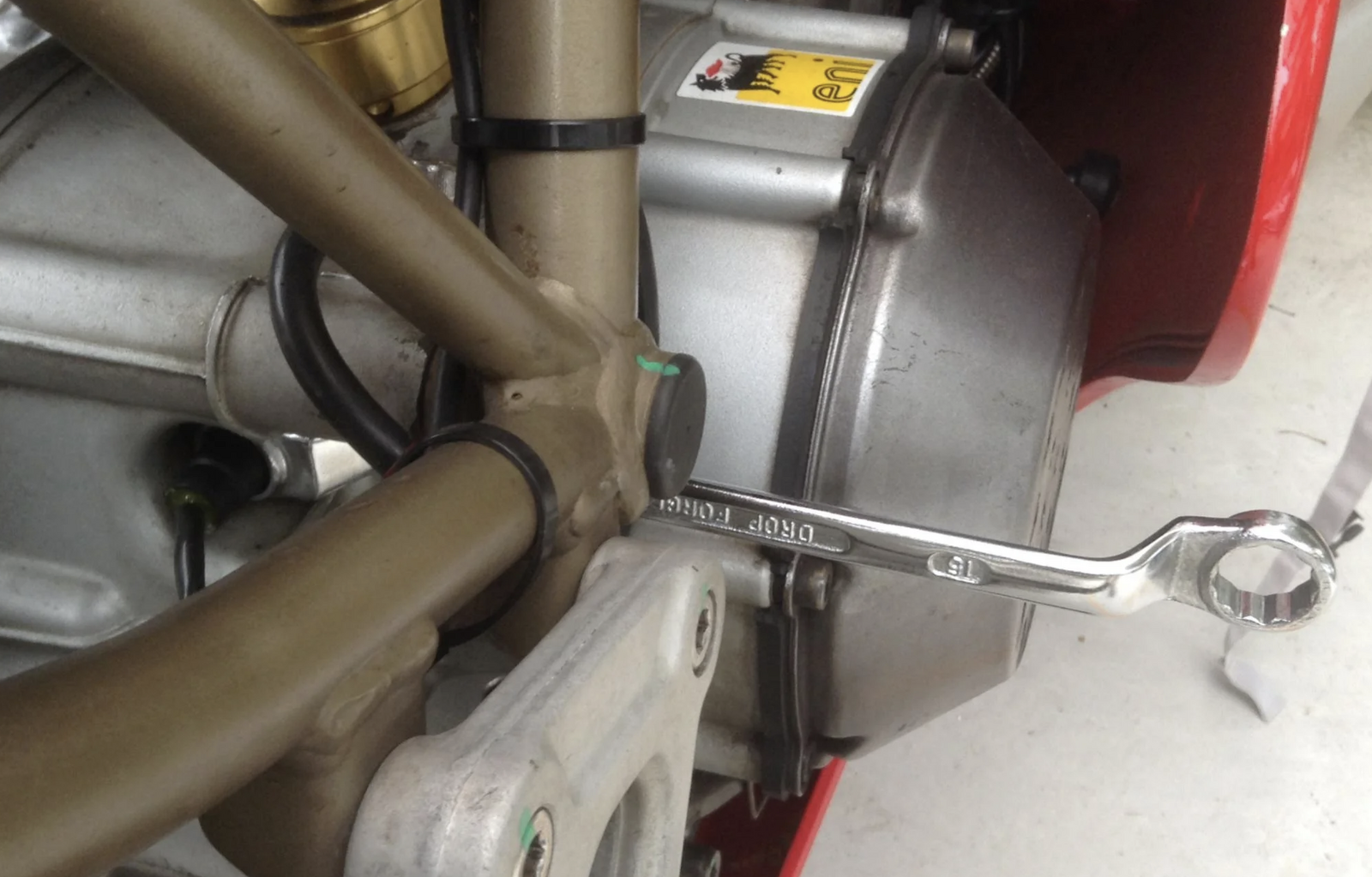

  5. The neutral light, oil pressure light and fuel warning light are all supplied from the same so worth checking the fuses if none of these are working. The neutral light switch is located at rear of gearbox on the clutch side and can be difficult to change due to poor access.

    As @Birdie mentionned above, it may be that the switch itself (located at the back of the gearbox as shown on @Derek picture) may have moved off a bit. This switch works in a weird way. Pressed too much, no light. Not enough, no light either. The best way to test it is to:

  14. See post a few up with spanner picture
  15. going purely by memory, i think this idiot light was redundant on some models, hence you finding no supportive information. It would have been a lead from the regulator, and i remember some aftermarket regs did have this additional lead. I had a 748 where the totally intact red light function was wired up to an alarm (so flashing when parked) instead as a result of it not being used in std form.
  16. Heavy rain outside earlier so got stuck in and removed and replaced the neutral switch, access is limited to say the least!..but it was made much easier by using this old box spanner I inherited from my dad when he passed...not sure of the size, it would be imperial, but it fitted over the 13mm hex on the switch like a glove and the wires passed through its body...job done:upyeah:
