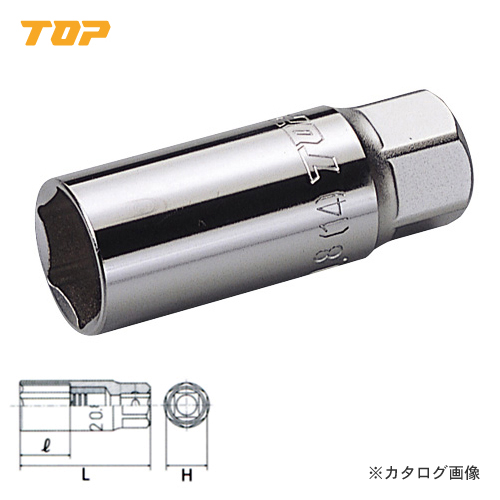

  10. I just got a gearbox sensor but I'm having trouble trying to get the old one out, I bought a box spanner and it is very difficult to get it fitting due to lack of space. Is there a special tool ? If so where do you get it ??
  11. The new plug comes with a cable right ? So just snip the old cable and put a deep socket over it ??
  12. But how do you tighten the new one up ? Cables not going to work with the deep socket
  13. Does the electric lead plug fit through a socket ?? If so, slide normal socket right down the cable, tighten, then remove, then connect up ??
  14. Your only going to get it hand tight as you can't connect the socket driver with the cable going through. The vortex kit is new to me, I'll investigate, see if a mate has a set.
  15. Not if your socket has a hex top like some do, can then put a spanner on it. Quite a few spark plug sockets have hex tops.
  16. Or even use a small stillsons wrench on socket to nip it up?
  17. This seems like it will do the job I'll get one of these later today :upyeah:
