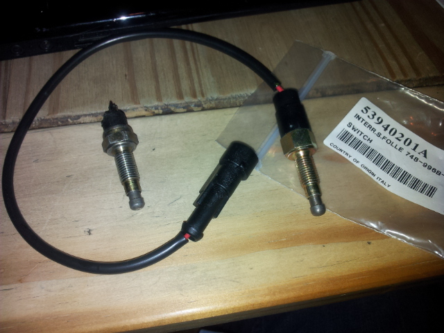

    I have a 'T' registered ST2. The neutral switch was broken when I bought it. I have purchased a new one, but think I may have got the wrong one.
    My switch had two wires on it, but the one I purchased has one wire coming off of it, into a round connector with a single pin in it. The part number is 53940201A.
    Mechanically they look identical, but electrically different.
    Can the new one be fitted or will I have to send it back? Unfortunately, I bought it from the Netherlands and had it sent over by UPS
    Any help or comments appreciated
    Cheers
  2. You should be able to make it work as long as you have basic electrical knowledge and some ability to test. Check your connection to loom and see if they both have 12V, both are earth, one of each or one is dead and one has either earth or 12V. I the last option where one is dead is most likely as 2 wire switch operates by closing the circuit.
    To test dead wire is dead connect earth part of tester to it and 12V part to battery, there should be no reading. The same 12V connect earth bit to earth point like battery or engine and 12V to wire.
    Next test only do if you are certain that one of the wires is dead and one is either earth or 12V, if it is one of each do not link them for obvious reasons.
    If you arc the two wires at the loom end where double wire switch would plug in your neutral light should light up.
    Single wire switch operates by grounding the circuit when it is engaged so like connecting one of the wires directly to engine. If one of the wires is 12V and one dead I am quite certain you are stuffed and new new switch. If one is earth and one dead you are good to go just connect the dead one to single wire of new switch and you should be a go then isolate the other one or for better earth link it to engine or something.

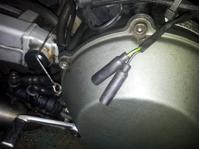

  10. Some Pics
    Neutral_switch_cables[1].jpg Neutral_switch_overview[1].jpg Neutral_switch_plug[1].jpg
    Some pics just in case it changes anything
    Forever hopeful
    :biggrin:
