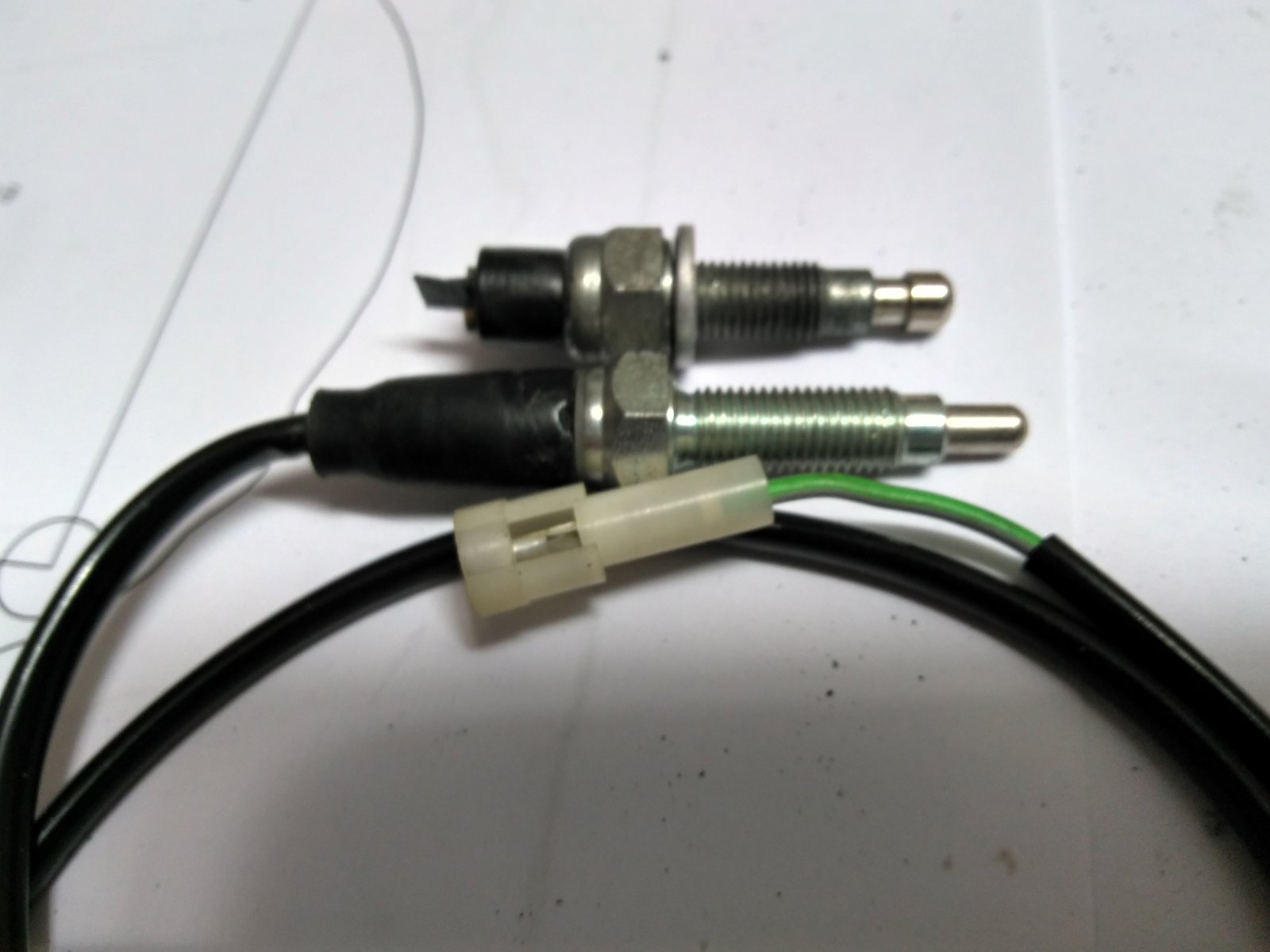

    Can anyone identify this neutral switch.
    I bought it not really checking my existing one which the wires had snapped off.
    I have just been sorting through my parts and noticed the difference in length and it only has one wire. My bike is a 92 900ss.
    Cheers Gaz
  2. It's from a later engine with a 3-phase alternator. They have different crankcases and the neutral switch earths through the crankcases. Your's is the shorter switch with 2 wires.
  3. Thanks a lot Derek.

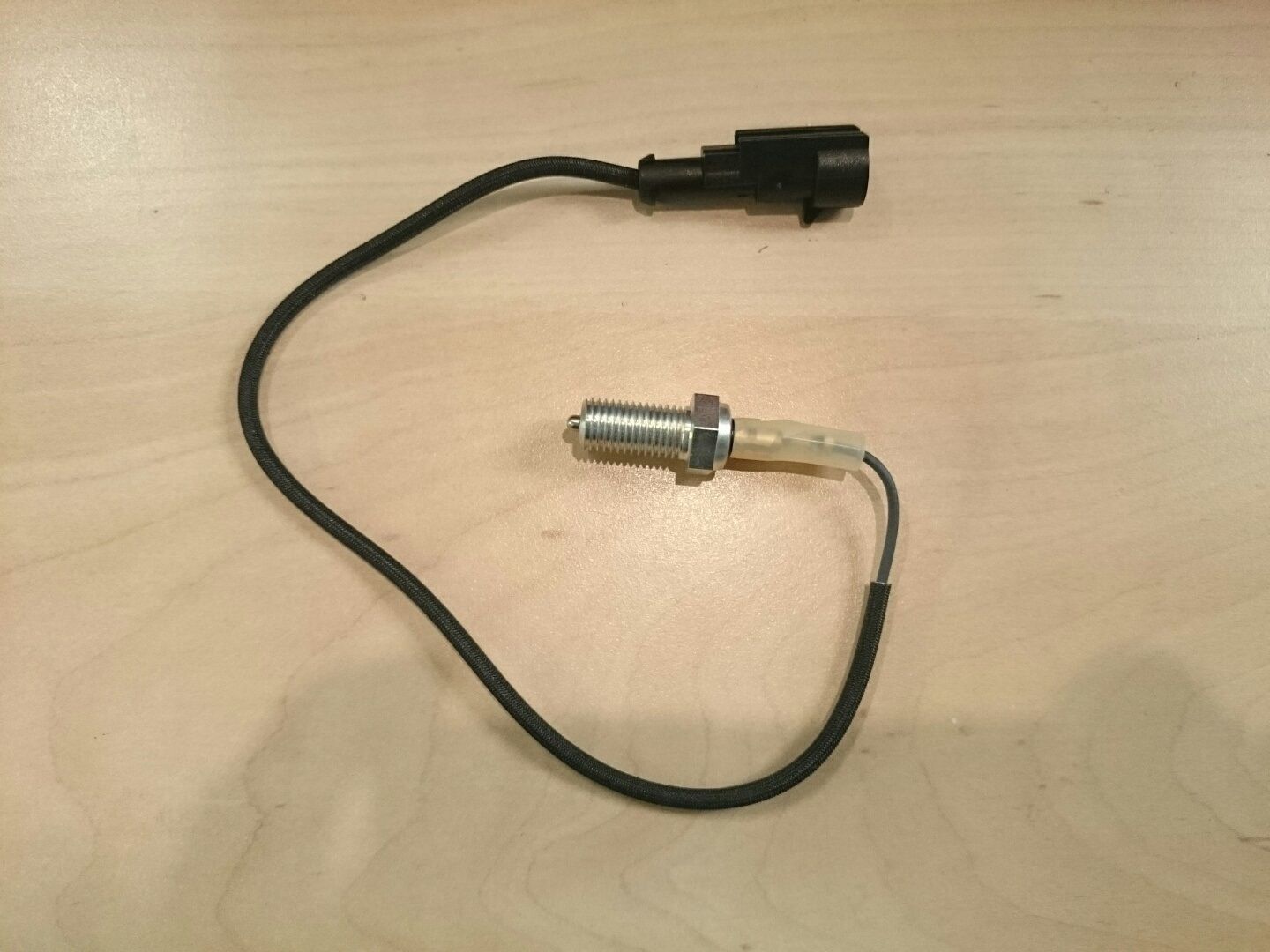

    Thank for your comprehensive reply, but I am still a bit unsure. I search all over for something that looked like the switch. I have also searched on the part number you posted and I get the picture below.
    It may be the case it does the same job but looks slightly different. I only wanted what bike it was on so I could re-list it on ebay so please don't go to any more trouble.
    Cheers Gaz
    #11 gaz92, Mar 19, 2018
  12. Could be a similar switch but for a different manufacturer as the connector is very much different to the Ducati one.
  13. Yes, had not thought of that.
    Cheers Gaz
