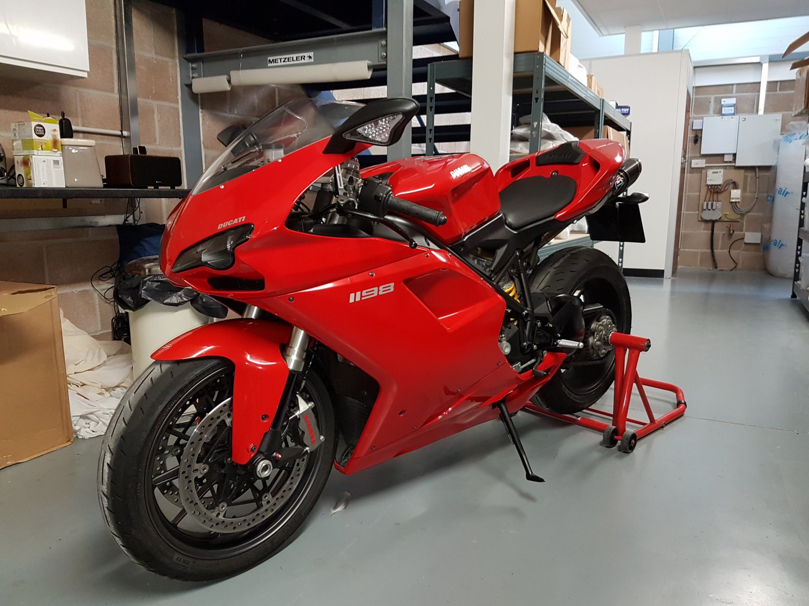

Hi everyone. So afer an R1 and a harley 48 i have gone back to a Ducati and bought an 1198. Rode it today hard with a mate on his 2006 R1 and loved it. I do have a small issue with it and a question re the TC system. The first thing is the faulty dash which has a flashing backlight illumination and the headlight flashes on and off at the same time. Gonna change the voltage regulator on Tuesday and move it to the right hand side of the bike and mount it to the belt covers with a kit i bought from the bay. I will update this later and confirm if the fault is cured. Dealer told me it would prob need a new dash for 860 quid and cant look at it for 3 weeks. Nice. The question re the TC is i was on grass earlier today and gave it some in first gear expecting the TC to do something as the back wheel lit up but nowt happened. Also when leavig the house on a cold tyre going up hill and turning right all at the same time got a bit of a slide. Couple of inches of tyre movement nothing more and bike not really lent over much. Is this normal? No dash faults obv re TC. Any thoughts from experienced owners of one of these would be great. Ta Paul.

Thanks for all your thoughts, when I was on the grass I must have been doing about 5 mph then opened it up in first just to try and get spin. The burnout feature is obviously why it didn't cut in. When leaving the 'T' junction in first, turning right up hill it was the white line in the middle of the road where i experienced a little wheel slip but again the speed cant be more than 10-15mph so I guess too slow for the traction to cut in? I was riding hard on Sunday and never experienced any TC intervention but then I was progressive on the throttle (like bootsam) and it was a warm day with good tyres so wouldn't expect any need for TC I suppose. Really wet days and track days is when it will get tested I guess. I am gonna fit the USB thing as that will show if TC comes in at all, and will check on a day when giving it the beans just out of curiosity. The Voltage Regulator and bracket and loom turned up today so keen to fix the dash/headlight issue more than anything else. Will update.

Well as an update on all of this, the speed when over the white line was 6-8 mph (checked last night) so again no TC at that speed. The Voltage regulator has fixed the dash/headlight issue but I could not relocate the VR with the mounting kit supplied as the VR hit the switch in the oil line just before the oil cooler and the bolts were too long so would not tighten up without damaging the aluminium engine casing. Anyway all good now.
