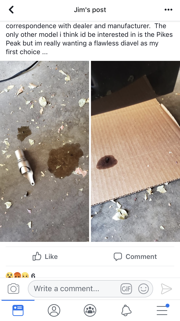

Hi I have a new diavel and have recently noticed some oil bieng dropped on the floor from the oil breather pipe under the bellypan does anyone elses do this ? Also bike was serviced at 630 miles just over a 1 week ago and its now done 1800 as I've been on a tour around Wales and I've just checked the oil and there is none in the sight glass - I've had to lean the bike over 20 degrees to get oil up the sight glass - how is everyone's oil consumption going?

So a 140 mile round trip today bike going into dealer tommorow for run in service. Just checked the bike and a nice little pool of oil and grit under the bike about 1p in size. With the oil breather pipe dripping. Will see what they say tommorow

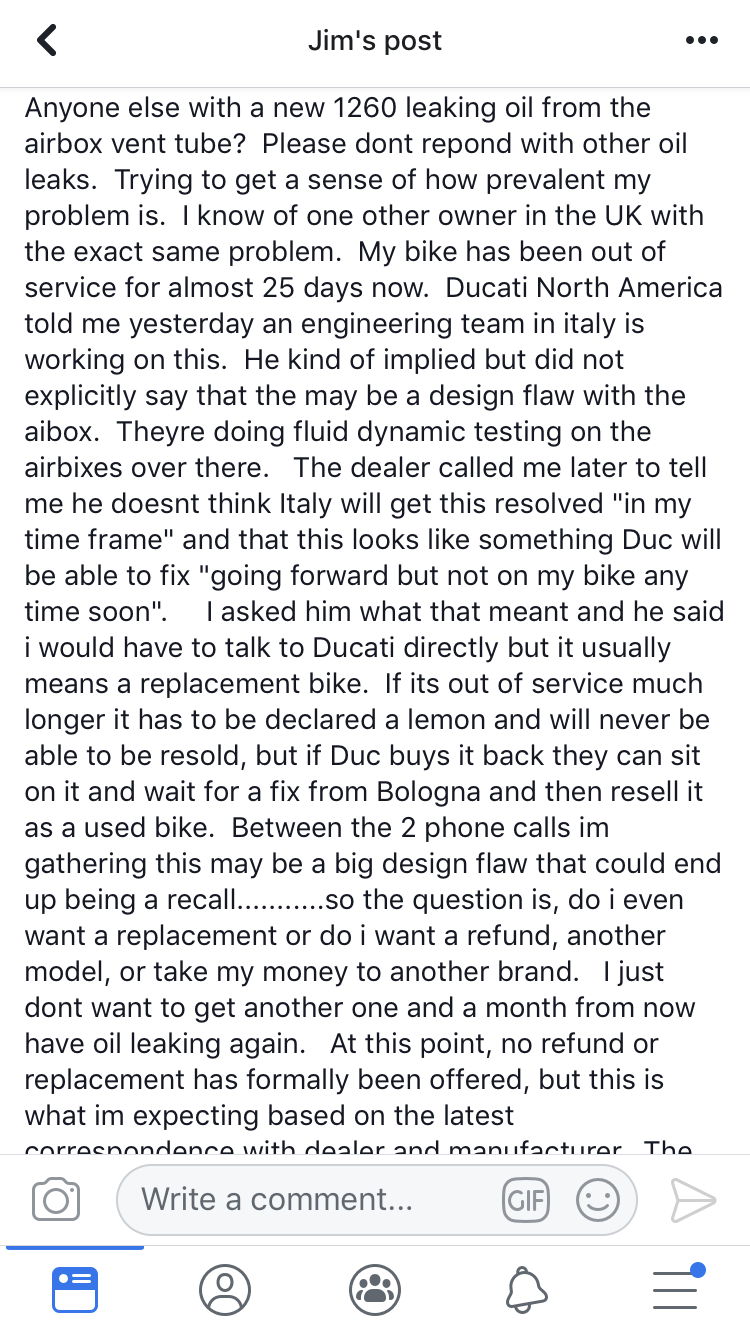

UPDATE Me and another Diavel s owner have been having this issue and the other guy in US is having new pistons cylinders etc delivered so the engine is getting rebuilt - I'm getting a refund until they sort the problems out
Thanks I really hope it doesnt come to this as there is no other bike I would like or can fit on do hope its a simple case of new airbox design

Ive now done 2,000 miles on the 1260S and twice found oil on the garage floor under the breather tube. There doesnt seem to be any common denominator. Once after a gentle sunday ride and another time after a 10 mile commute. Otherwise its been flawless covering 5 hours on motorways and even longer on A-roads over a single weekend without losing anything. I'm keeping an eye but not losing any sleep over it. But then again I have a Harley as well so oil drips are par-for-the-course!
How much are you getting in my case after each ride there is about 3-4mm overnight so not a lot. Still worrying as the airbox must be a mess
