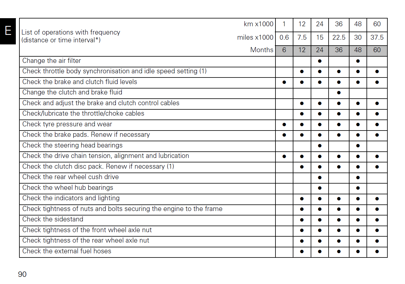

    The bike is on 13600 miles i have no service records that mention the timing belts being done, though the seller said they were done at 8000 miles, what are the intervals, is this something you can do yourself ? or how much would it cost at a Ducati delership to have done, the bike is due an MOT in October so i could get it done at the same time if its not extortionate

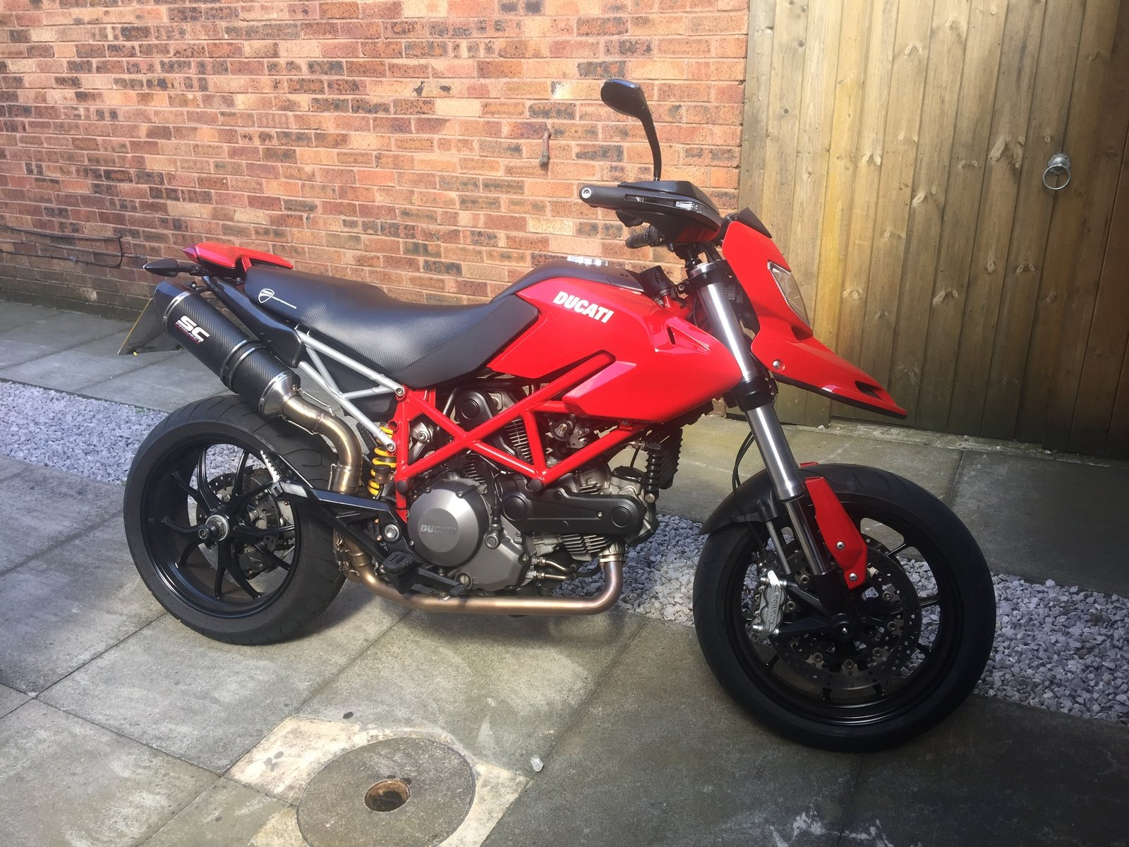

    Is the SC 2 into 1 exhaust system and evotech tail tidy the best option for tidying up the back end, i prefer the look of the single sided high level exhaust, i've been reading smudgers posts about this with interest, i just wondered if there are better options ?

  2. Evotech is not a straight fit... it wil need drilling and some kind of 'boss' to go between it and the subframe otherwise the reg plate is bang in line with the exhaust gases
  3. Get the belts done, not worth risking it..

    The timing belts are to be done either every 15000 Miles or 2 years depending on which comes first.

  6. Smudger would you be kind enough to post up or send over a few picks of your bike with the exhaust and tail tidy fitted please :upyeah:
  7. I'll get a close up of the tailtidy mounting

  9. I've highlighted the alloy boss I used plus the zip ties that stop it pivoting on the single mounting bolt.
