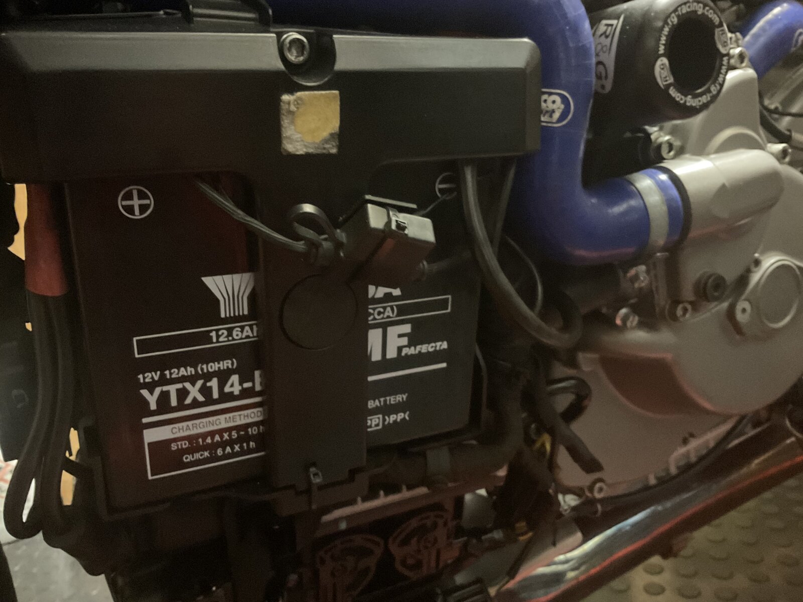

  2. The YTX14H is a larger battery physically but, good news, the 1098 has a slide out tray in the battery box that allows the bigger battery to fit - almost like Ducati originally intended it to have that!
    (I have one in mine, works great)

    I do just need to check that the YTX14 you quote is exactly what I have.
    Will take a look in a few mins.
  5. Please do so I don't get the wrong one ;)
    And merry Christmas to you.
  6. YTX14BS
    Merry Christmas!
  7. Thank you sir. I will go with the Bs then :)
  8. You should check battery will fit. The oem battery is a yt12-bs. It has a depth of
    Before you order a YTX14-bs I’d check the actual battery you have. The oem battery in my bike is a yt12-bs which has dimensions 150x130x69mm. The YTX14-bs has dimensions 150x150x87mm. The problem is the depth of 87mm which means it won’t fit in the battery compartment. I think at some point Ducati changed the battery compartment in the later 1098 to allow the bigger battery to fit so you might be lucky.

    Mine is a 2008 1098R and it fits just fine.
  10. I'll take measurements of the box before order. Thanks for the heads-up. Mine is a 07 1098s
