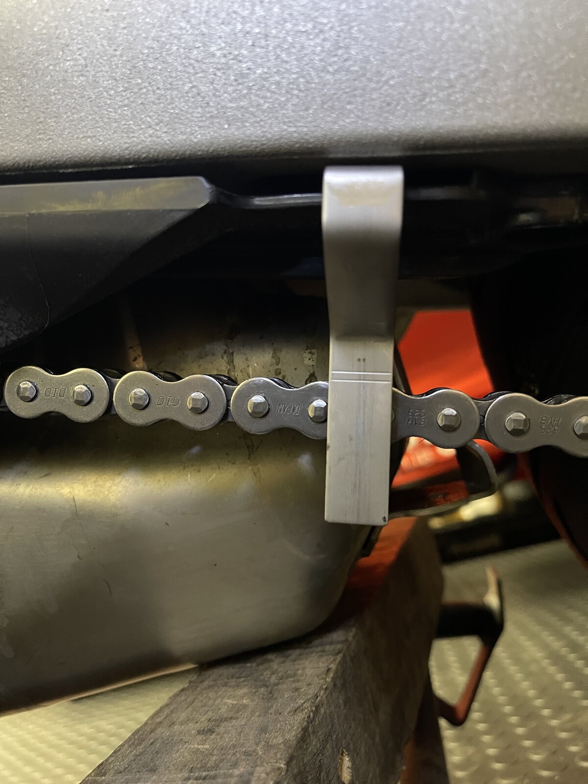

  1. Quite surprised how slack the chain is on a brand new bike with only 90 'steady' miles on it, quite a way out of tolerance. Have ordered a socket as I don't want to do the full 600 miles run in with a chain this slack. It's so slack it can hit the underneath of the swing arm.
  2. I might be teaching you to suck eggs but you need to rotate the rear wheel until you find the tightest point caused by the out of roundness of the front and rear sprockets, which is normal. That is where you check the chain tension with the bike on the side stand and if you have the S, with the rider mode in (I believe) Urban. Andy

  6. Thanks for the responses but this is so slack equally, both top and bottom it in my opinion is an assembly/PDI error.
  7. Blimey do you still get tools with an S, bugger all with a PP, one Allen key
  8. That picture looks like it's on a stand/jack ?
  9. On the side stand with a block of wood holding the main stand lower down so I could take the photo.

  14. The chain tension should never be set on the centre stand. It’ll be way too tight when in use.
  15. Surely this is normal given its a new chain, it'll stretch a bit the first few hundred miles. As others have said, find tight point and tension it.
