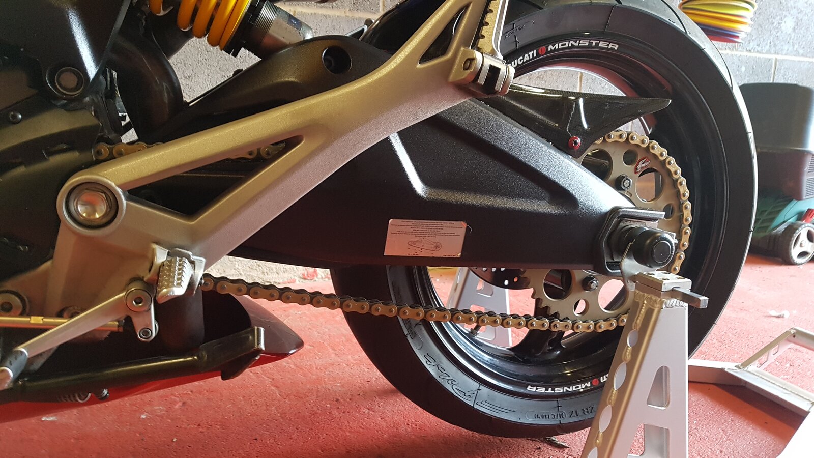

  1. Now do i replace the chain myself or send it to a garage ? If i can find a motorcycle garage thats open that is,the chain is very slack and its on max extension and had an advisory on last mot,so can anyone point me in the direction of size and pitch of chain needed I'll need a chain breaker tool too, my bike is a 13plate monster 696. All help and advice is most appreciated Thanks.

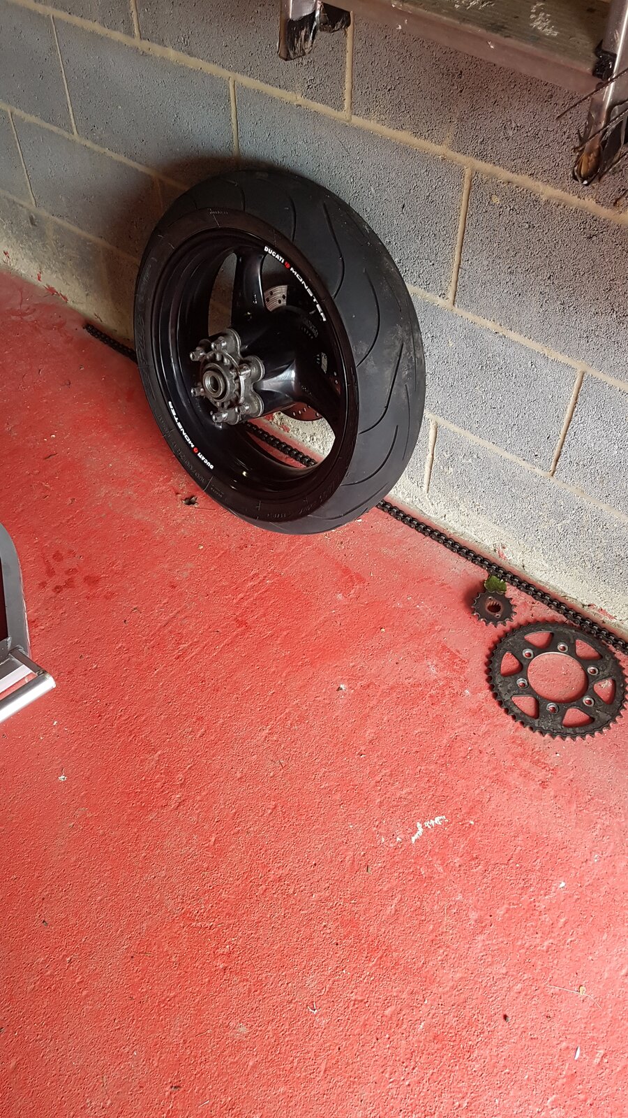

    Chain and sprockets removed awaiting new ones.

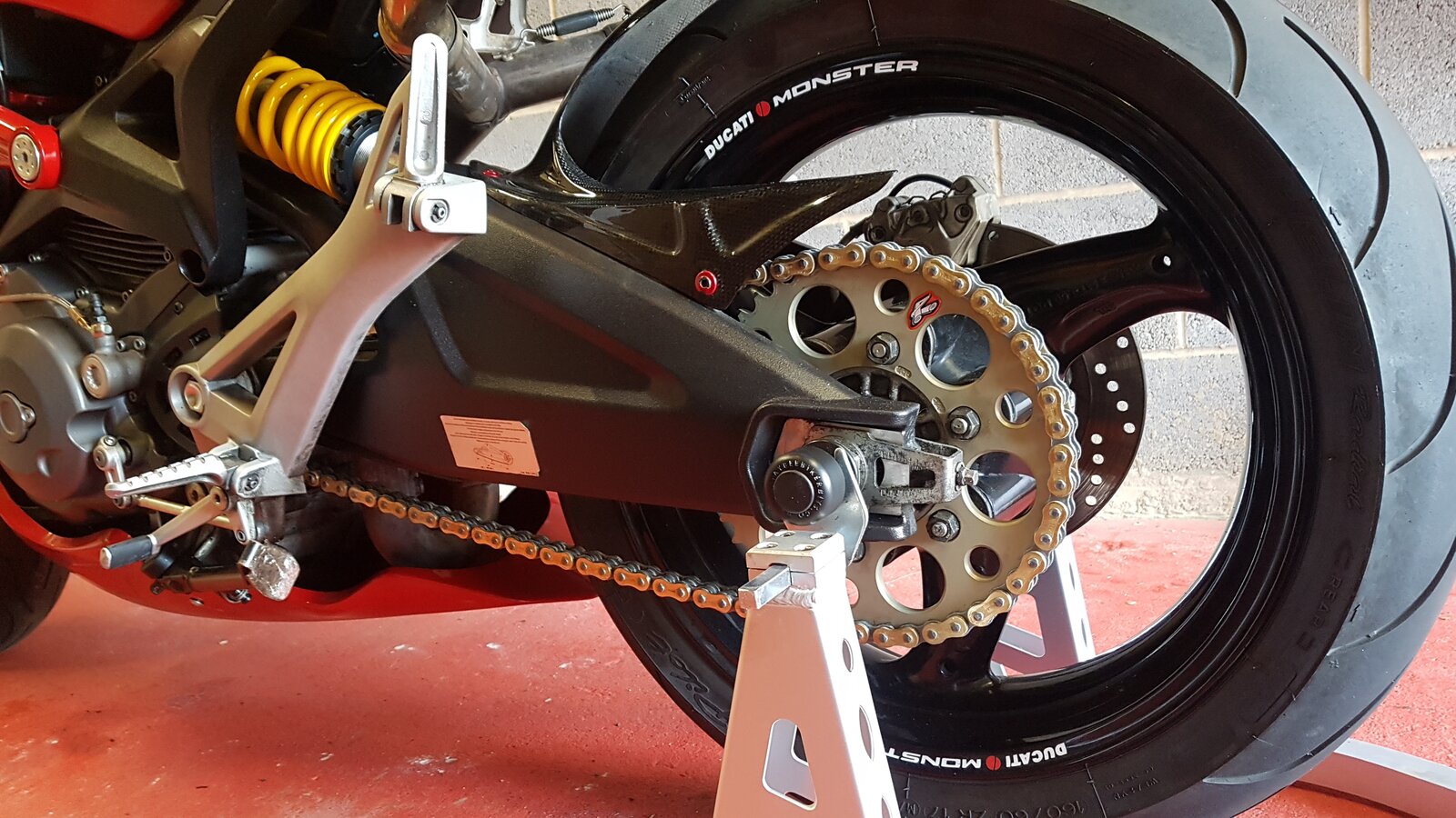

    Fitted and ready to go.
  14. No dramas what so ever.
  15. You have done the chain with weight on the back wheel & someone sat on it? Ignore me I'm sure you've done it fine.
  16. I'd be interested to know how you flared the rivets over on the chain, the Renthal chain needs a quad stake riveter which are quite expensive as I found out myself, I used the old method with a ball pain hammer and a lump hammer behind being very careful not to pinch it too tight, my normal riveter wouldn't touch it.
