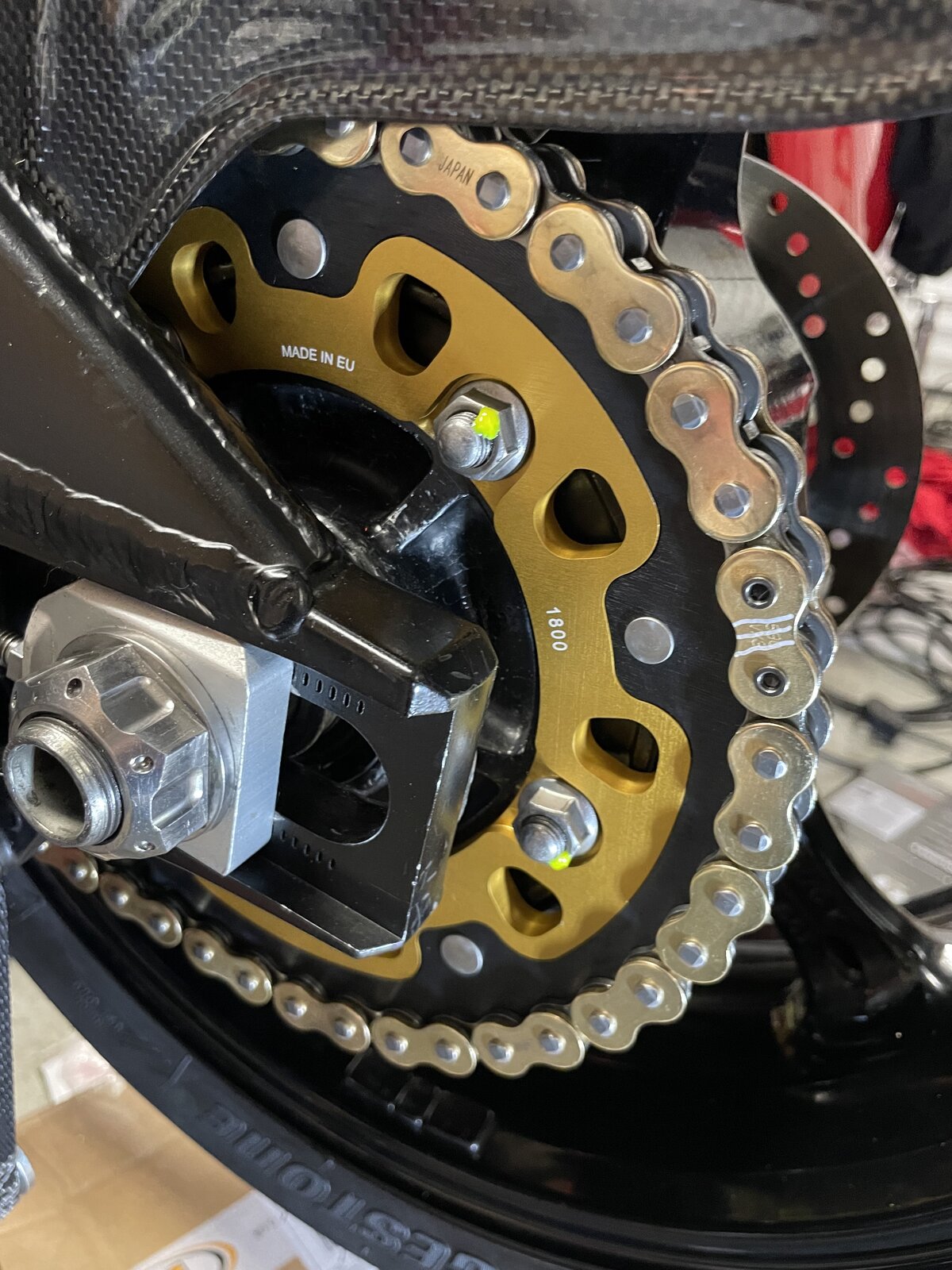

    Useful to know, and that seems to be what all users say, maybe the trade are just unsure having not actually sold or used them personally :thinkingface:? However, it is a significant €150 price uplift for the Regina HPE over say a gold DID, but I’m likely to veer towards spending the extra.

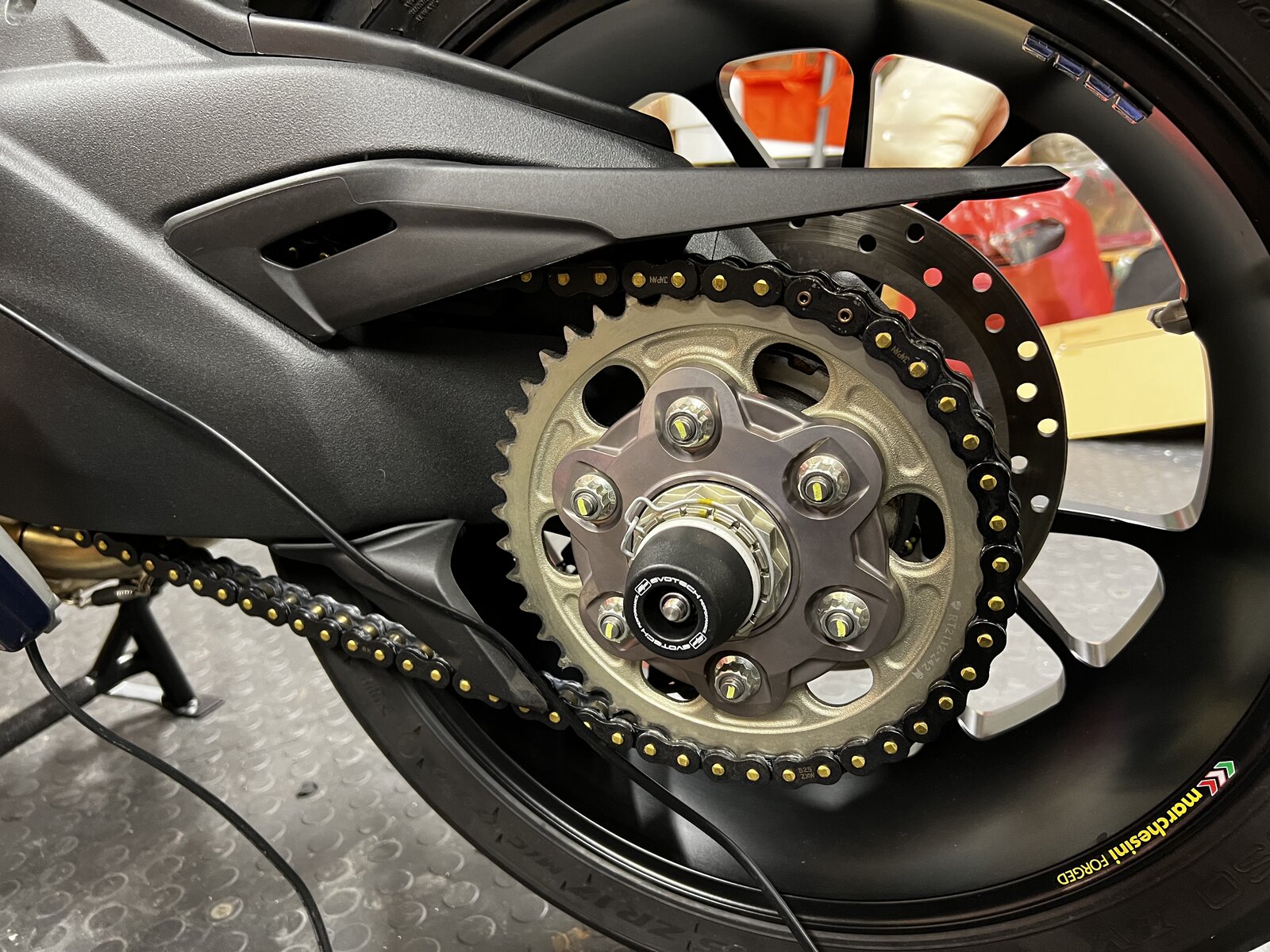

  9. I like my black chain.
  11. Looks good - what did you change

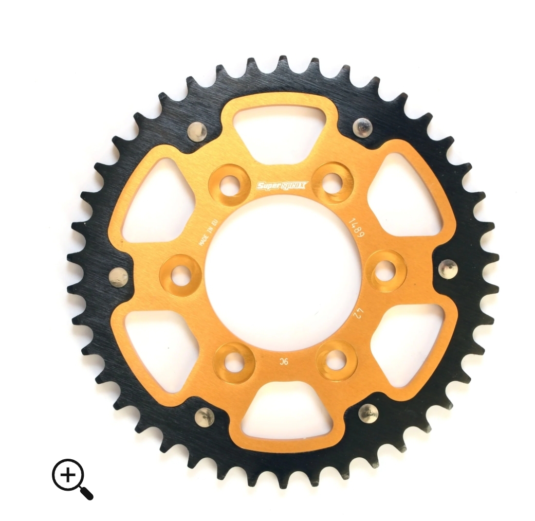

  12. How about Supersprox sprockets. I have these, front and back, on my KTM 1290.
    I am sure they make them for various Ducatis -

  14. I’ve not fitted it yet (bought it about 8 weeks ago - but not used the bike much recently). Had to go OEM for the sprockets as I couldn’t find any 3rd party who made a front sprocket with rubber cushioning or a steel rear sprocket - lots of alloy ones out there. Chain is DID gold & gold ZVM heavy duty 525 x 124 links.
    At the time of purchase JT still didn’t have an option available.
    When I say I couldn’t find a 3rd party who makes the right parts, clearly there’s someone out there as Ducati don’t make them but I couldn’t find a vendor of same spec ones.
    Thus, I’ll be living with a black rear sprocket again.
    NB @gc6269 has a single side swing arm, there’s much more in the way of blingy options for those.
