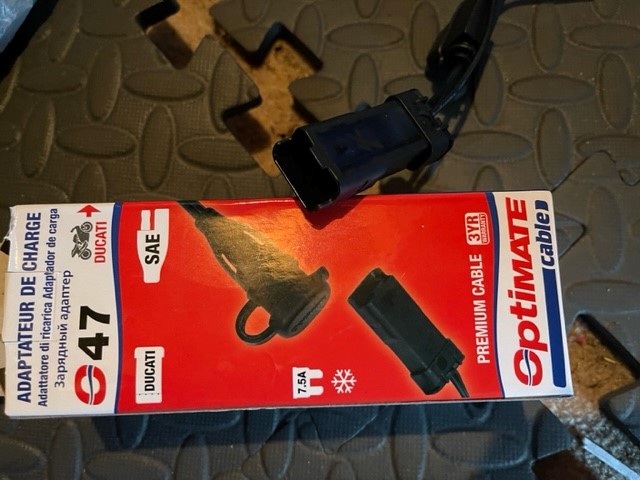

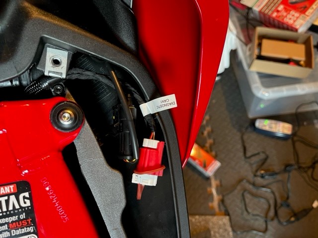

    New v4s 2022 unable to connect Optimate Lithium 0.8 charger with O47 Ducati Lead, under seat connection.
    Does it connect to the Diagnostic Can1 connection or the other lead along side which is a back lead?
    The red plug Diagnostic CAN1 connection look like a square connection but the 047 lead is more rectangle connection.. Or do i have the wrong fitment
    Thanks

  2. You need the Euro 5 Optimate cable. You have the Euro4 version which won't fit. This is what you need. Ignore the fact it says MV Agusta on the side of the box, it will work on any 2021 > Ducati model with the red six pin CAN bus diagnostic connector. Incidentally, the other lead in your picture is the power supply to the rear light.
