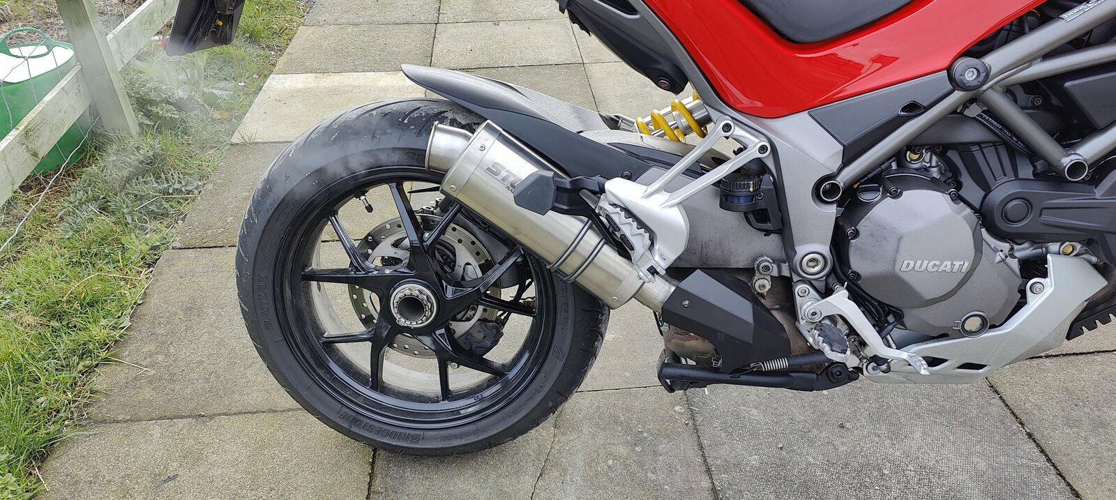

  1. Fitted this from Storm.
    Have to say I'm really impressed.
    Lighter than the original and better looking (in my opinion)
    Doesn't really sound much louder at all, so perfect.
