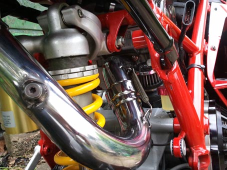

  1. I posted a few weeks ago asking if anyone had used one of these eBay - The UK's Online Marketplace . No one had one so I bought one anyway and here it is . Much better quality than the picture in Ebay Im impressed with the build. Heres a few pictures of the filter before fitting . I will in the future let you know how good it is.

  6. If the filter were longer than standard and a higher flow that would indicate a larger filtering surface area which would be good but it looks like about the same size...not so good

    Apart from that look at the picture its over 30mm further out of the casings than the standard filter. Which makes it bigger.
