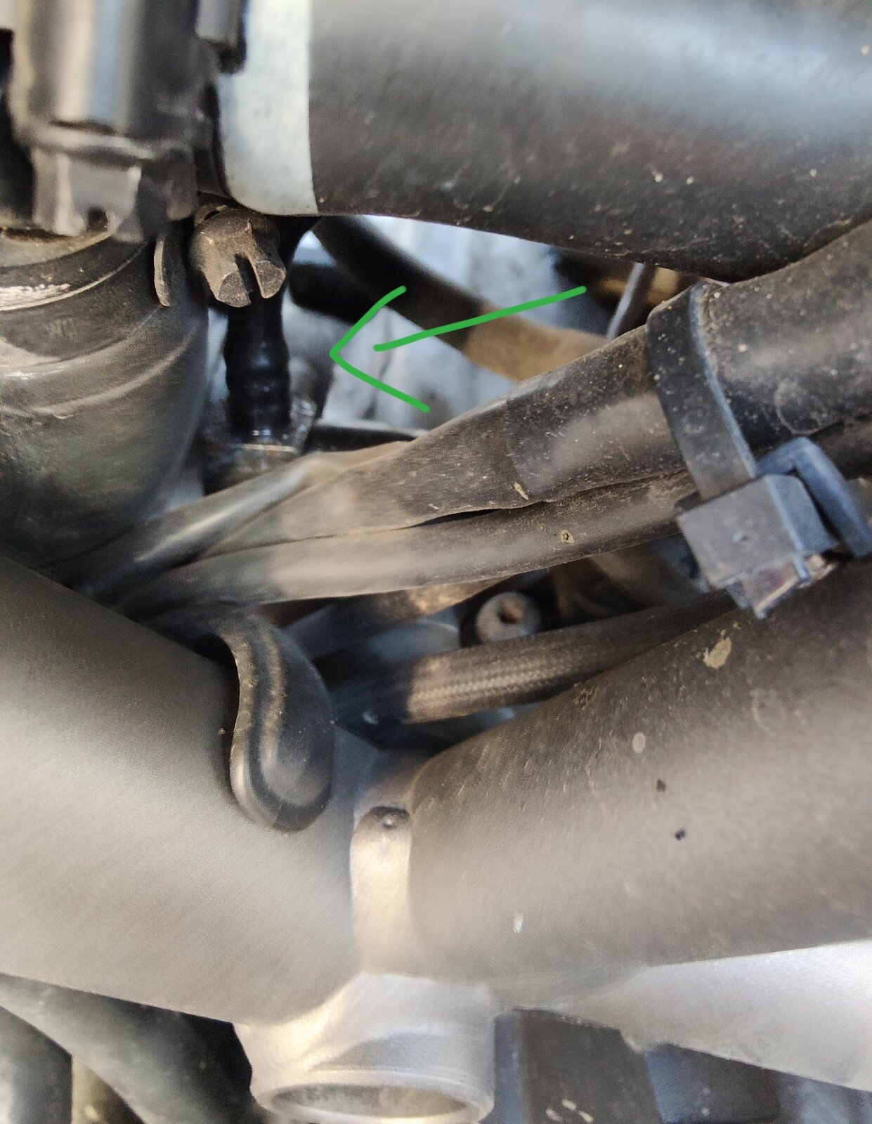

  1. Went to get the bike yesterday to find out it was leaking petrol.

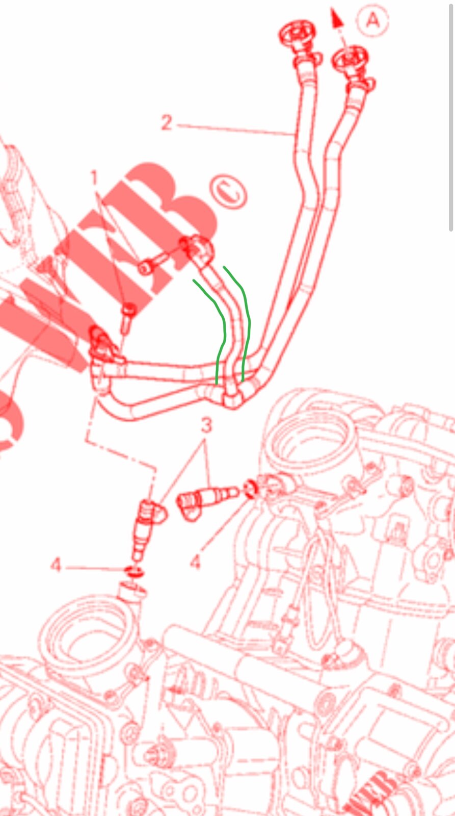

    It seems to be coming from the little pipe that I have marked in green.
    Ducati obviously doesn't sell only that pipe but the whole set which costs 280£.
    I'm thinking to buy some quality fuel pipe and fuel specific sealant and replace the pipe myself.
    Had anyone done something similar before?
    Any advices or ideas?
    Thank you. IMG_20230910_104644.jpg Screenshot_2023-09-10-10-52-36-76_99c04817c0de5652397fc8b56c3b3817.jpg
  2. Have you tried finding some second hand ones perhaps?
  3. #3 Mike 999, Sep 10, 2023
  4. If it’s the hose that has failed then just replace it with some new equivalent size fuel hose but if it leaking from the fittings then they look a bit more Ducati specific.
  5. I think it must be the pipe because you can see petrol from the middle to the bottom part, while the top is totally dry.
  6. Yeah just change the pipe then and it will be fine. :upyeah:
