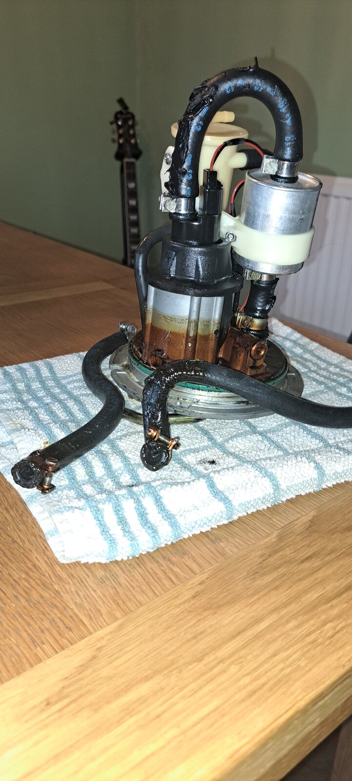

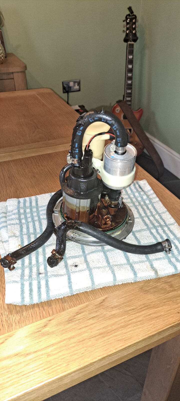

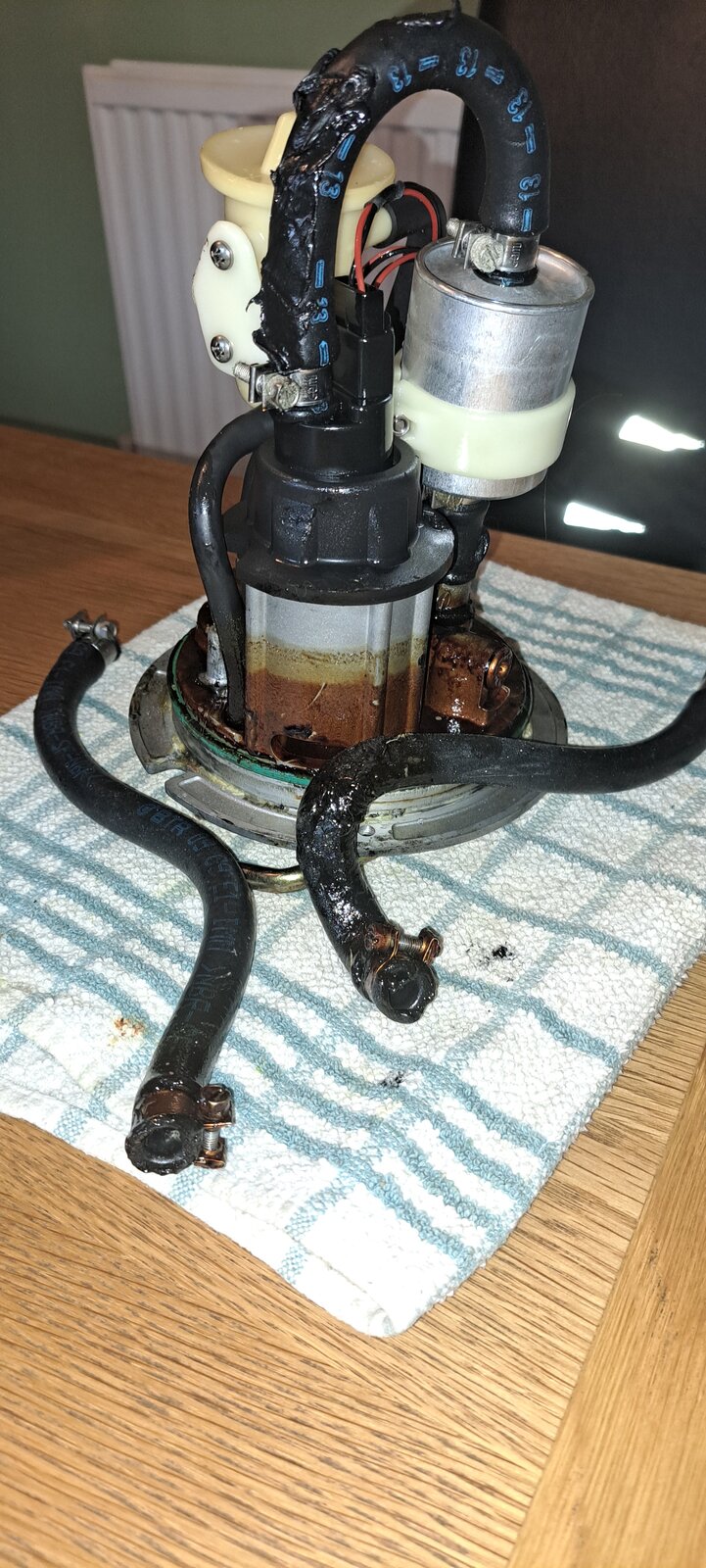

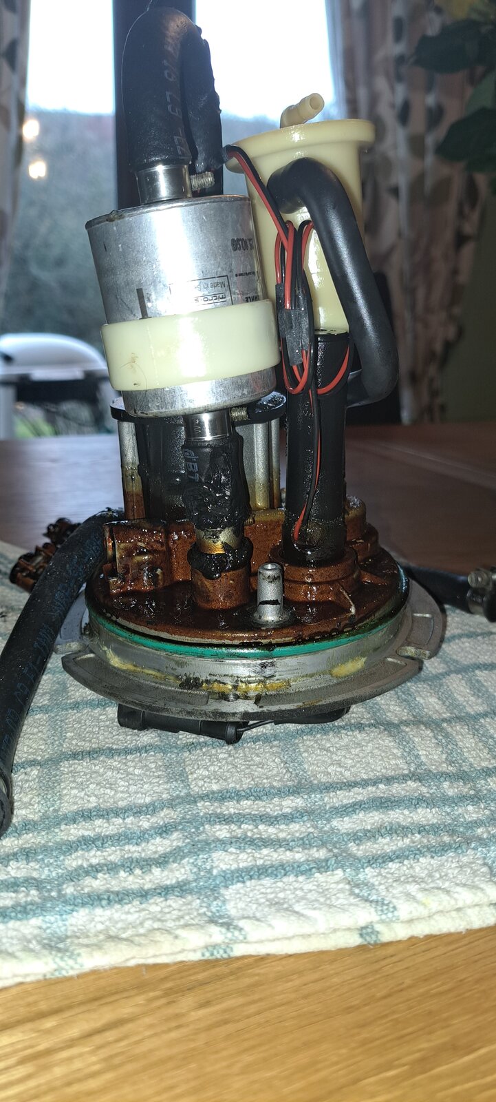

  5. Just taken the pump out. I can't see much wrong with it 20230405_172204.jpg 20230405_172152.jpg
  6. looking at the typical residue it could just be "gummed" but not worth the risk (for me) even if you get it working as a lot of work if it fails in a year. Do you have a source for submersible fuel hose? Pirtek outlets have it for one, but check out Ducati prices obviously - they might be cheaper than in the past.
  7. Thanks Chris, I will check out Pirtek. I will be honest I cant see the pump working again. I put my hand in the tank and it is caked up with a white crust. No rust spotted as yet. I am looking at ways of cleaning it out on yutube.
  8. You could try having it ultrasonically cleaned and if nothing else the pump baseplate might come up a lot cleaner. Do you know if the fuel level sender unit is OK?. You probably might need a new fuel filter just as a matter of course.

  12. I had similar with my 916. I took pump unit off. Plugged it into 12v supply, tapped it on my vice. It spat out some black mush, then spun freely. Until then it was not working and looked dead. All my black hoeses were like yours. I replaced all of them and now its all fine.
  13. Thanks @bootsam I will give it a go.
  14. The pipes dissolve a black goo into everything. It clogs up all the filters. Replace them all as a matter of course. Theyre pretty cheap. All that goo had got into the pump and seized it. A simple tap against my vice was all it took to help dislodge it all. Dont spin pump without any pressure too much tho as pumps dont like working without any head for too long.

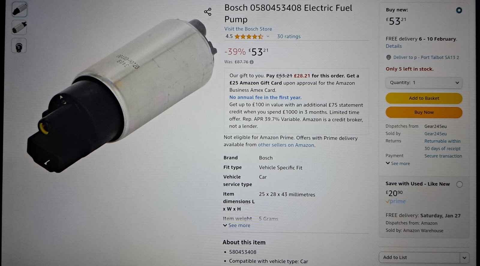

  15. Ok just ordered a Bosch fuel pump off good old Amazon for £59.58 free next day delivery with Prime. They are almost double that on Ebay.

  19. This is the pump I ordered. I have even seen some cheaper but not sure if they were Bosch. The only difference is the end of the pump has a different looking end cap that takes the petrol in. Honestly it hasn't made any difference. If you need details of the other bits I sourced, let me know.
