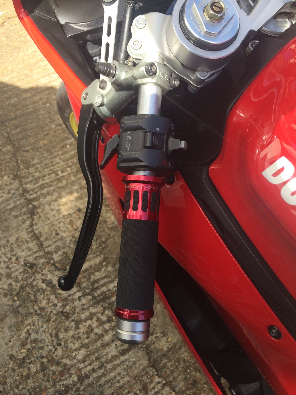

  8. Had to trim the bar end with a razor blade to dit these.
    Great grip - much more comfortable.
