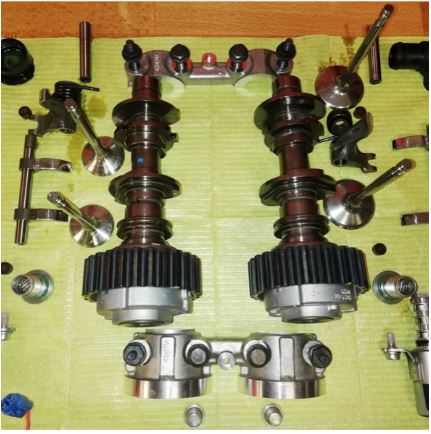

    Here is one picture during the repair...
