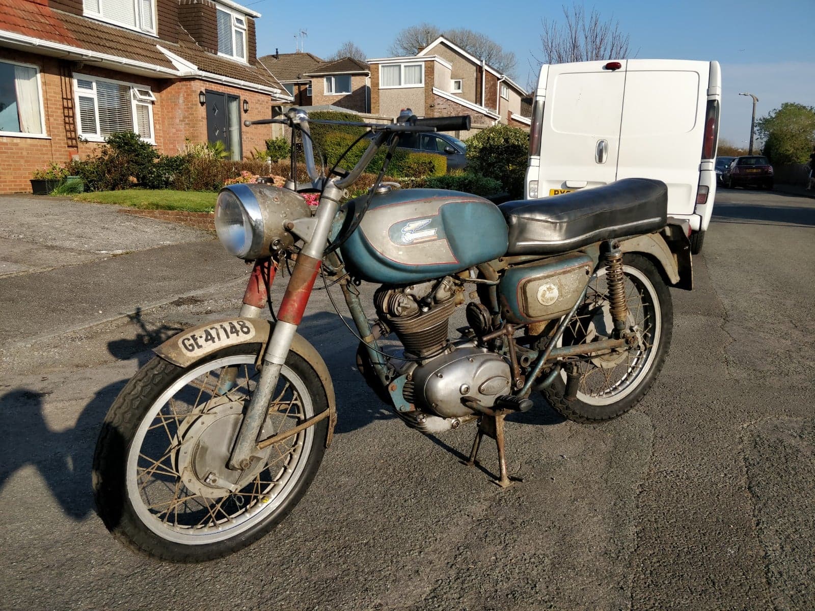

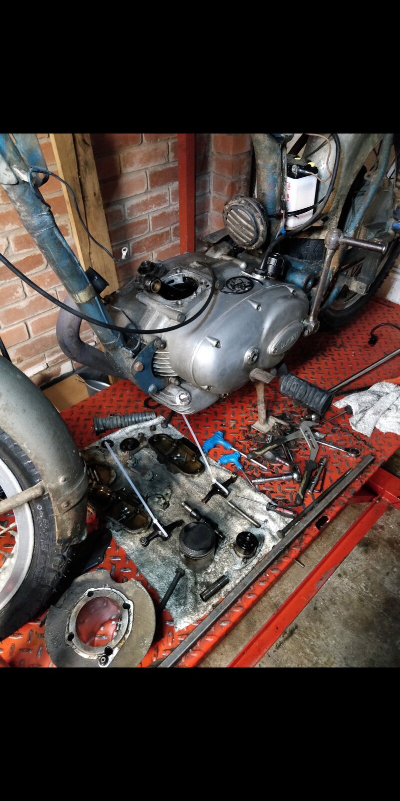

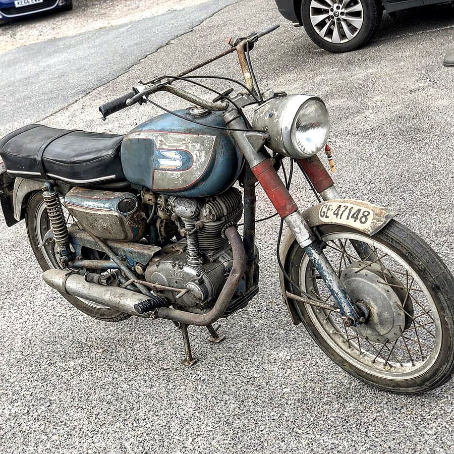

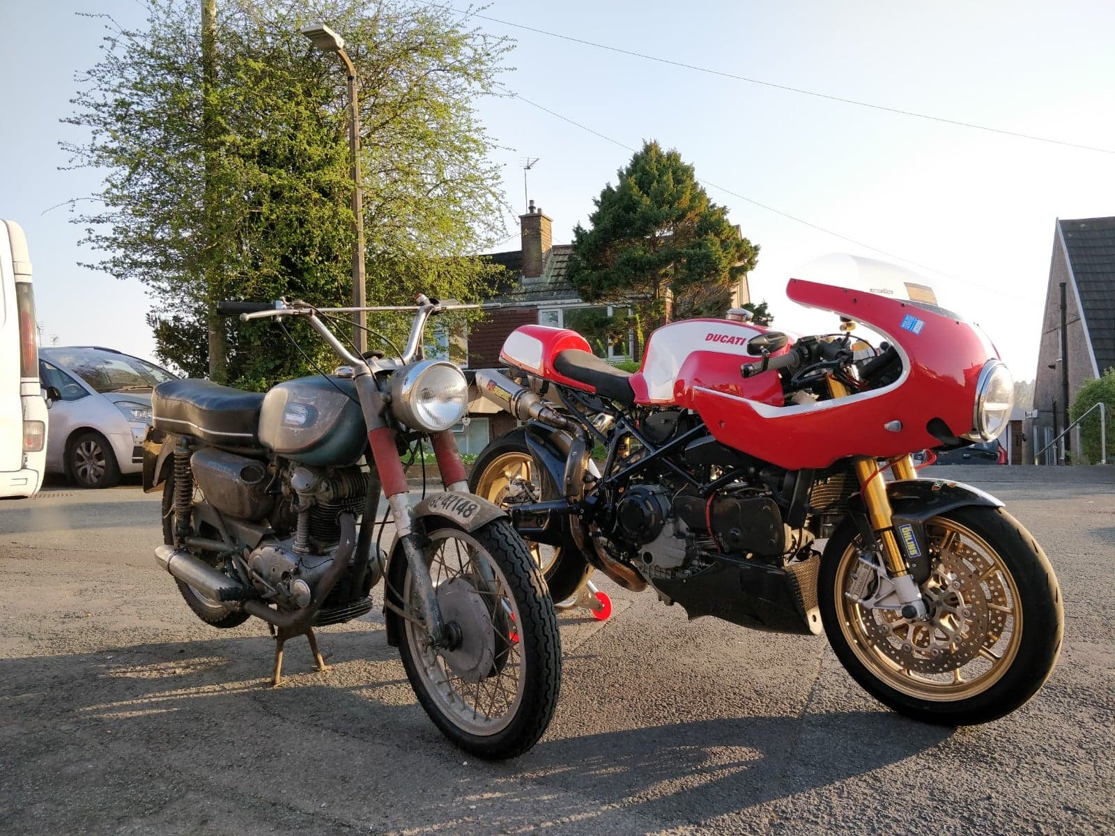

  1. My '999 to sport classic' project is never ending, but I'm at a stage where I'm fairly happy with it. Wanted something older for a while and picked this up recently.
    Let's see how I get on with it!

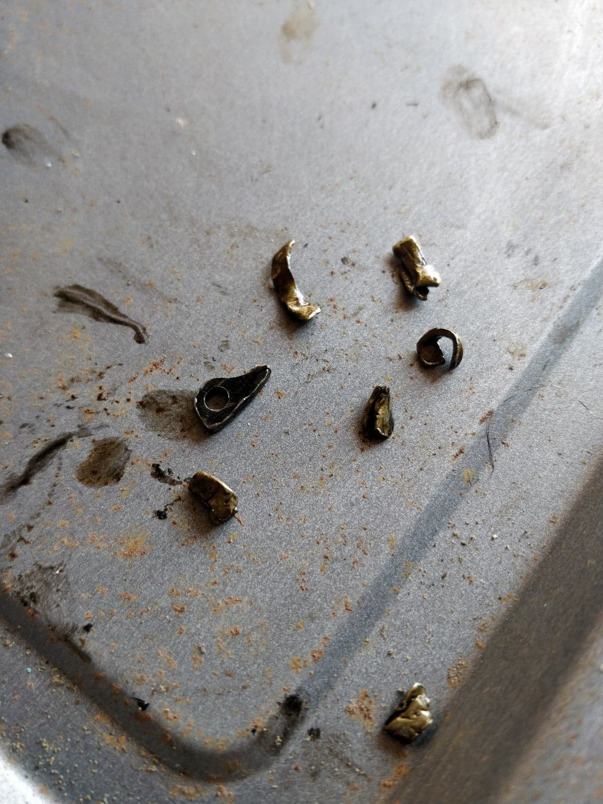

    Top end is currently off as more of the exhaust was coming out the breather than the pipe! Cracked rings and scored bore unfortunately, also damage to the cam and rockers.

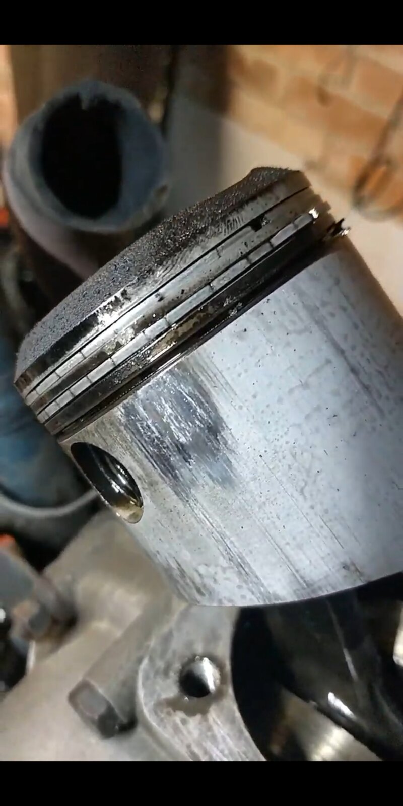

  6. What really really impressed me was that I was riding around at 20mph and the piston ring was in a million pieces, it wants to live! Screenshot_20200103-183047.jpg Screenshot_20200103-183036.jpg

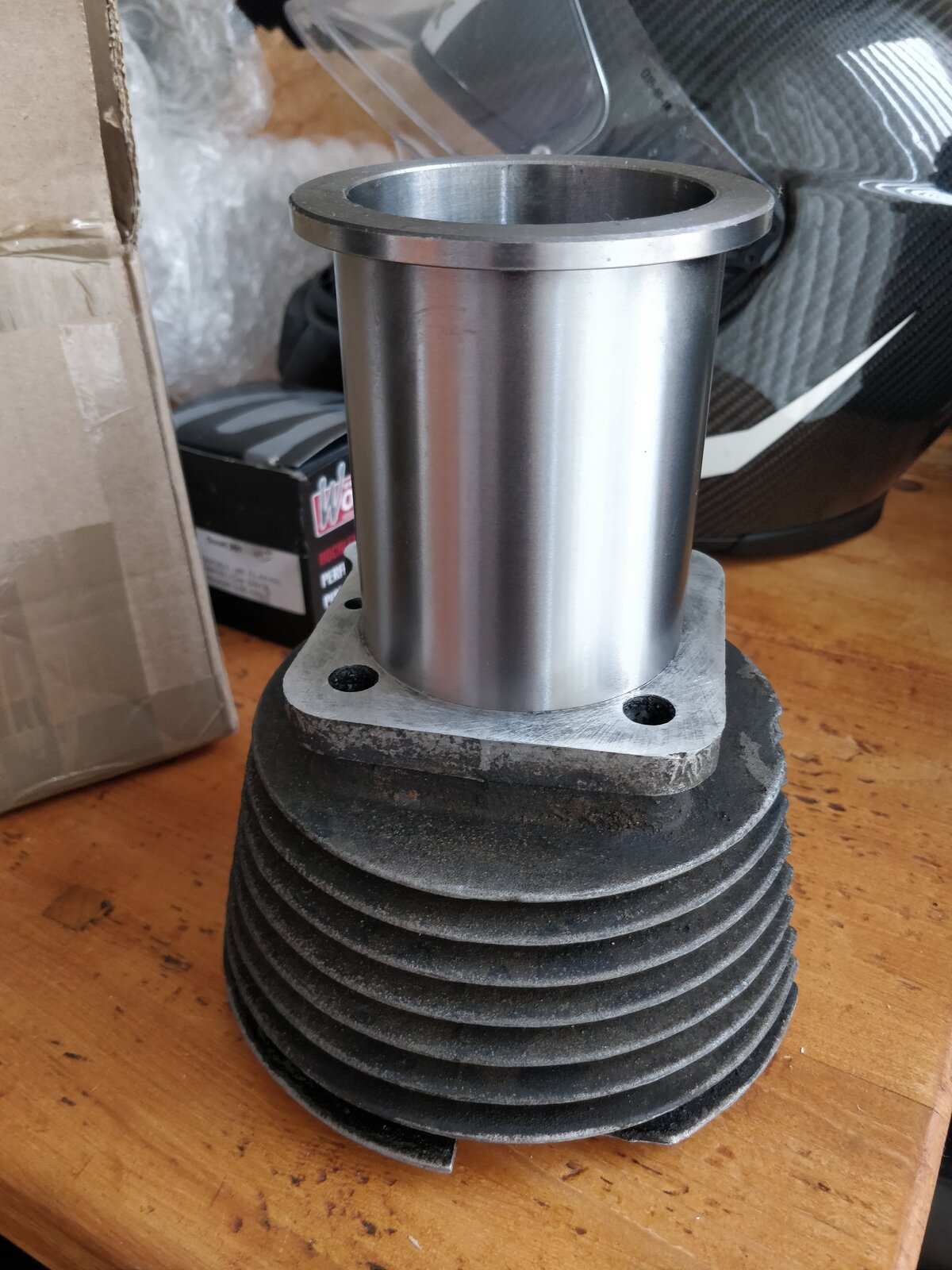

  7. New liner too :) IMG_20191222_121758.jpg Screenshot_20200103-183645.jpg
    Really could of got away with a little overbore as the cylinder wasn't that damaged, so I gave that wossner over size piston to a local machine shop.... They absolutely f**ked it! So I ended up having to get a new liner, wasn't a good day and they had it for 3 weeks!!!

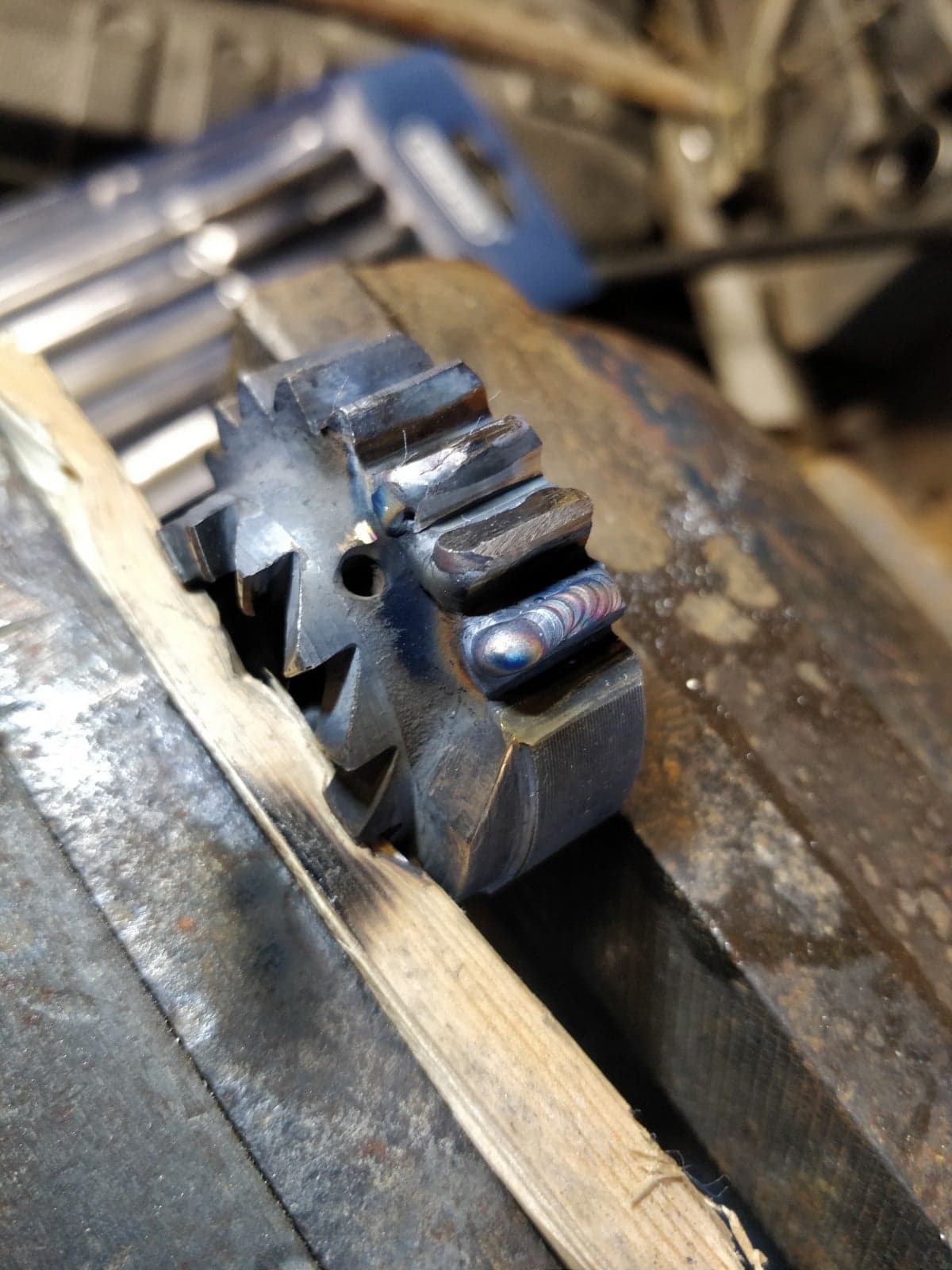

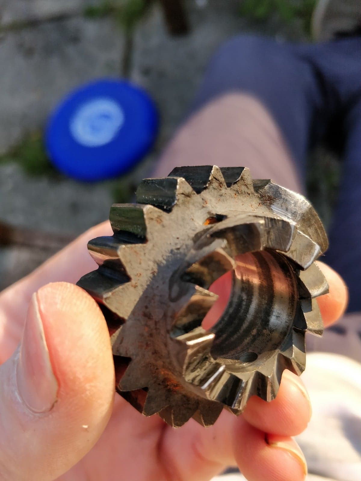

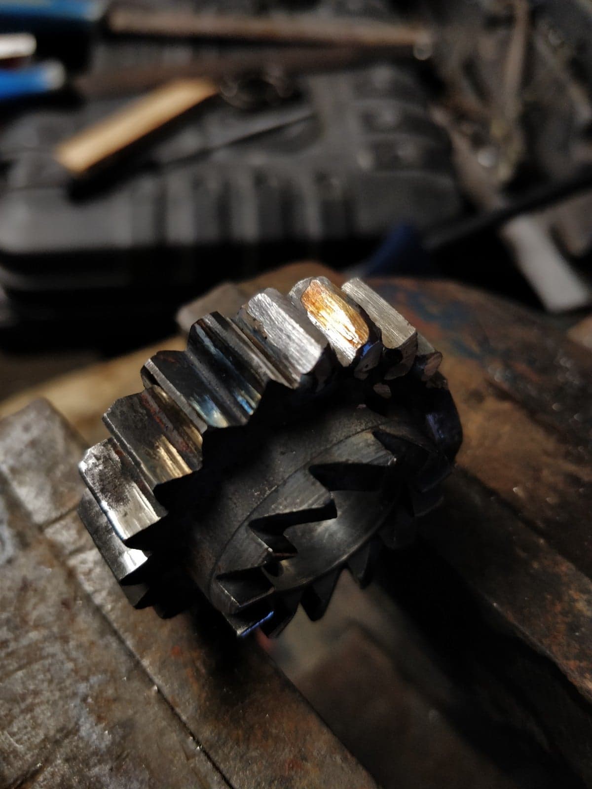

    Barrel and piston back in, Got a bit excited with something to do with all this coronavirus stuff going on and managed to set the cam timing 180' out! Got that sorted out and went to give her a kick and the gear just kept slipping.
    Found some lovely mangled and snapped teeth, had a quick look online and couldn't find anything that wasn't in the states. Decided to do the stupid thing and do a bodge repair to make sure those teeth don't snap and end up where they shouldn't be!
    95632142_230744477990781_912586069709422592_n.jpg 95097013_241311326985568_1297986258412240896_n.jpg
    Plan so far is to only kick it from about 90 degrees down, missing the repaired teeth. Although thankfully I found this in the case!

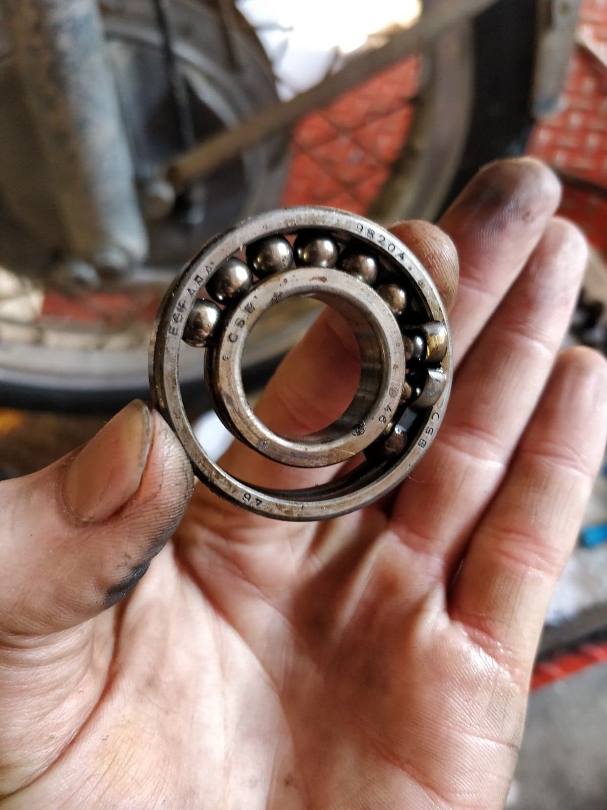

    This is the first time I've played with a single bevel so I had a look in the manual for where a big circlip should live.
    95392778_638489870081810_1429049281393721344_n.jpg 95630577_935515513567887_3976307862535143424_n.jpg
    of course that circlip was a nightmare to get out, ended up having to weld a bolt to different sections of it and snapping bits of it gradually!

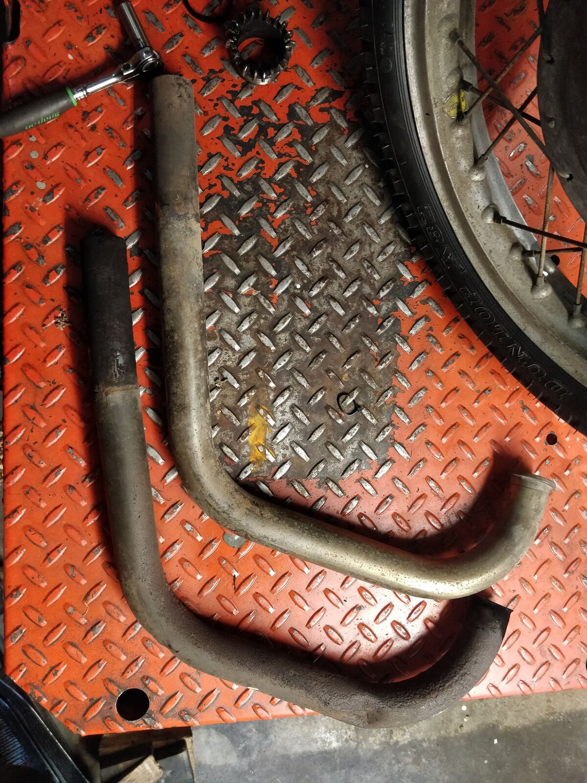

  16. Also found a used exhaust that suits the patina of the bike, mine was knackered and didn't seal in the head, the flange has rusted away. Plus look at the dents! thats at least 1/2 a HP right there!

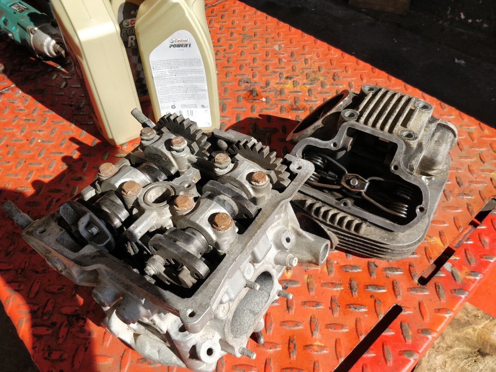

  17. Found this quite interesting too, 55ish years of cylinder head design!

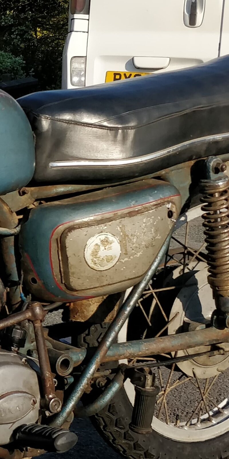

    My little tool boxy bit had a lock on the side which i didn't have the key for, I could hear something rattling inside and it drove me mental thinking about what it could be. I ground of the rivets so I could hopefully reuse the lock and found a used spark plug... not quite the gold bars I was hoping for! Did these come standard with the lock? I've not seen it before? Also, What would that round sticker would have been? So many questions!
    ...and yes, thats a piece of alloy filler keeping it shut! aha
