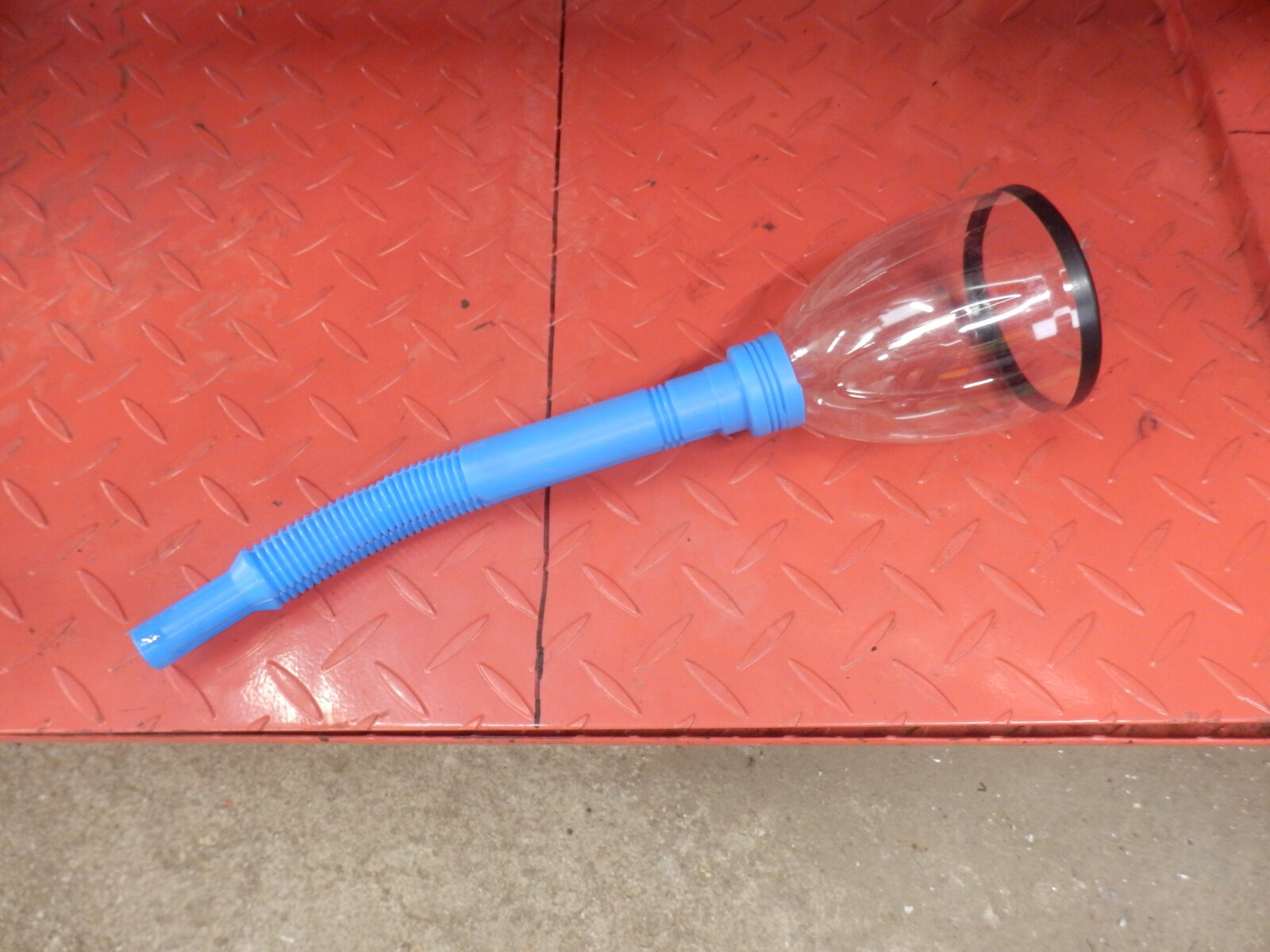

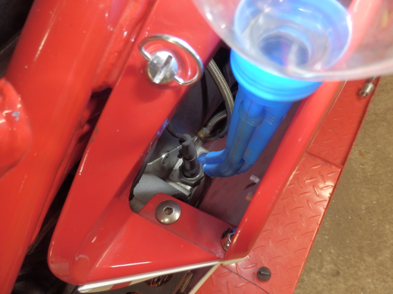

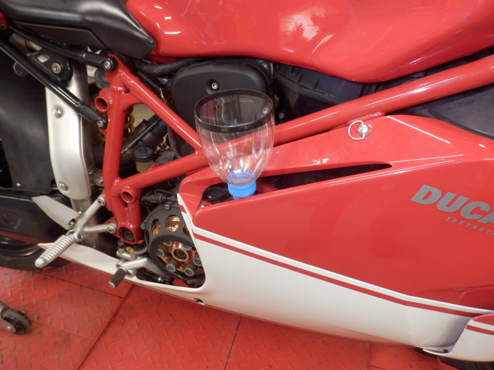

After getting my 999 back together and out for a test ride following having to drop the Oil etc to change the Stator I found myself in the position of needing to top the oil up. Annoyingly time consuming on the 999 and other newer bikes because the fairings need to come off. I have a long neck funnel which I could shove down inside the fairing, but the end of the neck is too big to fit the hole in the case once the cap is out. Coincidentally, the same day I'd been to Halfords for 10l of AdBlue and topped up my Land Rover, putting the container and removeable spout in our recycling bin. Also in the bin was an empty 2l Robinsons Apple and Blackcurrant squash bottle. You've got there before you look at the pictures I expect, the Adblue spout is the perfect diameter and length, and with the sealing washer the top part of the Squash bottle screws in perfectly:

Could be, but I get my hand down behind the fairing to undo the cap and don't have small hands by any stretch of the imagination.
