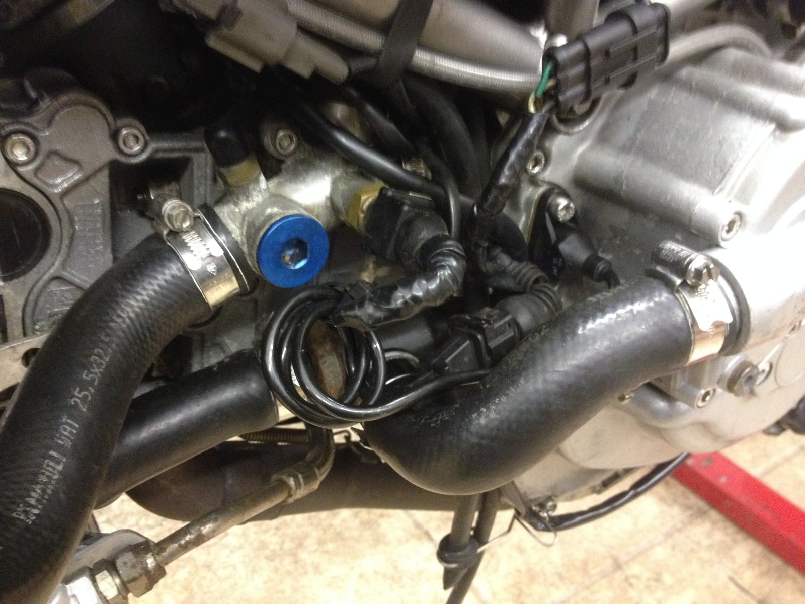

    recently got myself a 2002 998bip in need of some loving, any help advice for my ducati journey much appreciated and welcomed
    riding it home was hotter than id like tbh so ive taken it apart to have a nosey round an get to know her a lil bit. ive got a Haynes manual for a 996 an was hoping it would be close enough that I might be able to use parts of it as a guide or give me a rough idea
    anyhow, Haynes says 3 sensors, gauge, ecu, fan switch, mine has 2 with the front port blocked off
    is this right ? parts diagram says yes but jus want to check
    how can I test fan switch fan operation ? I can probe the fans to test them, normally id bridge the switch plug to test the system but if fans are ecu controlled ? I don't want to risk frying the ecu ?
    ive noticed I think im hearing an feeling a lil spit back up through the bodies, I checked the filters an they appear to be slightly singed, mr ducati dealer told me its not uncommon and a characteristic but I could book it in if I wanted it checked out, is this normal or a good indication theres something wrong ? any known faults I can check ?

  2. they can run hot coupled with the spitting could be a fuelling timing potential issue...personally on ce you have checked it out and are happy with the service work i would get it checked/set on a dyno...:upyeah:
  3. the two fans work at different temperatures im case you didn't know...
  4. You’ll need a 998 manual. The engine is different in the 998 it’s the first of the testasretta line
    Running gear and chassis are same / similar between the two models
  5. Electrics different and batteries on the opposite side too :):upyeah:edit, no it isn't o_O

  15. Check out online when they should kick in and then simply run it up to that temp and see whether they do or not. Simples. Perhaps an obvious thing but presumably it has the correct coolant in there?
  16. Fish, if its any help I've attached a photo of what your wiring should look like in the picture you have poste 20180203_151501.jpg d.
  17. thats cleared it up for him...
    and ASV shoit not samco????....
