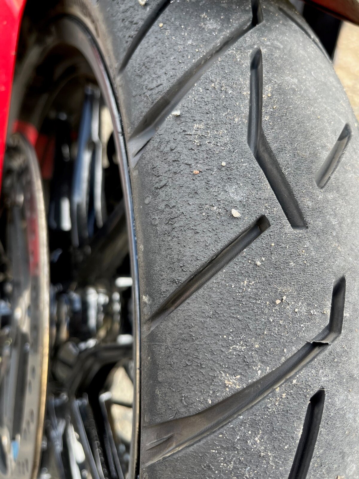

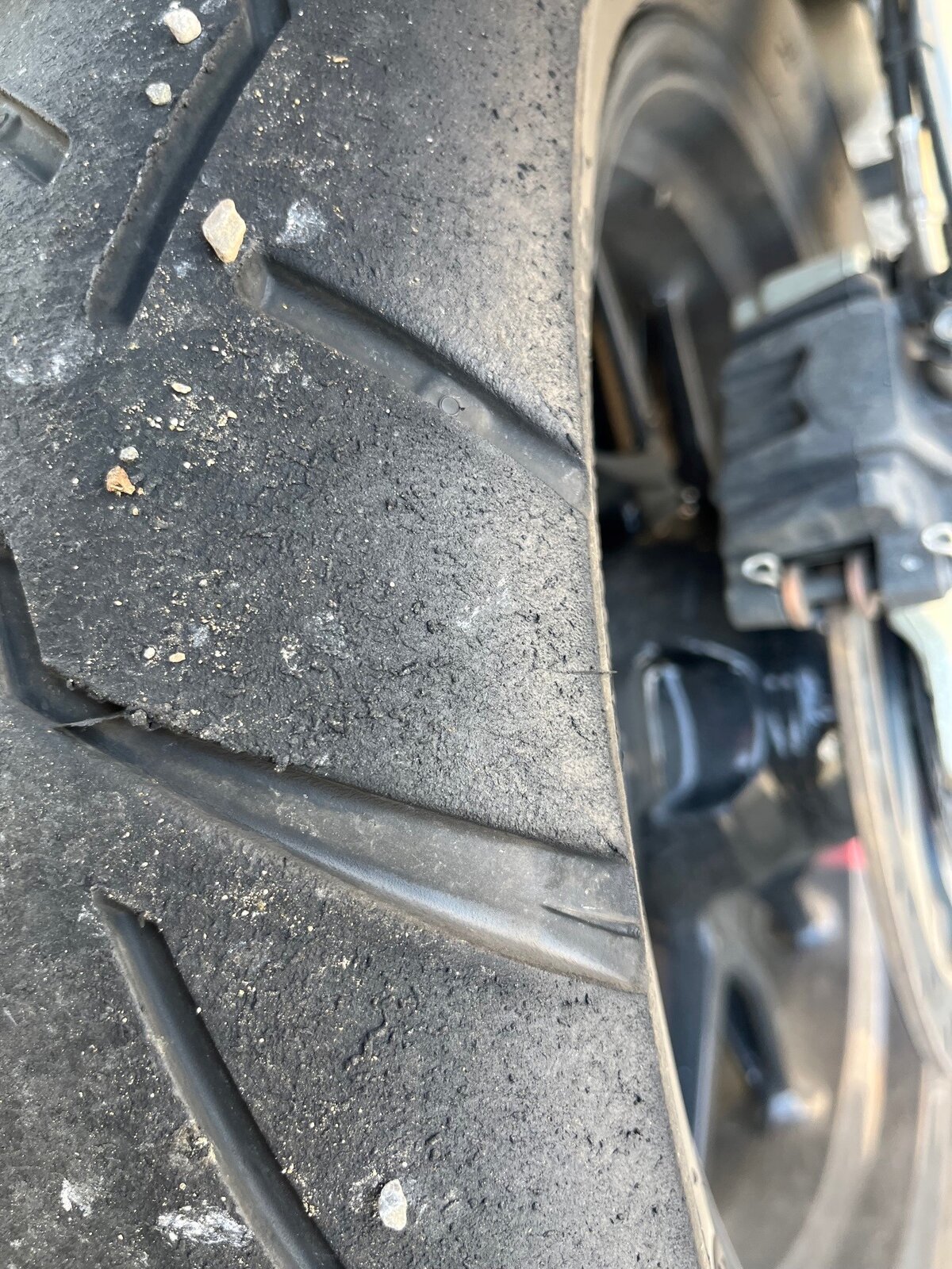

    The photos show the limits not anything else before I get ribbed. Oh , I had the 1250 gs before and they still performed the same , perfect . a.jpg

  12. They look like they have done a track day :D

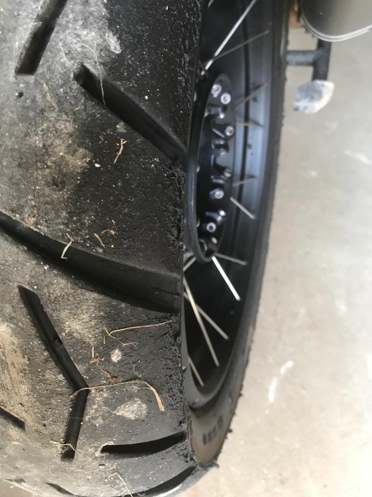

    Not a track day , just magical Spanish mountain roads . These were on a track day but on the R1250 gs
