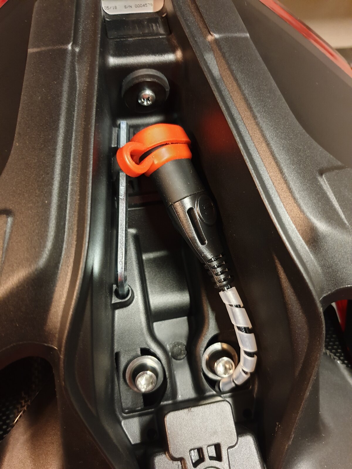

  13. You can run an adaptor lead connected to your OBD connection under the seat into the cubby compartment under your rear seat pad. That way you don't see anything poking out or have to unbolt the seat to get to the charging plug. Here is what I did.
  14. Works a treat, made an adapter for the DDA (sicma) plug for my sons V4R. Very neat.

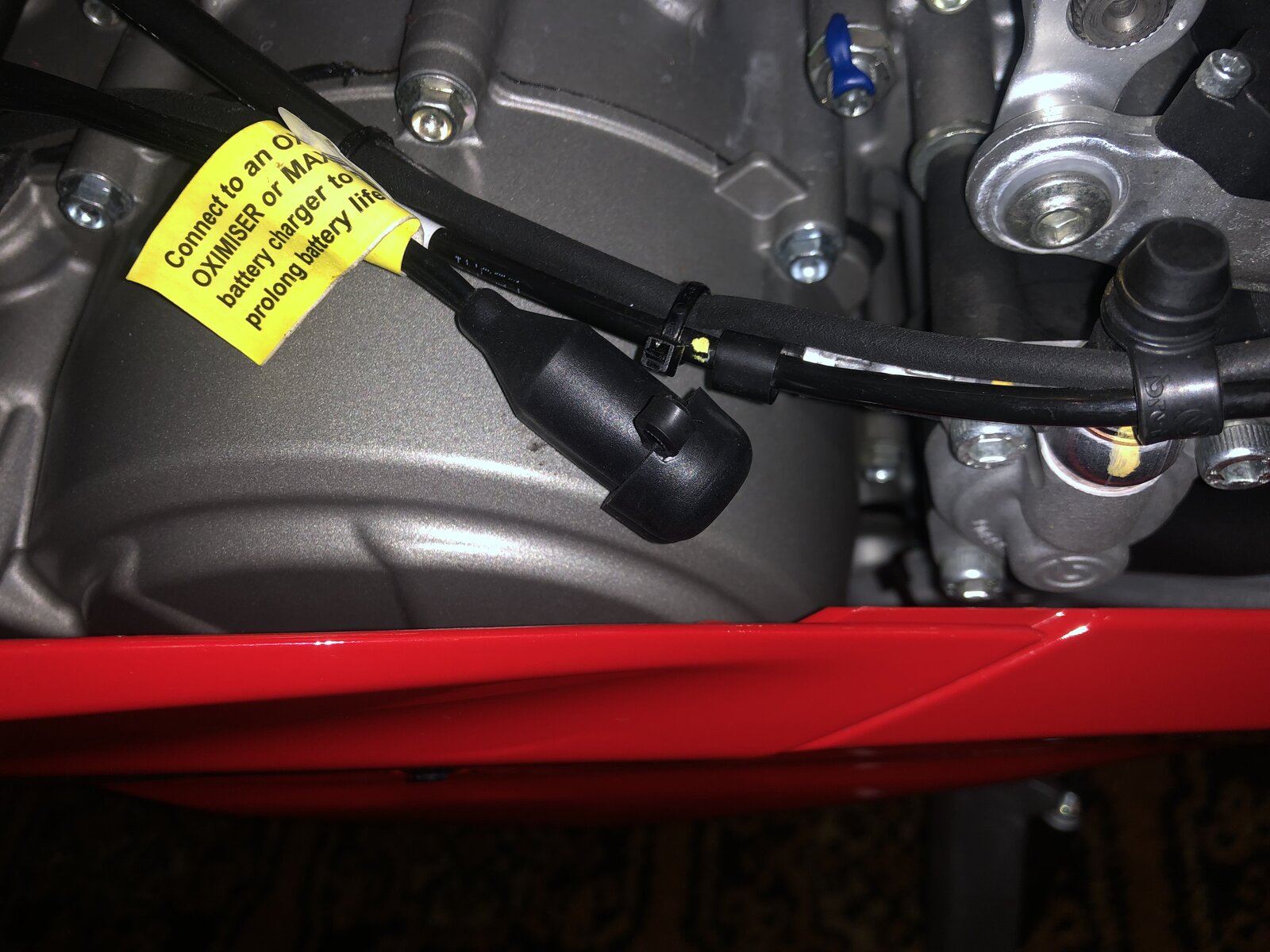

    However my new V2 (ex demo) has an Oxford Oxymiser lead tucked along some existing wiring just out of the LH fairing.
    Even more accessible and quite neat.
    Blends in better now I’ve removed the yellow label ️
