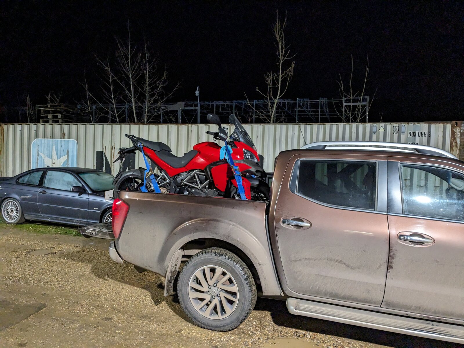

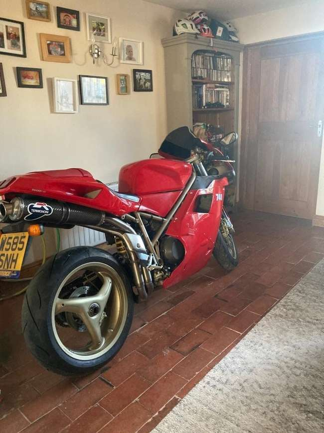

    After 18 years of ownership I sold my 748 recently. I thought with a full time job, family, training for a triathlon and undertaking a fairly major car restoration I didn't need a bike....
    Turns out I was wrong so I bought a multistrada 1200s, with a snapped crank, as a winter project. Wish me luck!

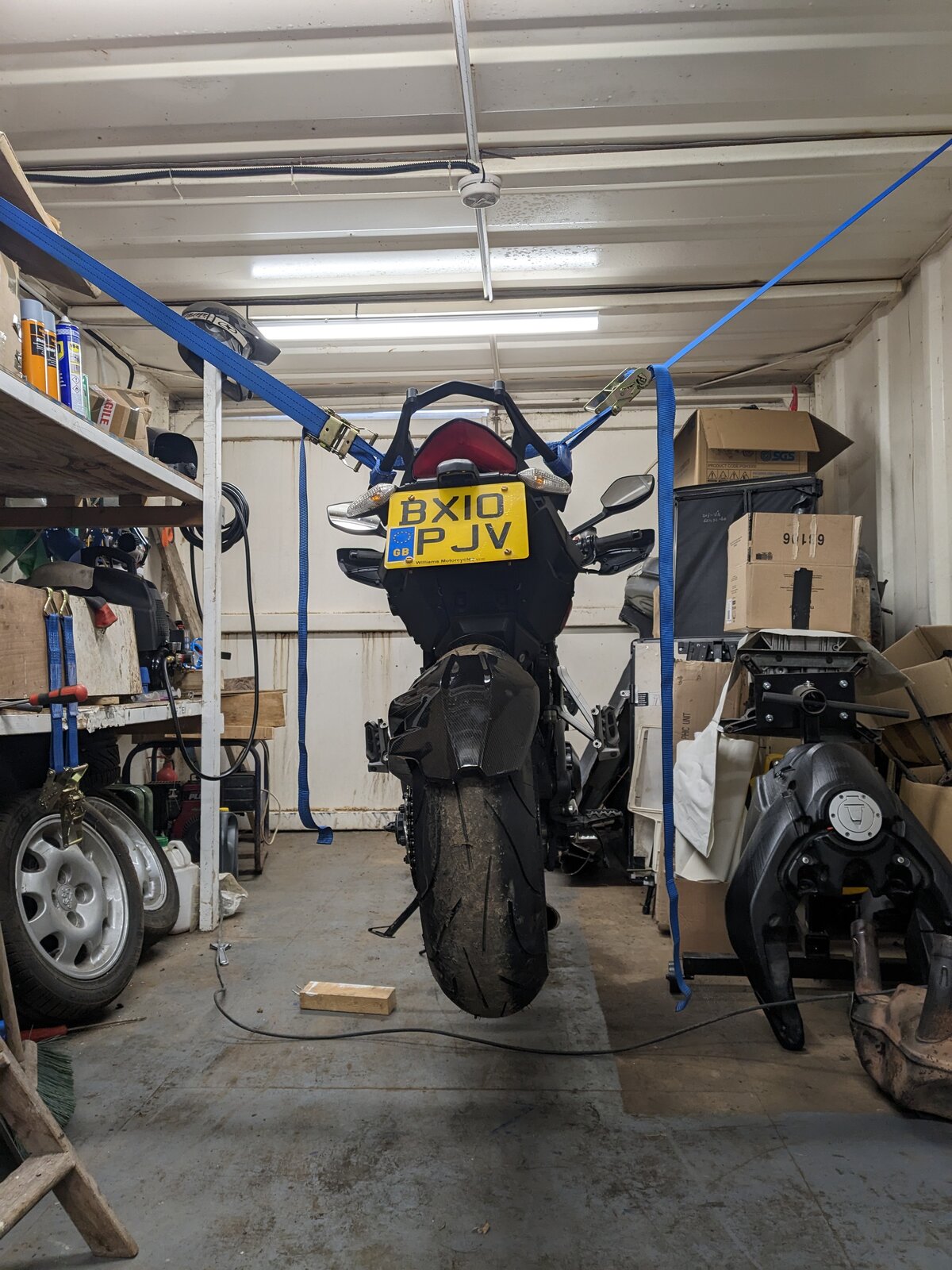

  13. Not convinced this is textbook but it's working! PXL_20231203_111159978.jpg

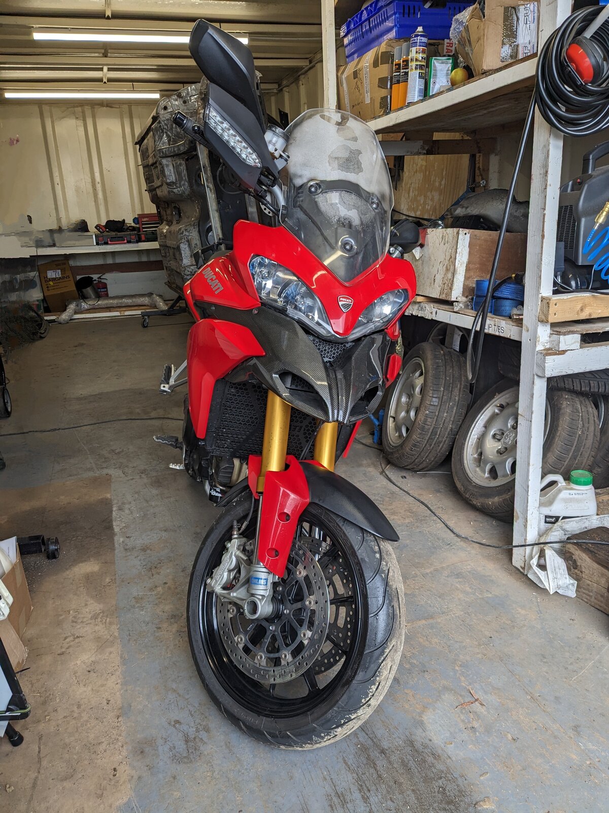

  14. It's taken a little longer than expected but I've just fired the bike up!
    It was a fairly calculated risk, I think I could be the only person who's done it (I've not found anything on any of the forums at least) but I now have 2010 multistrada with a 2016 crankshaft. Not an simple swap, but an enjoyable challenge. Too say I was relieved when it fired straight up is an understatement!
