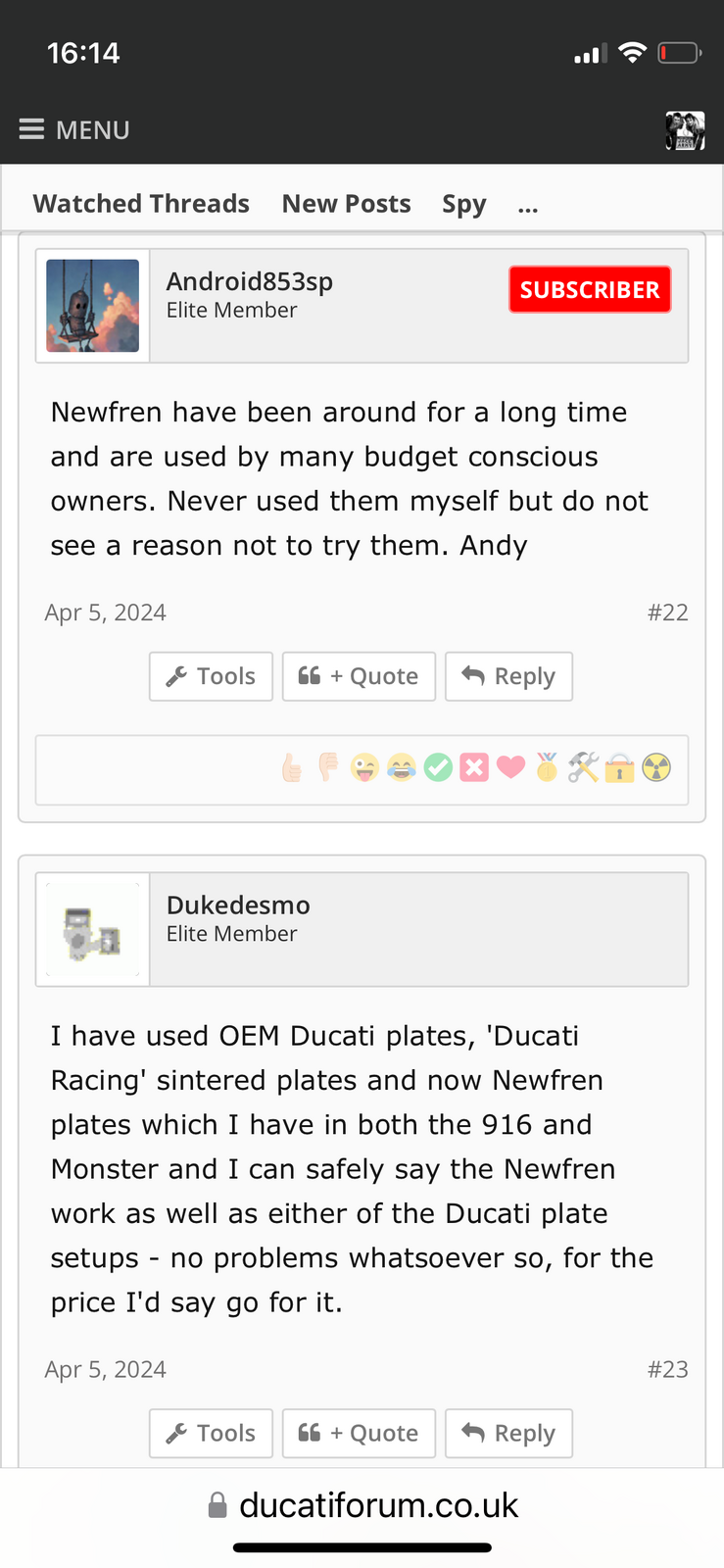

Looking for some replacement wet clutch plates and originals are out of stock everywhere (and expensive). Newfren ones are in stock in a few places but I have no experience of them. Anyone used them? Are they any good? Any better alternatives?

Okay, I was wondering I think EJ’s link to a couple of responses on a Scrambler related post suggests they are worth a try ……. just remember to soak them. Andy

I’ve been using them for about 15 years in my monster and 996/1098. Never had any issues. Would happily order more when needed.
@TBay theyre good , for both dry and wet clutches*, buy them. * Is there a difference in friction compound ? I don’t think so. I think it’s the same plates regardless of whether it’s destined for a dry or a wet clutch. They look and feel the same anyway.
