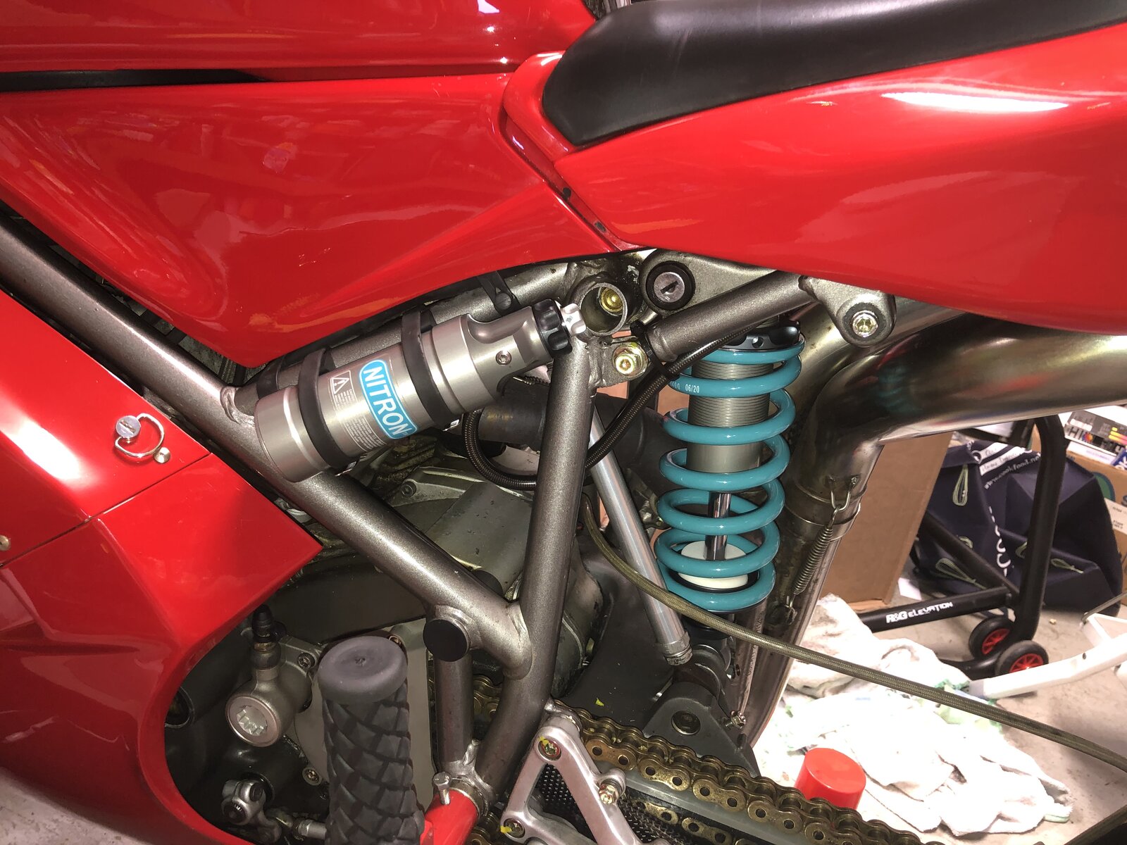

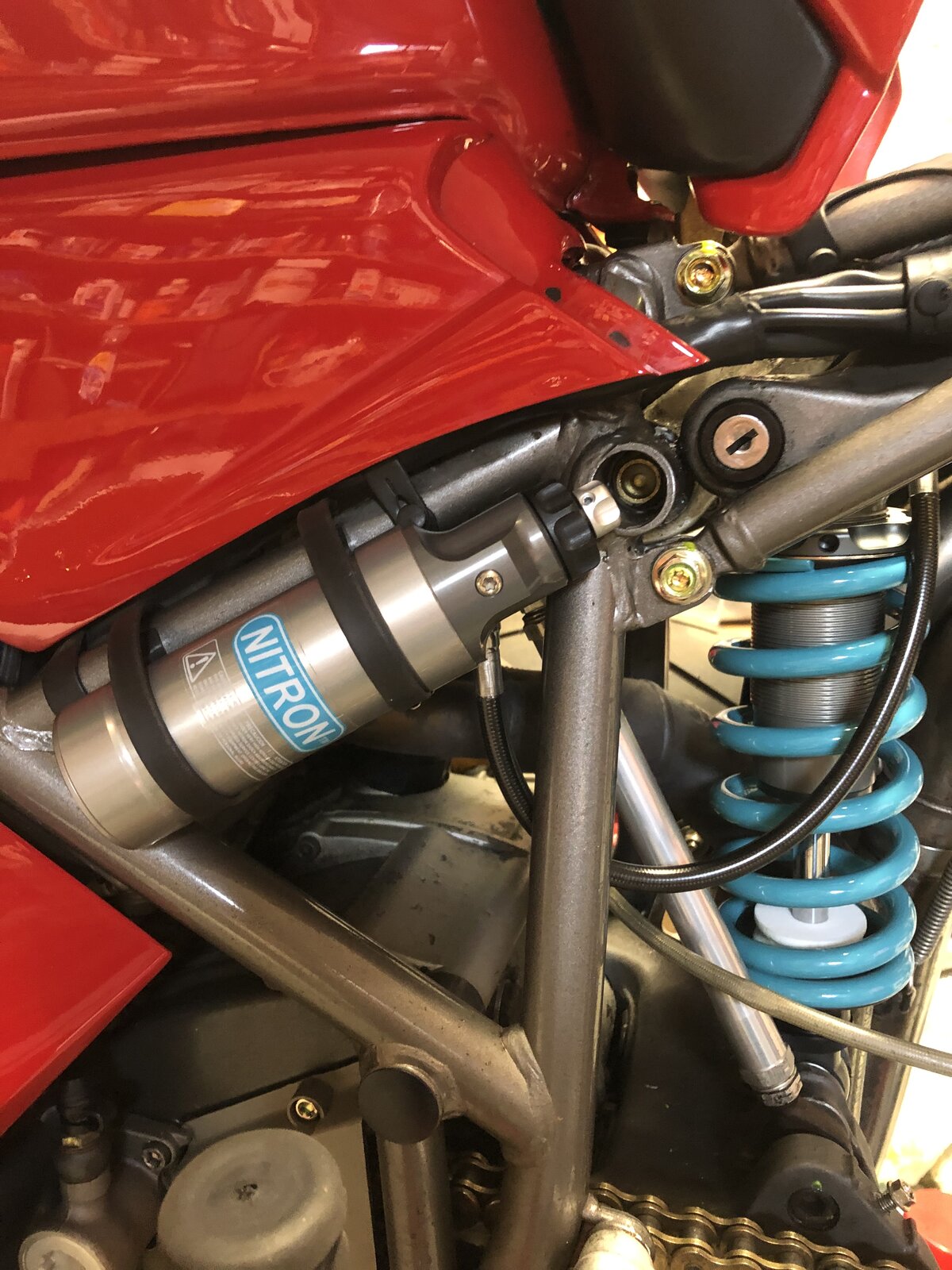

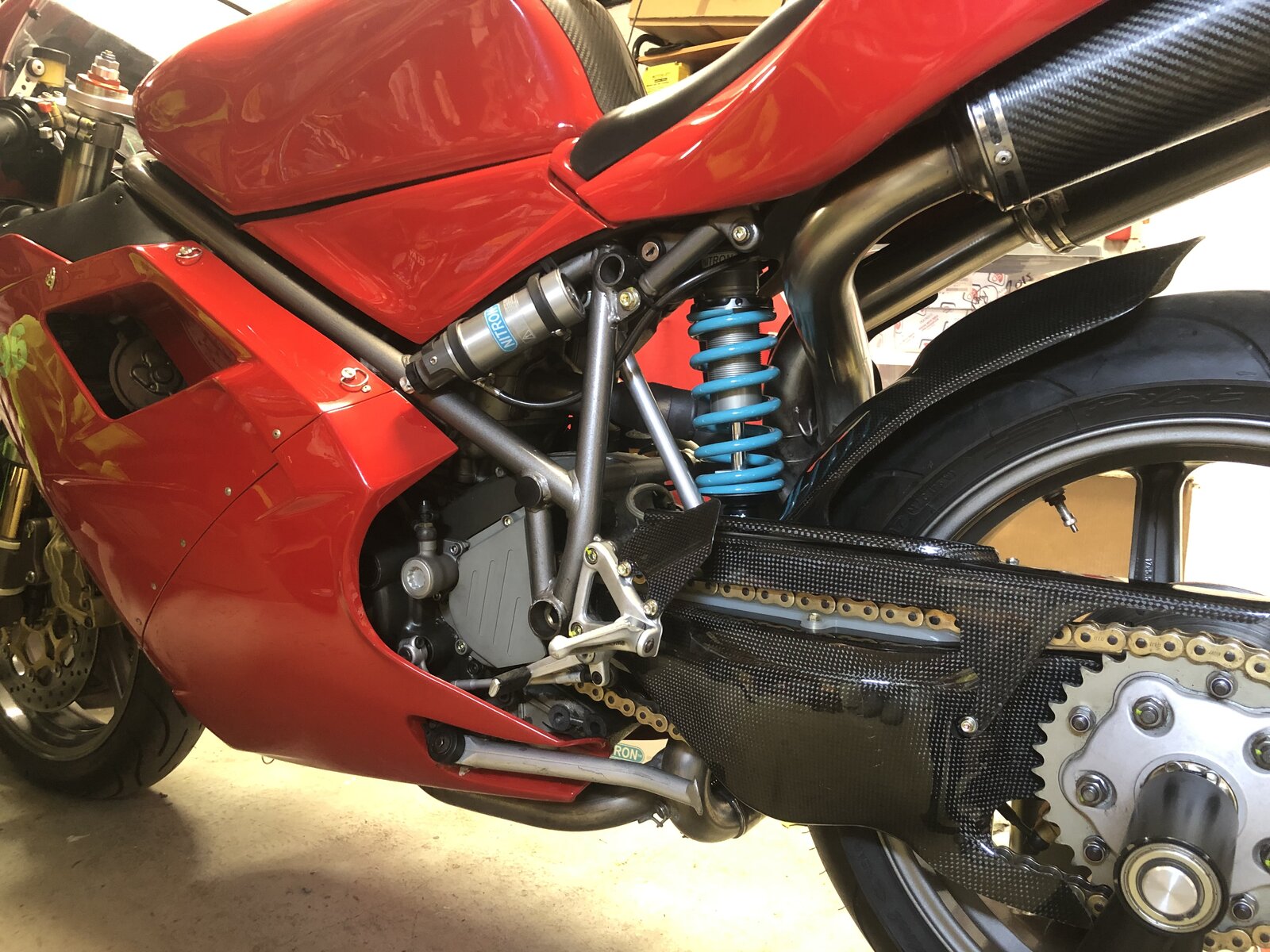

  1. just about to order a r3 nitron.
    I've rang them and asked where the reservoir would be located and they said it'll come with suitable brackets but the guy couldn't tell me anymore than that.
    anyone have a pic of the location? I can't really visualise where it would be located. there doesn't look to be enough room on the left side of the subframe

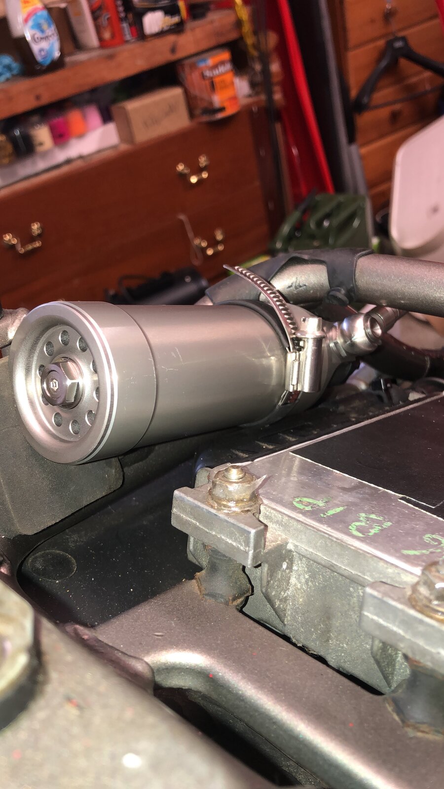

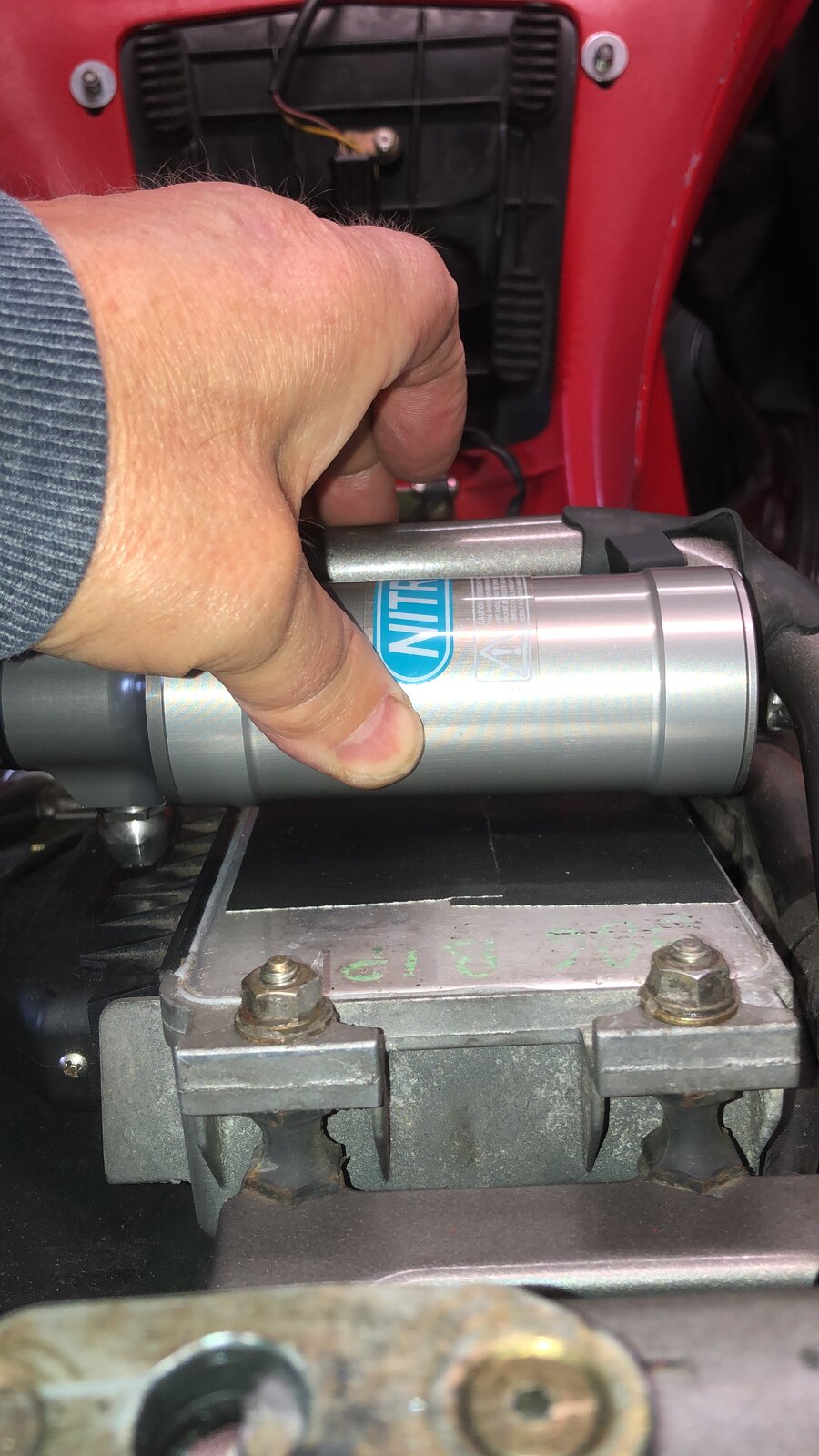

  2. Left side of frame is best. It doesn’t hamper your leg position. You can fit under seat as well with some juggling. Trial and error really. Good shock though if it’s like the one pictured.
    IMG_3203.jpeg IMG_3201.jpeg 4785AE6C-AE55-4144-9844-5CB09FED5AC8.jpeg 5B85528E-F46B-462D-A578-AB54F871AA17.jpeg IMG_3186.jpeg
  3. thanks mate. I'm not too keen on the reservoir from a cosmetic point of view on the left side but will be tidy under the seat.
  4. You may have to relocate a relay or two but it does fit.
