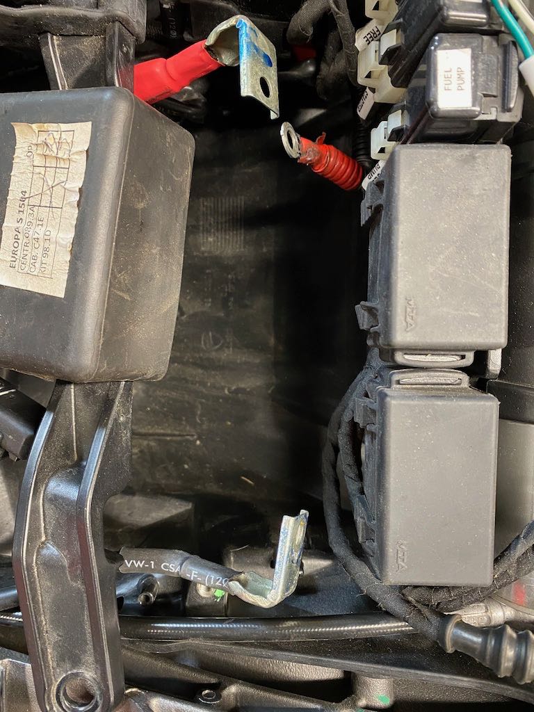

Started the bike today (2018 1260 Multistrada) after not being used for a while, started OK and everything appeared OK, apart from had 'battery low' showing. Disconnected the battery, charged it up and reconnected. The dash/display didn't light up, but the bike started up OK, but indicators horn, main beam etc weren't working. I've checked the two fuse boxes under the seat, and the main 30amp fuse and they are all OK. I also disconnected the battery again and checked that there wasn't a cable I hadn't reconnected. I also tried starting using the button under the cowl in front of the tank, without success. Is there some sort of setup I need to do following removing the battery, or another set of fuses somewhere that I've missed? If not would appreciate any suggestions to rectify this. Many thanks. Mark

I took the battery out again this morning to make sure I hadn't missed a cable, all I can find is two cables going to battery positive, and one to negative (as in the picture) - nothing else. I've checked all the under seat fuses, and checked that I've got voltage arriving at the dash fuses - all good. I'd appreciate any other thoughts or suggestions, I'm about to take it out for a run round the block to see if riding it to the dealers is going to be an option. Thanks Mark

Did you remove the battery when you charged it? It’s quite easy to trap a cable under the battery when refitting, hence you might not be seeing it now? Just a thought..?
