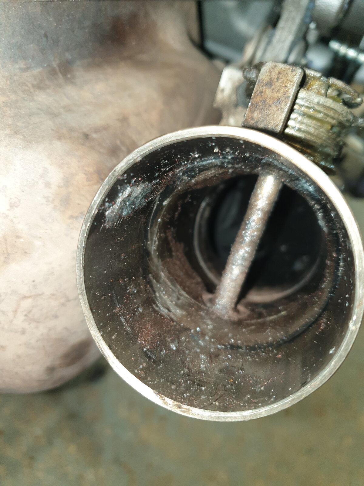

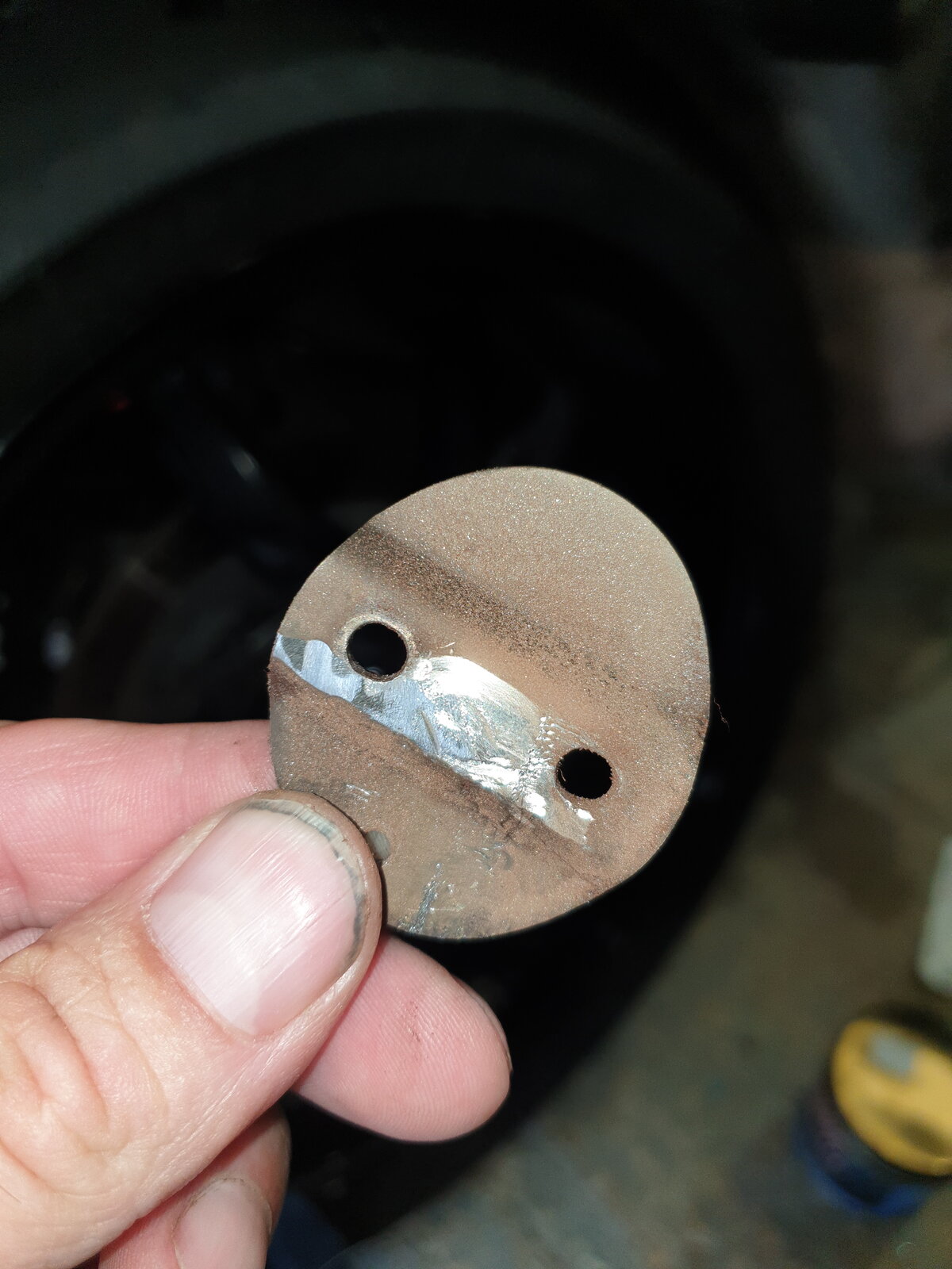

  6. My 2015 DVT did this a few weeks back ... i was pretty sure it was the exhaust servo flap .... i checked and all was moving OK.... i took the plunge and removed the flap by trimming the welds holding the screws and removed.
    Went out for a ponder and made a big diffrence even pops n bangs on over run. Really recommend this.

  12. WELL......I removed the the flap by grinding off the screw heads with my little dremmel, have not done or touched anything else, valve spline still works as it should BUT........ now have the engine warning light on, had a dealer plug bike in & fault shows exhaust valve fault ( they did not remove exhaust to physical look ) they suggest a eliminator that they can supply & fit

  14. There was nothing wrong with the valve, just a preventative measure, the light was not on before but is now & no I didn't tell them
  15. You will need an eliminator to turn the light off, or a spring on the cable. There are lots of threads about this. Eliminator is easiest, if you have a 1200 or DVT I have one you can buy, it’s a simple plug in. Send me a PM if you want it

  17. I'm not sure people are understanding what is happening..... the valve has never caused an issue & no engine light was on, as a preventative measure I removed the flap leaving the spline, cable & spring untouched & fully working.....but some how the bike brain knows that the flap is no longer there & giving a engine warning light
    you can even hear it testing the flap when turning the ignition on
  18. BabyD that is wierd... I cut mine out 1 month ago and not had any issues .... i had 2no options 1st was to remove the flap (what I did) 2nd was to install the Duc EE @ £50. Go withe the 2nd option and get a reset.
