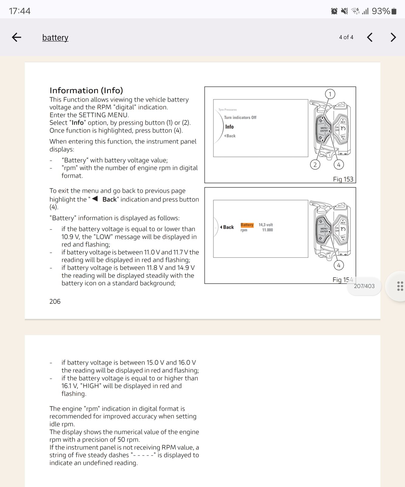

Don't TFT screen thingumy bobs have a voltmeters built in? It'd make it so much easier to check the condition of the battery & charging system. I'm not entirely convinced by trickle chargers. I'd rather let the battery fall to 12.5v or less and then give it a real kicking with a full blown charge for a couple of hours.
Trickle chargers were only really useful for very old batteries, modern batteries, not so much. Unless you're storing for 12+ months or trying to revive an almost dead battery. As for the screen readout, as per the owners manual: Still, a multimeter is a must have bit of kit lying around. You only purchase it once unless you lose it.
Yep.. agree a multimeter is a deffo to have in the garage. I'm not au fait with TFT thingumy bobs so that battery info can only be displayed via the menus and can't be set to permanently display on the 'front' screen?
not sure on this model but 1198S and similar on board voltmeters can display up to 0•3 of a volt lower than actual, so meter every time for me. my generation on here will remember that voltmeters were rarely included as standard on a motor car, and even thought of as a joke because the subtle difference in readings even when running right, meant it was often too late as regards a warning that something was wrong. The ammeter - now you're talking, but more expensive to include, and had to be a quality instrument as was a safety related installation because it had to be wired "in line" with main charging circuit. I remember later cars added a shunt system, that cost even more, and they all slowly fizzled out.
