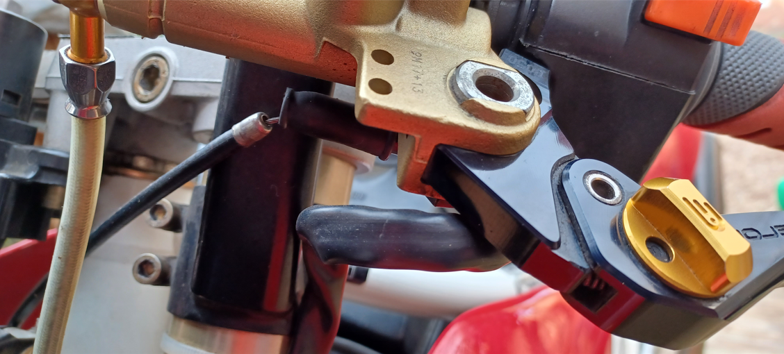

    I did spot this poorly fitted end of the choke cable, which won't be helping. Although the choke does visibly operate at the carb end.

    I just fettling my carbs at the minute. I too noticed an ill fitting choke cable, as yours mine did operate but the end was hanging out of the housing as per your picture, would be intrested if anyone has a fix or is it a case of "they all do tha sir".
