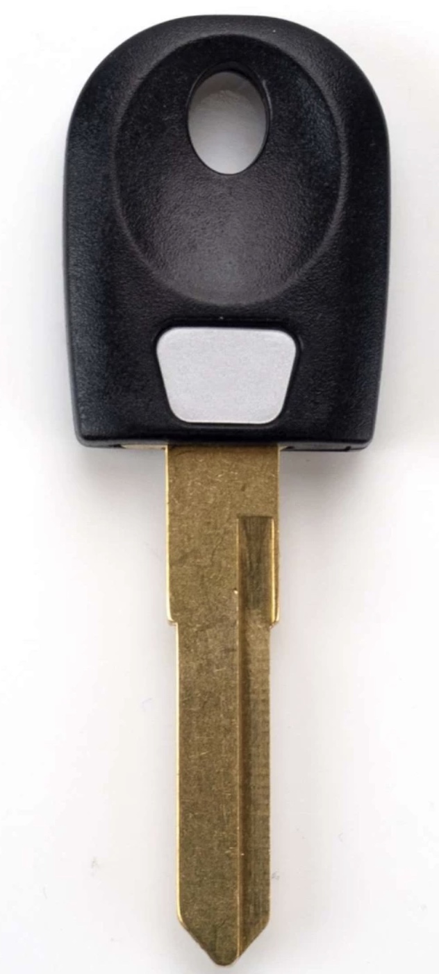

    I have come up with a solution for those not having a bypass code card for the bikes using just 2 black keys (no red key). This will probably apply to bikes up to the release of the Panigale that use this style key. This system is known as I2K
    Definitely the 848/1098/1198
    The transponder needs reading from the keys using a Zedbull or similar.
    I have a Zedbull to do the key reading.
    This will give an 8 byte code.
    I have two pieces of software that allow me to convert the recovered 8 byte code into the 8 byte code held in the dash immo chip.
    The process identifies two bypass codes, both of which will work
    The code will also allow the programming of new keys
    Ducati will tell you that they cannot issue you a replacement Code Card. So if you are looking at a bike with one black key or two black keys but no code card then this is not a deal breaker (I would use it to get more money off the bike)
    PM me if interested
