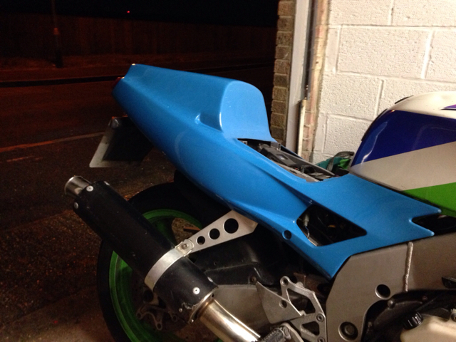

  1. I have embarked on a new project, it's not a Ducati, it's a Kawasaki ZXR400 L3. Basically my mate bought it cheap a few years back with a view to spend a few hundred £ and get it back on the road while he didn't have a bike....
    It had been sat for years and years so the carbs wrecked! so after multiple re-builds and messing around I have finally got it to run, next job is to balance the carbs and check for air leaks around the inlet rubbers (common).
    The list of fairly large jobs includes:
    1) Completely rebuilt front brakes, possible cheaper to exchange or swap with some GSXR600 Calipers.
    2) Same for the Rear brake, even the pistons in both are wrecked.
    3) Clean and degrease the whole bike; check electrics and lights and replace RH Handlebar.
    4) Re-Spray bodywork and find missing in-fill panels
    5) Replace Tyres and check suspension components and wheel bearings for wear.
    TBH, it's a close run thing as to whether it's worth doing! but it is a project none the less and if I can get it running really well once the carbs are balanced it will encourage me to do the rest on as tighter budget as I can.
    I did a 2005 Aprilia RS125 a couple of years ago and it turned out really well, I put a 34m Carb on it and re-built the top end and it goes really well, I guess the ZXR400 is another bike of my youth that I fancied getting together for a blast!
    Anyone else had experience with ZXR400's? My Ultimate plan will be to use it for commuting or small trackdays.

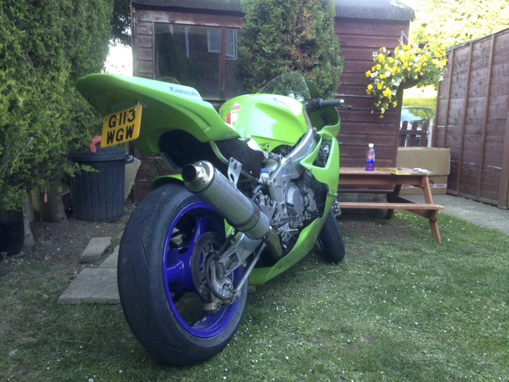

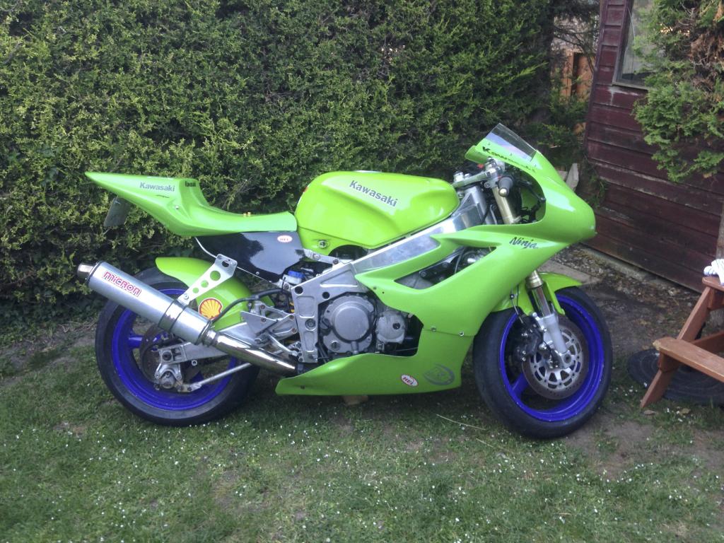

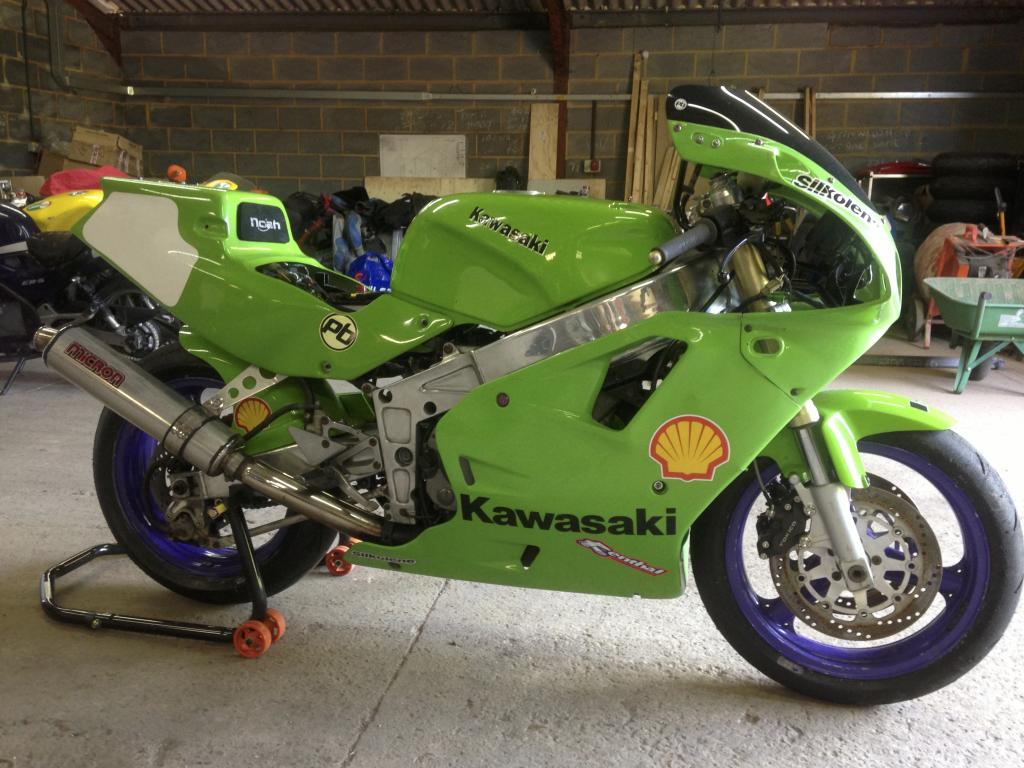

    Mine had no lights, a GPT digital speedo (which cost £100), a number plate and a horn That was it. The most fun you can have on a road. Feel like john mcguiness but only go 120mph max :) :) I really loved that bike.

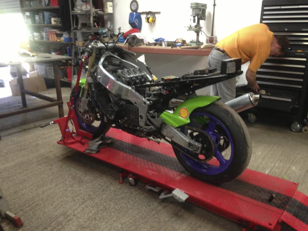

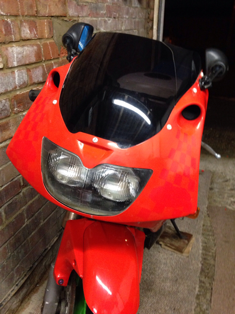

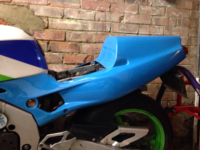

  11. Made good progress with the project this weekend, completely balanced the carbs and got it running really well so that's pleasing. I also removed as much tacky vinyl as I could such as chequered flags and various horrid stickers. If is still going to be several different colours but it's okay. Next job is brakes, which actually may not be as bad as we first suspected and may be a rebuild job.[​IMG][​IMG][​IMG]
