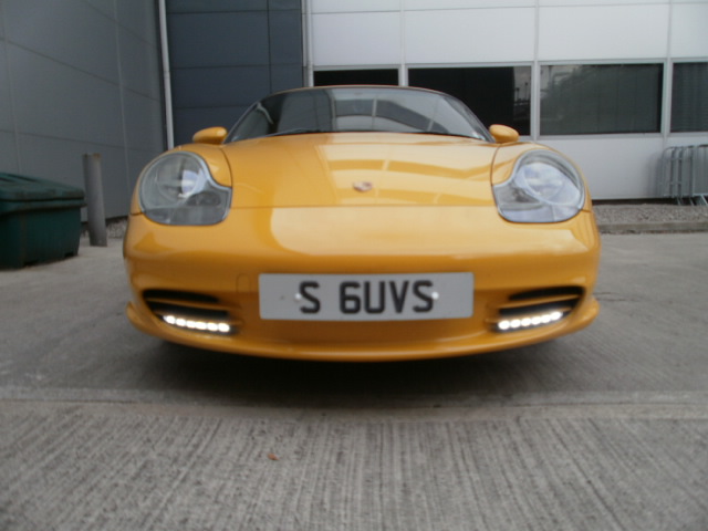

  12. I got stopped the other day for wasn't doing anything, just had a bit of a part wanting to impress a WPC he had with him, couldn't do me for anything else other than incorrectly spaced number 6 on my plate,
    He was sad "B" end of the day cost me £100 fixed penalty.
    The morel of this story is they will book you if he happens to be a plonker with nothing else to do.
    Or don't drive a Porsche around in the Rhondda valleys the coppers there are a bit jealous.
    Guvs.
  13. OR, get a legal plate and then you wont get a fine! You end the day £100 worse off, he goes off duty, just who is the plonker?
