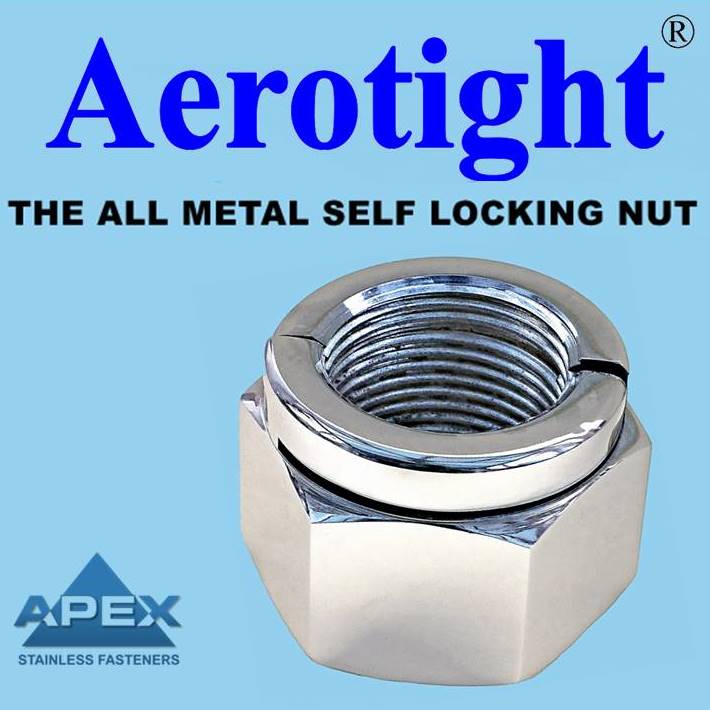

Theres another type of nut that i use which is stainless (the ones im using are anyway) and the locking part is built into the head of the nut (im at work so ive not got a pic) so you can use them on exhausts for example...
