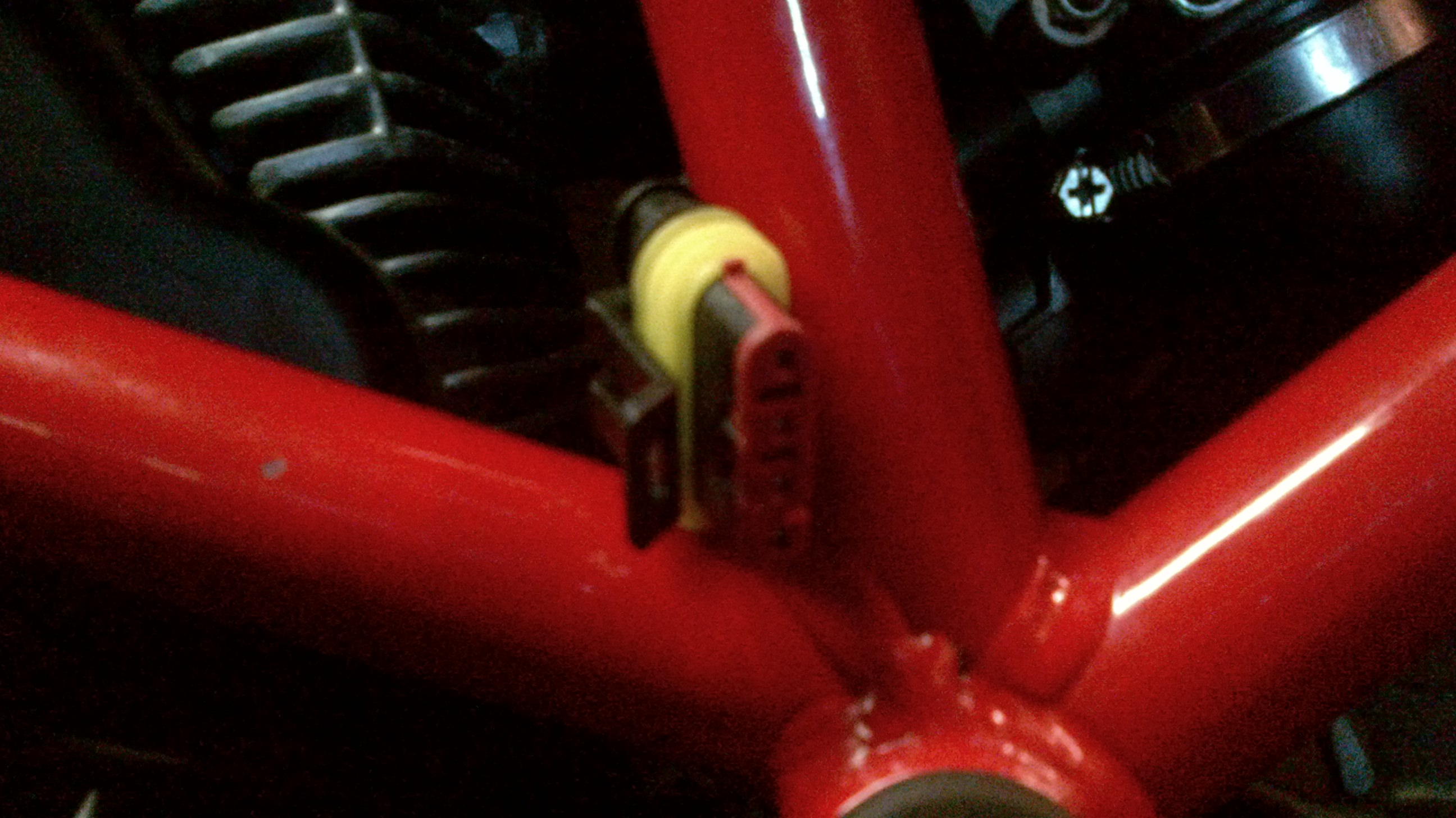

  3. Hi rickyx, thanks for the reply, yes it's an 1100 59 plate, the eBay site said two plugs would be supplied, where do they go? I disconnected the standard o2 sensor plug (photo below) bjt unsure of what or where to go from there?
  4. That's the wrong connector.
    Not sure where the O2 sensors are located on the Hyper however, you need to trace the wires back from the sensor in each exhaust header. Once you find the end of each of those wires, you will find a square block connector on each one. Unplug the connector and plug in the eliminator you have bought to each one.
    On the Monster they were located on the inside of the right hand subframe rail.
    Hope this helps.
    R
  5. Get the Lambda(s) disabled in the ECU, remove it/them and install blanking plate(s).

  9. That's the plug coming from my cat!!! The flatter plug!! The picture below it of the square plug is what the sensor eliminator I ordered will fit, haven't found one of them yet!
  10. Damn! Thanks for the info chrisw, hmmm, what to do? Any negatives to reinstalling the O2 sensor into my decat pipe for now, or do you think I should just do the deed with the bazzaz? Is this what you've installed?
  11. Are you running a DP ECU? The lambda should be disabled if you are. You will know as there will be no Engine Light error on the dash. If not then the easiest way is to disable the lambda in the ECU. PM me for more info.
  12. Hi Chris, all I know is that there is a race ecu that was fitted at the same time as the termi's. What would you suggest, start it and see whether the error light comes on? If it does, will it go out if I reconnect the sensor, or would I need to have a dealer turn it off then?
  13. If you do get a light it will go when you reconnect. If you have the race ECU then the lambda should be disconnected. If it does work then buy some 18mm blanks and take the lambda(s) out.
