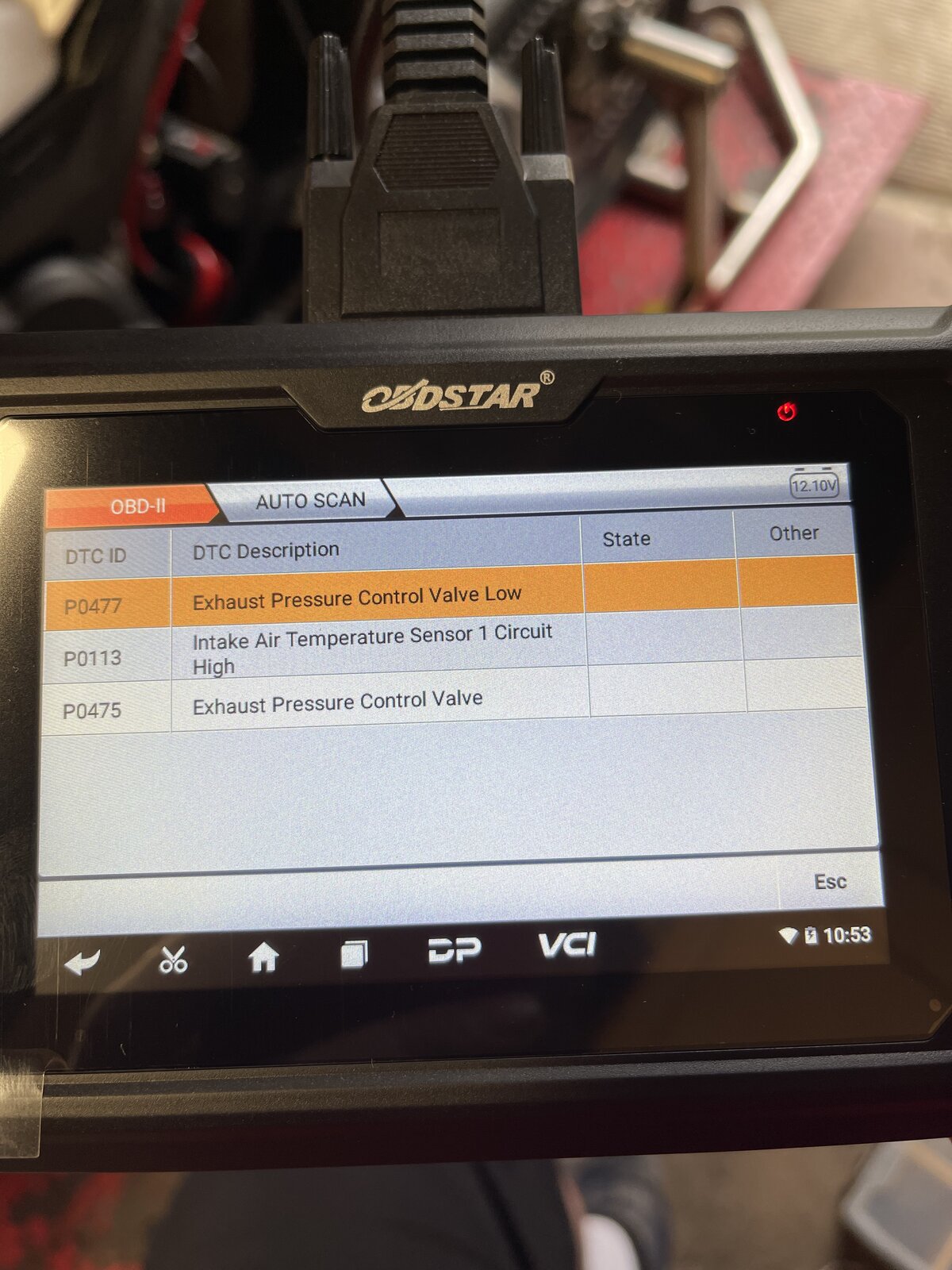

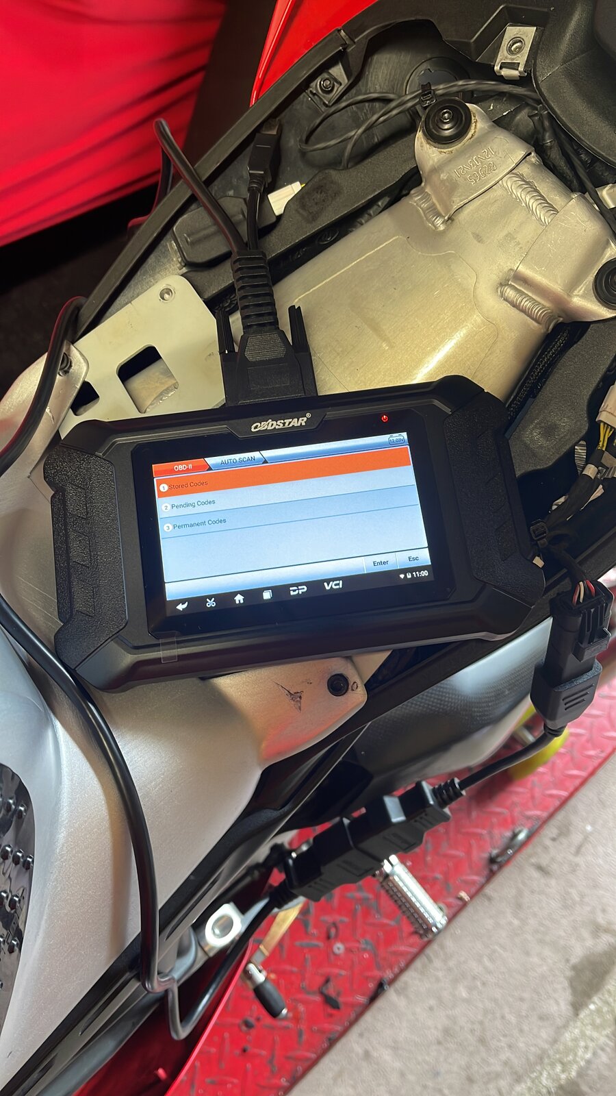

  1. Thought I’d pop a little thread on as just bought a OBDSTAR iScan Ducati which arrived this morning.
    I might have to read the instructions to get the best out of it, but a simple code read to find out why I have an engine light on worked well. So I’m happy so far. Now just need to fix it :joy:

  5. Its great these things (I have one too) can identify the issue ...but what the hell do they actually mean, and more importantly how do we fix it lol? :D :D

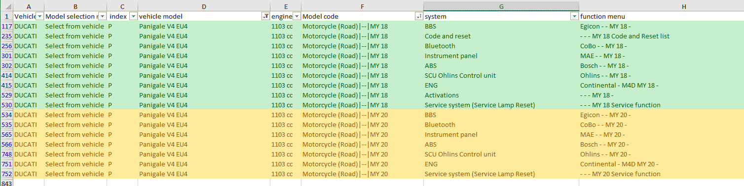

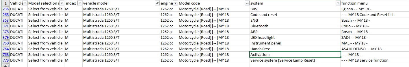

  14. Which bike? Guessing, with Bluetooth, it's an MTS of some description? The coverage of what you can do varies depending on which specific model. For the 1200DVT MTS there do seem to be a few functions missing, the 1260 seems more complete though I don't recall seeing the activation that you're asking about listed (needs to be plugged into the bike)*. Dropped my 1260 off for it's Desmo service this morning so probably wont have it back for at least a week otherwise I'd offer to plug in and see, if it's the appropriate model. The V4 MTS isn't included yet.
    You can see from the attached spec (this is downloadable from the manufacturers website, under the 'Function Manual' tab) that, for my bike at least, activations are available but it doesn't specify which ones. As said; plugging into the diagnostics port of the bike is required to see what specifically can be done.

  16. Differences between specific models/years... Looks like activations will work for 2018 model but currently not 2020...
    Best to find someone close by who has one of these diagnostic tablets.
