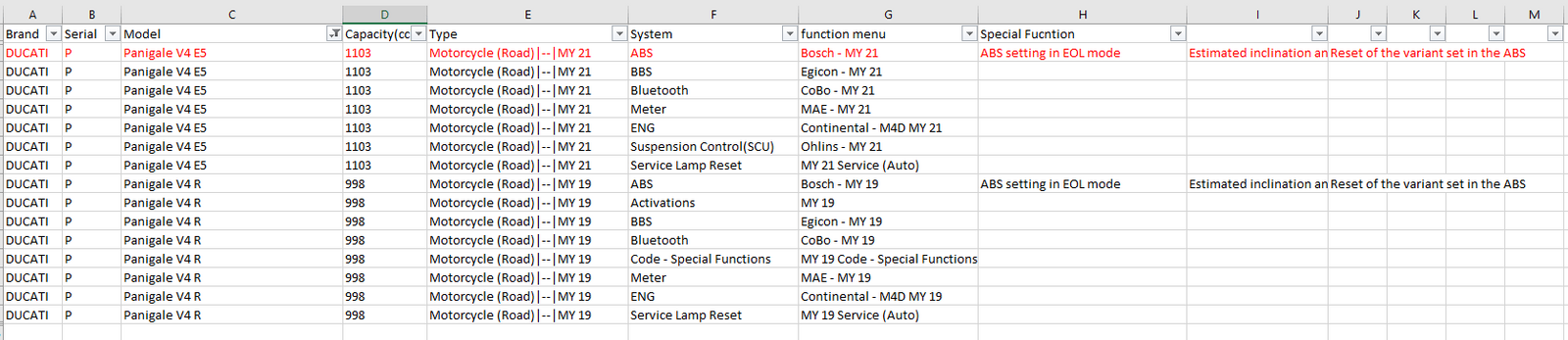

  3. Not sure if it will include that specifically. Normally that would be included in activations but from my experience 'activations' might not include all possibilities, it doesn't list each specific thing it can activate. Unfortunately the only way to find out if either contact the manufacturer (good luck with that), speak to BMDiag or find someone near you that has one and give it a go as you can see the specific activations only once it's plugged in.
    I haven't updated mine as I have all the functionality I need from it for my 1260 Multi. My last update was at the end of May, my 1 year included update subscription then expired. What appears below is the listing for the most recent V4 Panigale (MY21 Euro5 model) that's incorporated into the software version I'm running. I've also included the functions for the V4R, you'll note that this includes 'activations' whereas the E5 MY21 one doesn't.
    You can download the current Excel spreadsheet from the product page here. You'll need to click on the 'Function Manual' tab. You can then use filters to only show the model that you're interested in. However, to reiterate, you won't see specific individual activations.
    For my 1260 Multi it does all the activations, for the 1200 DVT it didn't do one of them, spotlights IIRC, for some reason though it still listed 'activations' because it did the others... hope that makes sense. I think, in that case, it's since been included in an update.

  6. Thanks for the in-depth reply Bumpkin. I did have a look on their site and found their latest Spreadsheet and it did show GPS activation of the GPS for the MY21 E5. But no idea if that would include for the M2022 or even work. As you say it is a matter of asking the manufacturer and that could be a fun rabbit hole to go down. Find someone with a unit locally (Anyone close to the St Albans area) to plug in and try or Buy one and hope :)

  7. Apologies for my ignorance but is there a technical difference between MY21 and MY22? The listing showing MY21 will cover all years of manufacture, from then, up until Ducati bring out another variant of that model.
    I can see from the latest data for the end of June, I downloaded it out of curiosity, that there are some rows in red. Included in these, as you say, is the ability to enable/disable GPS. I think this red indicates an update either in information disclosed or features added.
    Yes models, and additional functionality where absent, have been added in the time I've had mine. There's obviously a development lag though.

    "I can see from the latest data for the end of June, I downloaded it out of curiosity, that there are some rows in red. Included in these, as you say, is the ability to enable/disable GPS. I think this red indicates an update either in information disclosed or features added."
    Ah this is interesting. I mean i am happy to take a punt on the OBDStar if they are regular updated. It is a handy tool to have and this bike is here to stay :)
