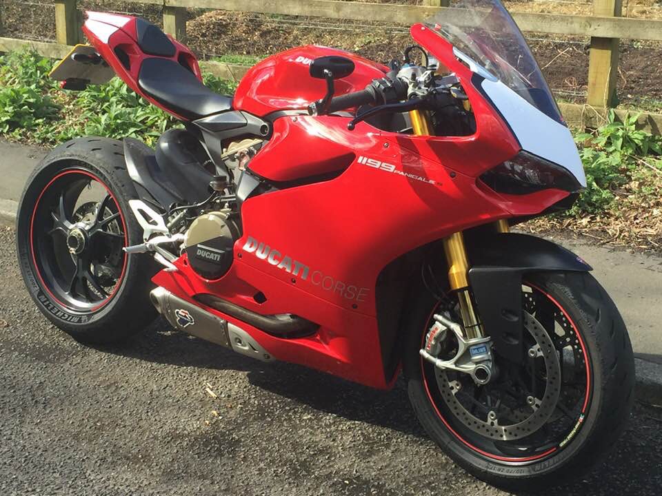

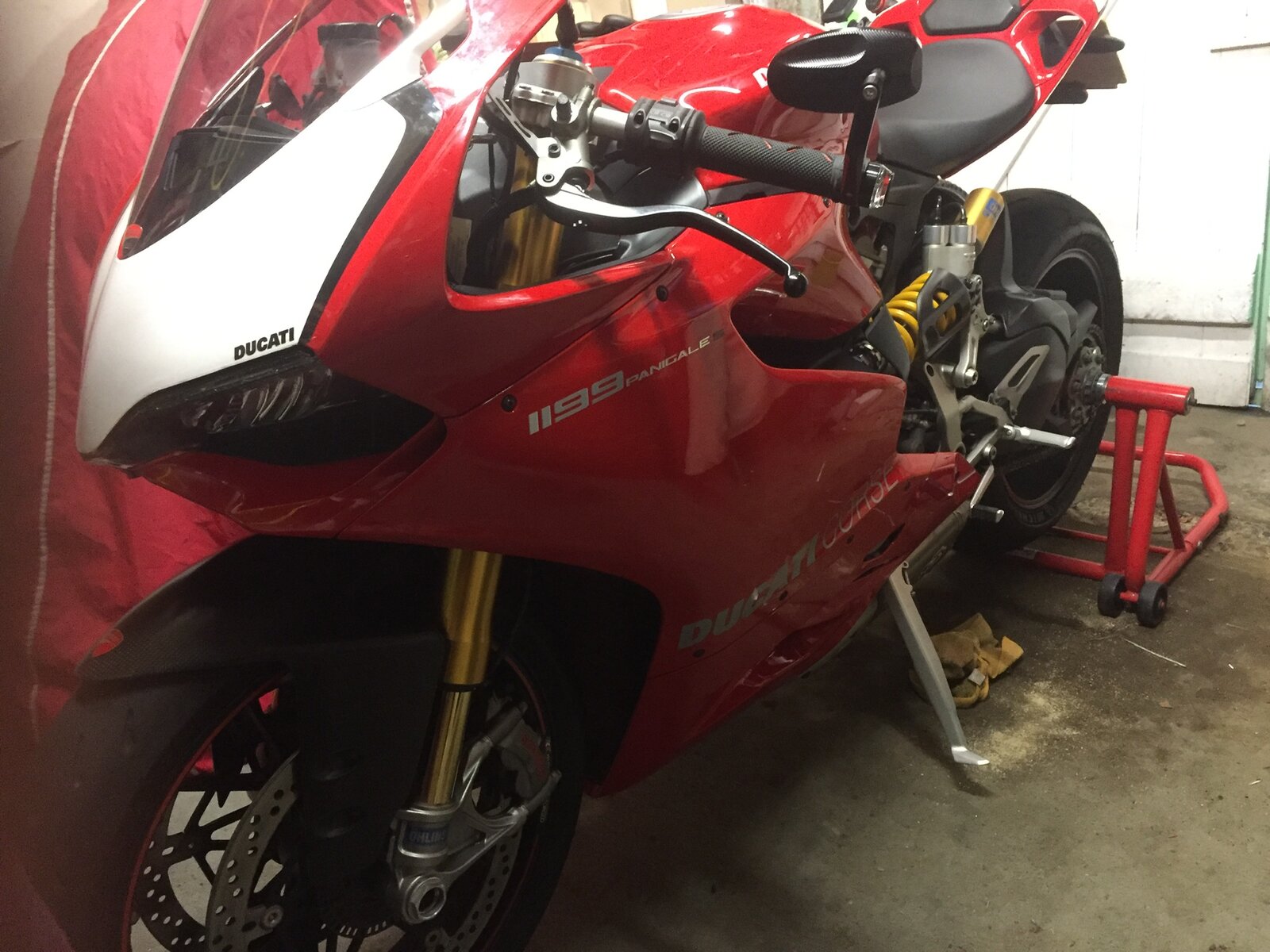

  11. IMG_4753.JPG IMG_4840.JPG I brought these very cheap on eBay I have had no such issues
