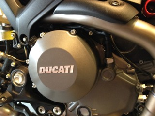

  7. Am I being really stupid but clutch cover on monster must have changed as it is all in one with the right hand engine casing? ImageUploadedByTapatalk1341942939.995469.jpg
  8. It's a wet clutch like on the 848, by the looks of that.
  9. Certainly is ! Lol
