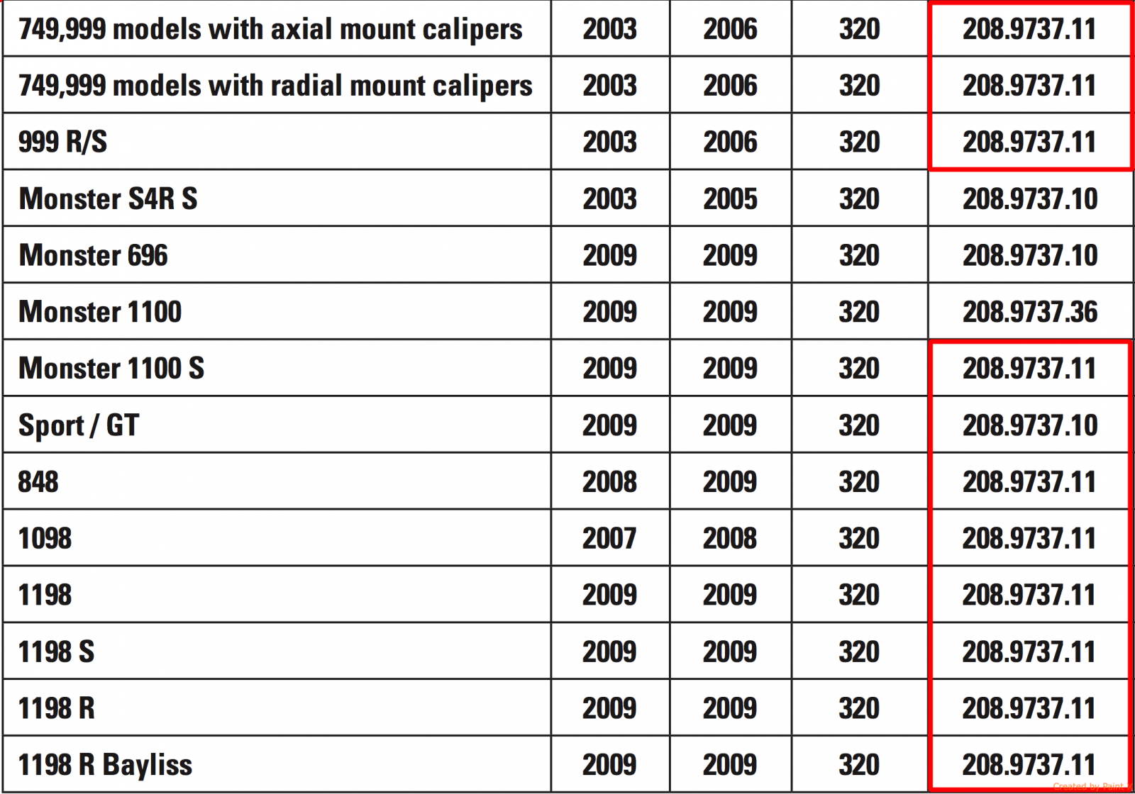

    Can someone let me know please if 1098 and 1198 use the same discs?
    Also are they all the same for std , S and R version?
    Just got some HPK 320mm discs and not sure what bike they fit other then 1098 and if they do need any spacers?
    Any info is much appreciated.

    Hmmm??? What was the point for Brembo to do 320mm discs rather then std 330mm?
    Normally you will go bigger or oem but not smaller.
    Just looked at brembo catalogue and looks like they list few bikes with the same 320mm discs.
  4. 320 was a Cagiva (then Ducati) benchmark dia which they decided was adequate in either single or twin configuration, even interchangeable with the Mito in it's earliest form. It could be that the later type disc in that diameter was seen as easy to adopt/ a known quantity possibly using existing stock fitted to other models.
  5. My source information is the Ducati.com model archive which details the model specification by year. I cannot explain why there should be a difference between that and the Brembo catalogue. Andy
  6. Just found some info on the other forum that Brembo decided that 320mm in HP discs is much better option over stock 330mm dia.
    Just wonder why they started doing 330mm for 1199 and 1299???
    Anyway, thank you all for the input.
