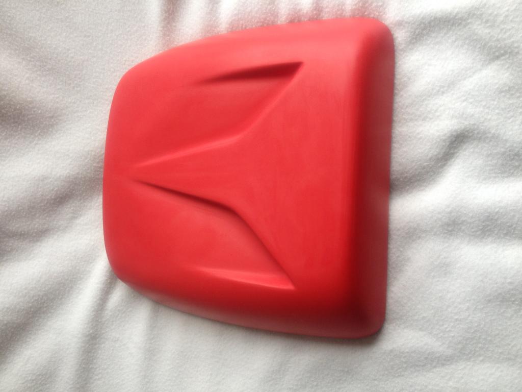

    I have one of these for sale in primer if you are interested and want a mono type look, it's a copy of a genuine Ducati seat cowl cover and makes the seat look like a mono type but without all the hassle of a complete conversion and it's easy to revert back, just unscrew it, I make them myself and I provide all the fixings with it, the genuine Ducati price at the time was £127 . Again PM me for a price, it will be a fraction of a full conversion and a lot less than the original. This is now a very rare item so it's unlikely you will find one on something like eBay.
    The matt look on the one in the photos is because it was flatted for lacquering, that one went to a forum member on here who has bought two of them over the years.

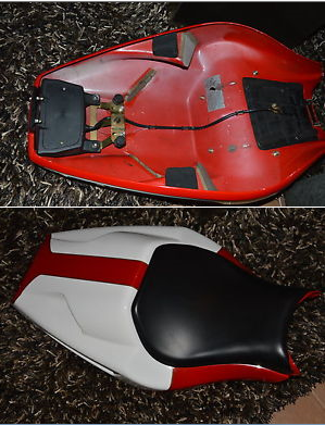

    This is the seat unit in question:
    So I'll need spacers and a bracket. I'll see if my Dad can make them, or take a trip to a dealer for the bracket.
  6. You can get the brackets on ebay easily enough Jeff. If you add an ally subframe they will need changing too. I'm sure ive my old set thats fits the monoposto on the standard subbie in the garage somewhere but fuck knows where. THink they were very cheap though. But mind, theres a set for an OEM subbie and at least one other for an ally subbie.
  7. It looks like you have a different bracket for the seat. If it is stepped and if fits properly then you can use that one. it's hard to tell from the angle of the photos, do you have spacers under the lock plate end?, if so all should be OK as it looks like someone has already fitted the bracing bracket but just used a different bracket.
    If you offer it up and it fits it should be fine.
    The bracket used in the link below is often used instead of the bracing bracket I quoted, which is largely flat. As you can see there is a price difference. You will still need spacers to get the lock plate to sit correctly but these go under the angled plate and not on top of the plate that I quoted to you. It's just a different way of fixing the seat unit at the back, both work equally as well on stock plastic seats. If you use a non stock seat then the flat plate needs to be used as the spacer length needed is often greater.
    I hope this makes sense as there is a bit more to fitting these seats that people often realise. I can make custom spacers for you if you need them.
