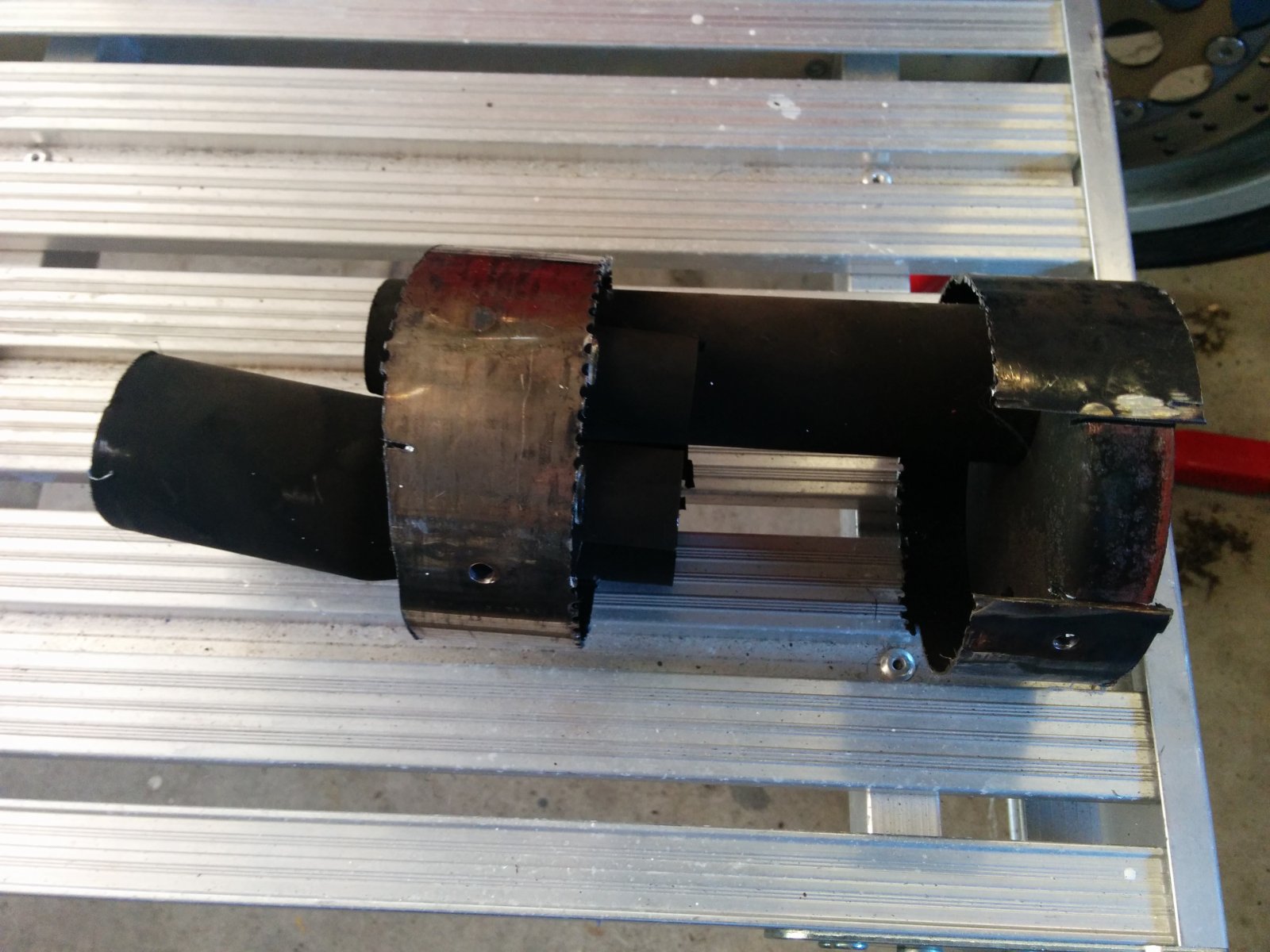

  2. I cored my standard cans on my S4RS monster. Drilling the rivets is just the start! There's a weld just inside that needs to be sliced, before it comes apart. I used a Drevil? Think that's what it's called. There's a great blow by blow thread here on this site, though I can't recall at the moment who posted it... No doubt someone will be along shortly...

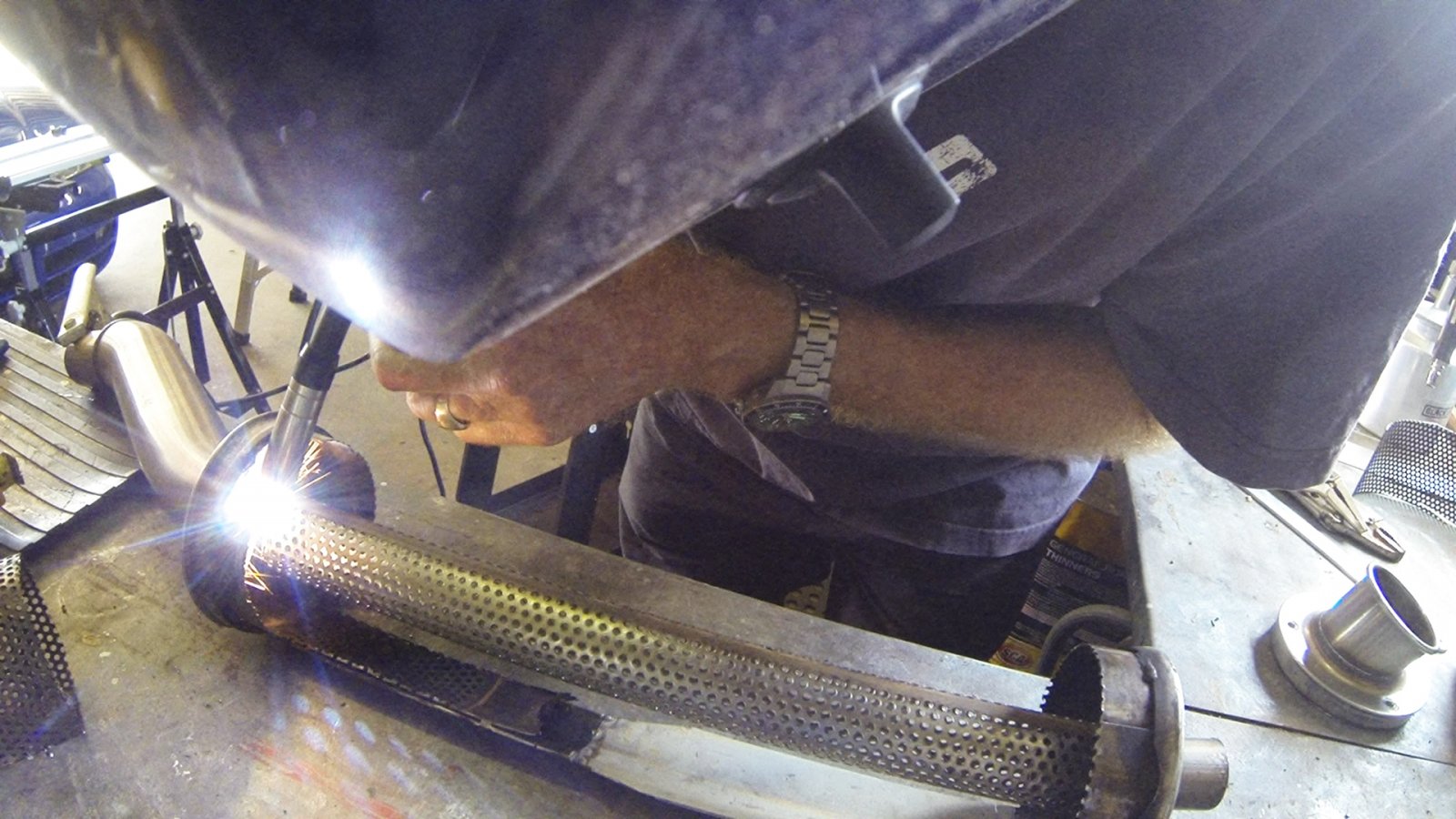

  8. There were a couple of reasons for me doing it. Firstly I wanted the bike to look original whilst improving performance. Secondly there's less chance of me falling foul of plod if I've got stock cans which are just a little noisy rather than something which is blatantly aftermarket. Also, once you have the sleeve off there's no more work involved in coring them and rebuilding them as there is in building something from srcratch. In fact it's possibly even easier as you retain the mounting points and end plates, just weld a new section of perf tube in between them after cutting the crap out. I also managed to determine how noisy mine were by specifying the diameter of perf tube. Race cans generally use 2". I went for 1.75". Slightly less noisy.
    Once I had mine stripped and gutted I had all the internal welding work done by professional exhaust specialists. The whole job including anodisng cost me less than £200. The cans look like new, sound great and improve performance. The guys I used said that the banging that others may experience is due to not crimping the perf tube at certain points. This crimping forces the gases to bounce around a little and exit the holes in the perf rather than just blowing the gas straight out of the back. This disrupts the pulse effect from the engine.

  11. Did the "straight-through" mod to the high mount pipes on my '96 SS. Makes a nicer sound now. Here's a pic of what came out and what I replaced it with... IMG_20160223_104400.jpg Welding Tube.jpg

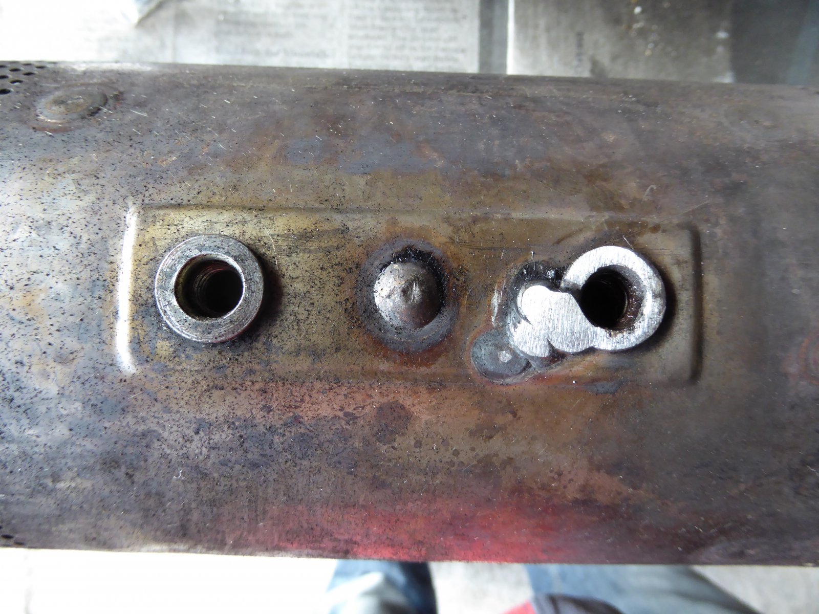

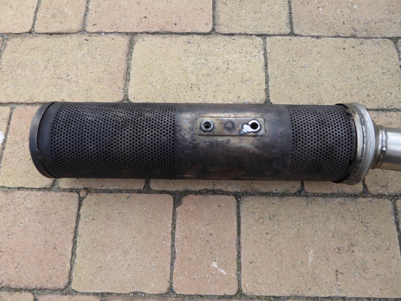

    I drilled out the stainless pop rivets (they're tough) and then spent a happy couple of hours with the Dremel grinding down the stub of the stainless bolt remnants to below the level of the aluminium skin (also tough). Then, after releasing the end cap with a cold chisel, I took about 100 goes at releasing the skin from the exhaust inners. Eventually, it gave up and came off, leaving a very black layer of fibreglass covering the perforated inner gubbins. The thing appeared to have been sort of glued together...
    Then I could see what was going on. There are two stainless blind threaded thingies (don't know what there might be called, or how they're held in place), one of which was fixed (somehow) and the other was able to rotate freely.
    So then I took it to my local garage and asked them to tack-weld the rotating thingy into place and extract the remnants of the bolt. Took them absolutely ages, they said.
    This photo shows what it looks like now:
    .... and this is what the perforated inner looks like, in case anyone's interested.
