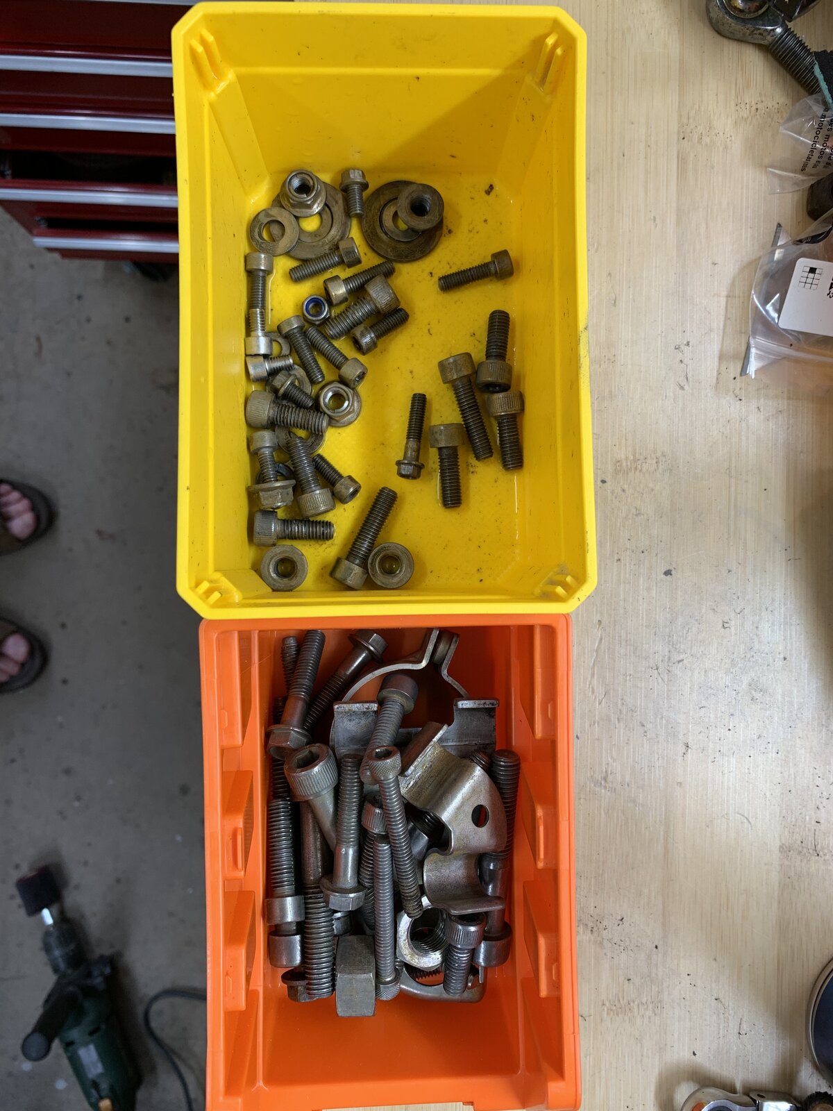

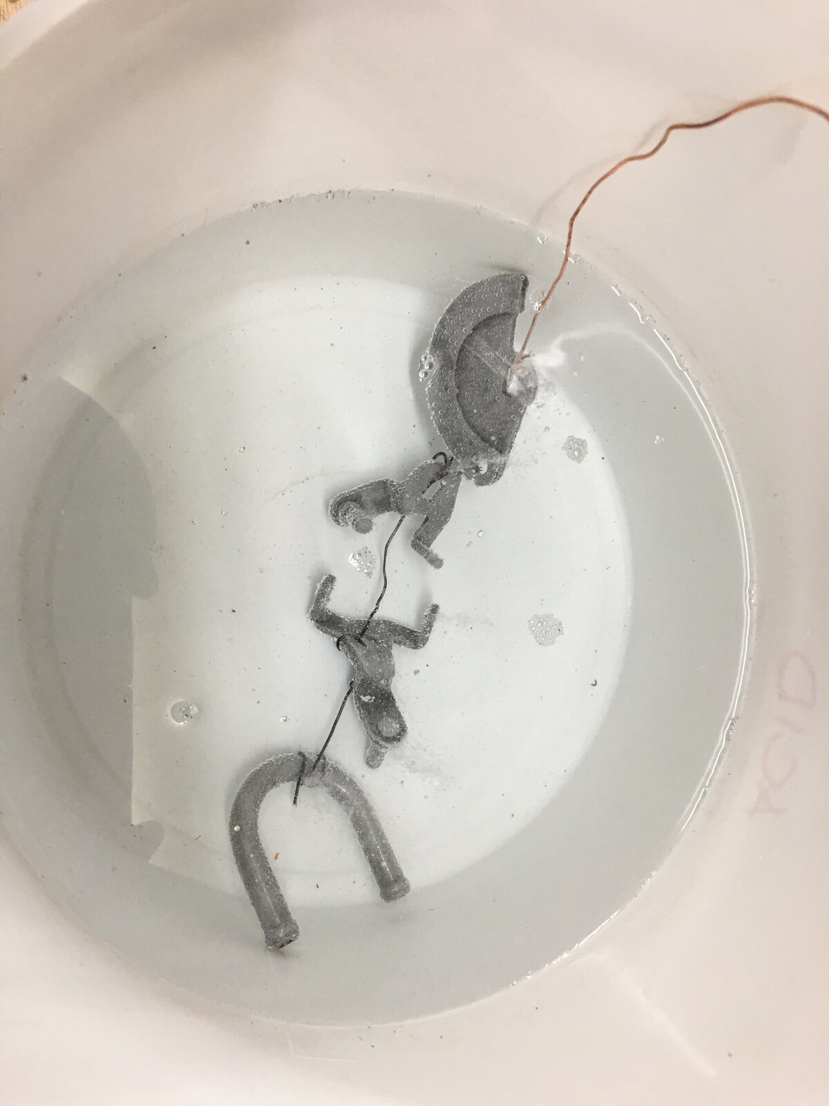

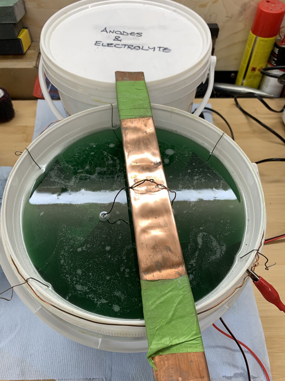

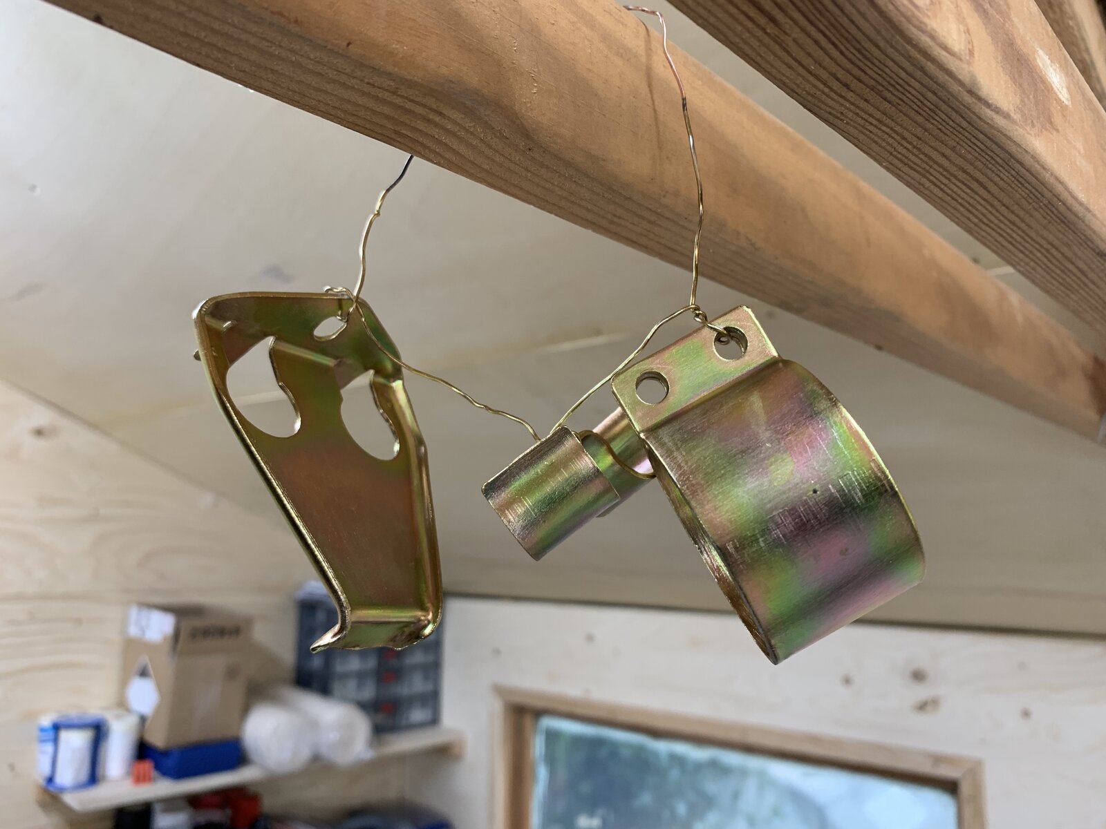

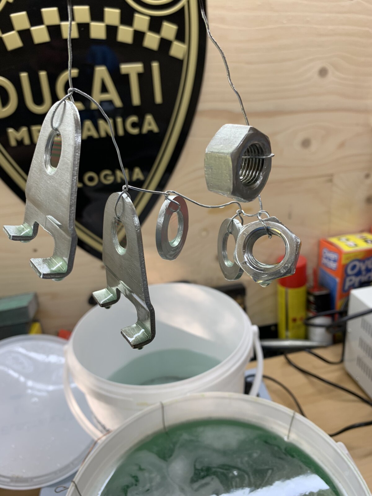

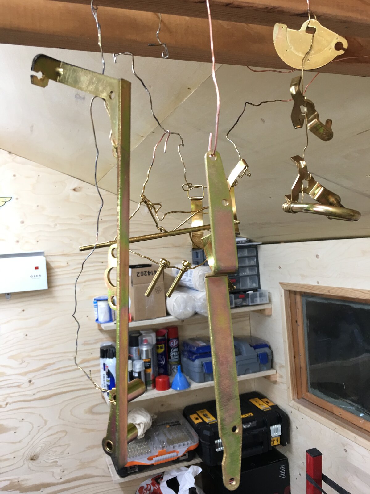

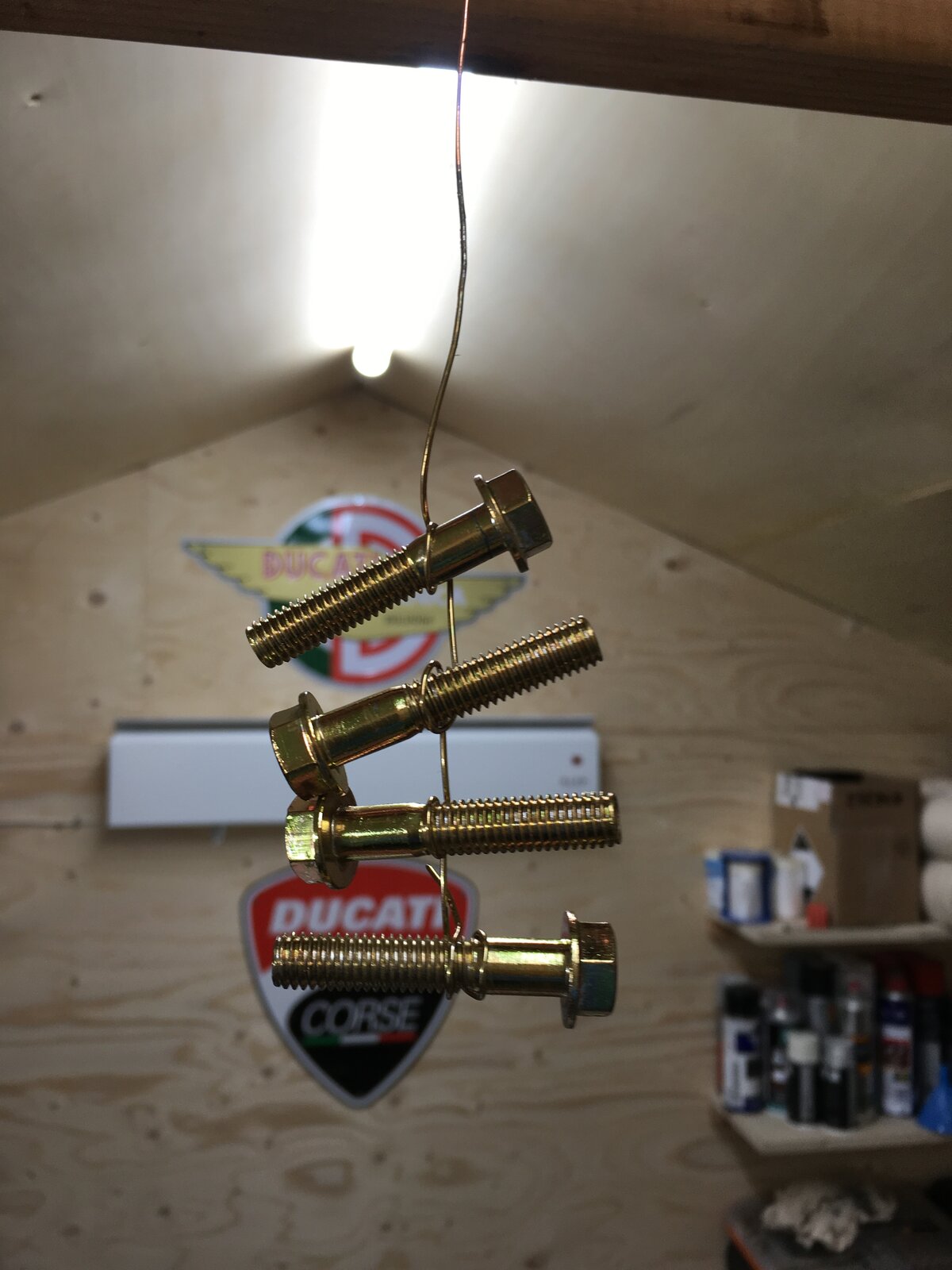

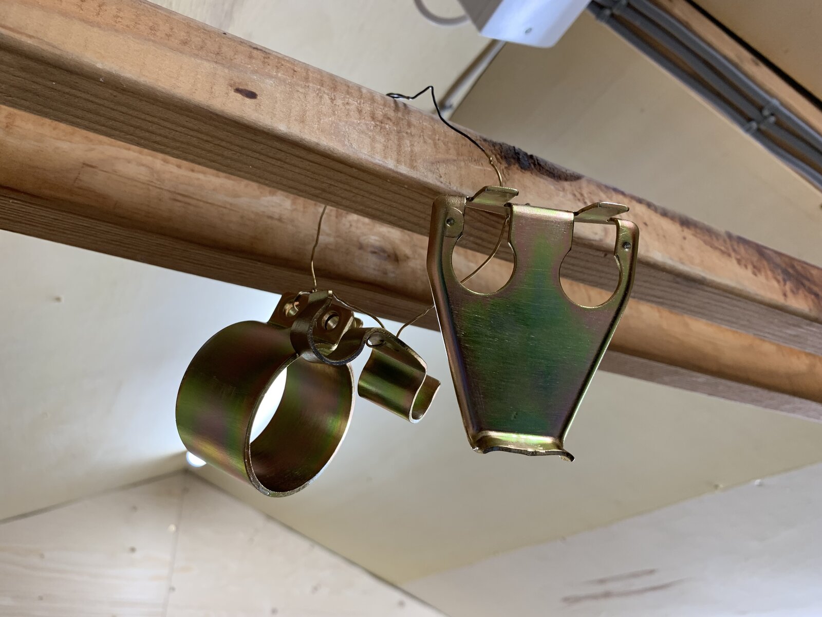

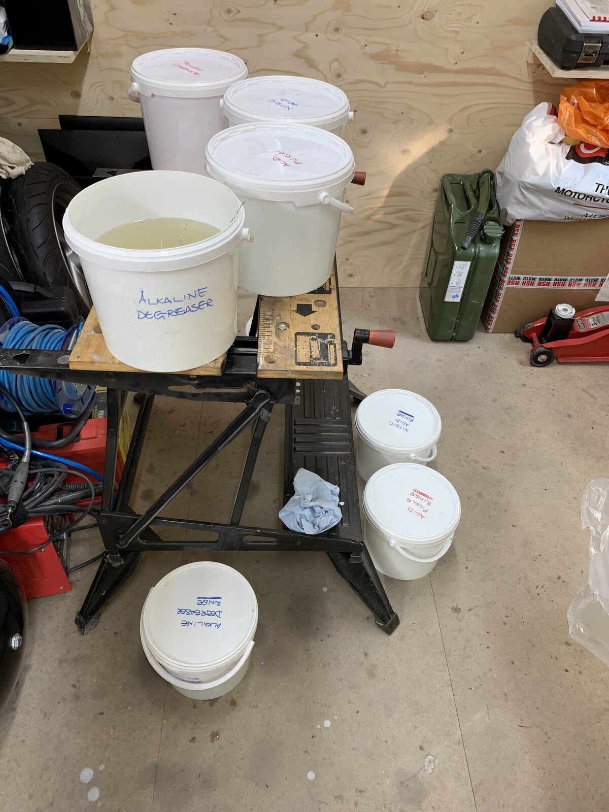

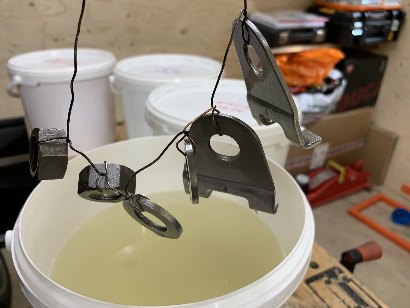

  6. Did mine myself. Very therapeutic. I got the kit from https://www.classic-plating.co.uk/ and also bought the variable power supply. Went the yellow passivation route. 20 seconds in the yellow passivate solution gives this colour and 10 would provide a lighter hue like the originals, but doesn't provide the same level of protection as a longer dip in the passivation solution would.

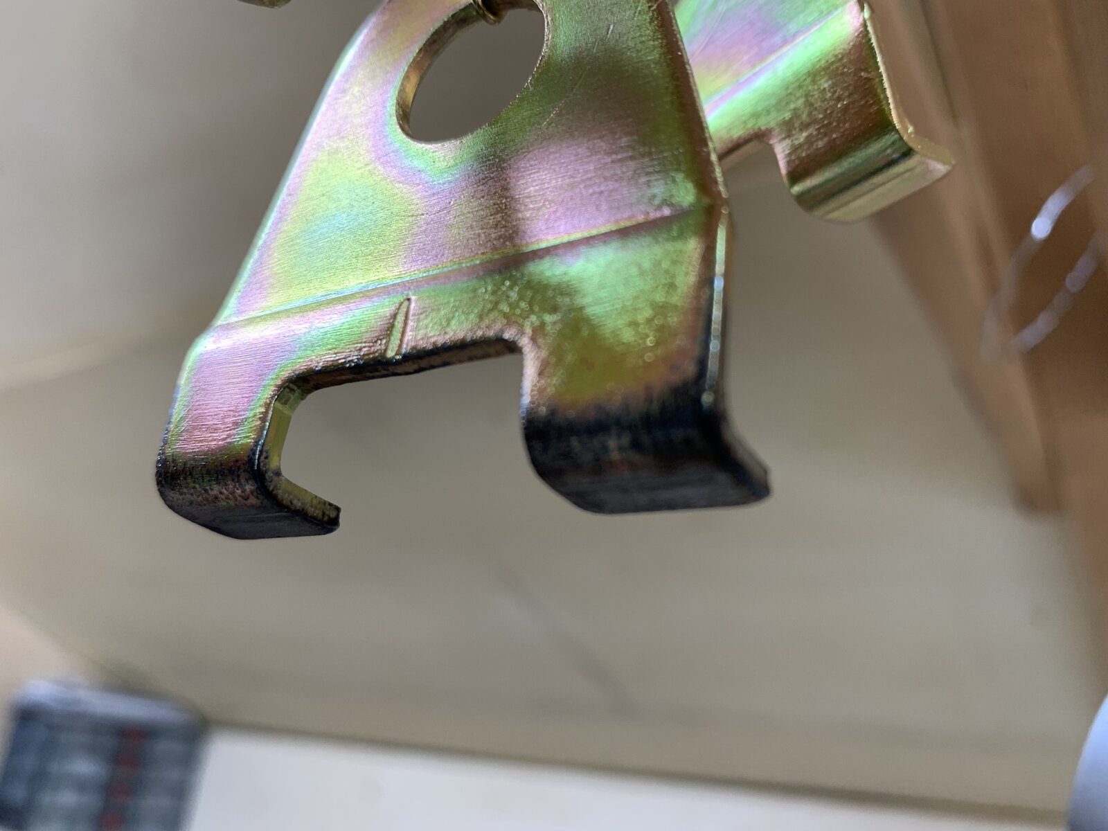

    The black marks on the plating (last picture) are from lowering the parts onto the anodising solution with the power on and it seems to scorch the plating, when the passivation is done. So only lower in with the power off.

    I did my own once but found having all of the buckets everywhere was a right pain!
