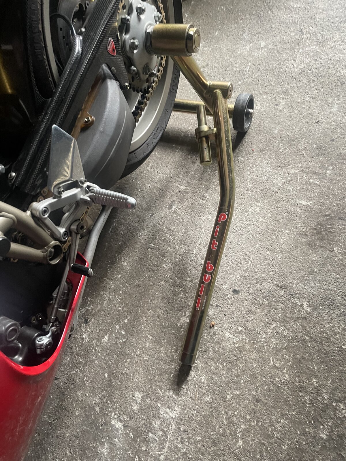

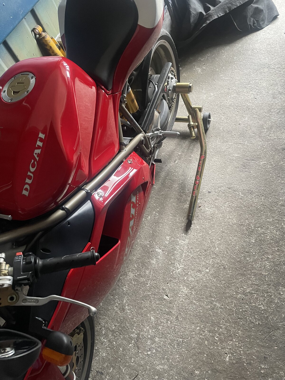

  5. I’ve a pitbull brought it back from the states. Brillant bit of kit esp with the bearing in it so you can rotate the rear wheel for chain cleaning etc.
  6. I’ve seen it reversed to occupy less space, are you able to do that on the 916?
  7. If you mean the arm yes it can be reversed I’ve got it so I can hold the handlebar and the pitbull handle and slip the pin into the rear wheel and just push the bar down and she’s up.

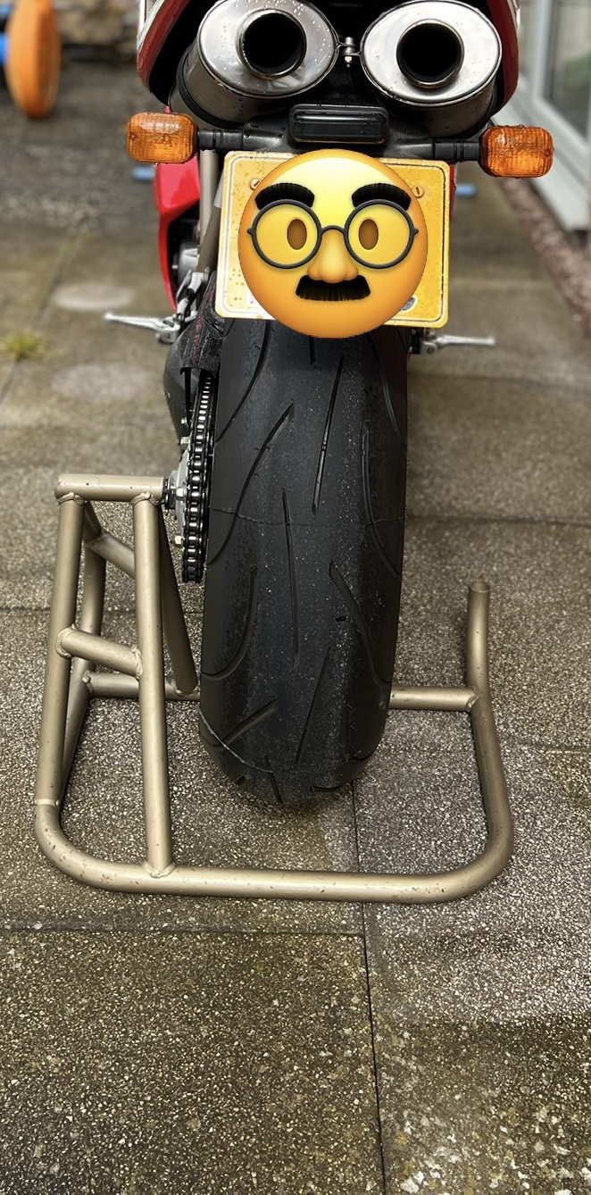

  11. Harris stand, it's got a long stud that goes through the axle from the r/h side with a large conical washer which makes sure the bike cannot work its way off the stand by accident.
    It's also really well made and you can buy different size pins to suit whatever make/model it's being used on.
