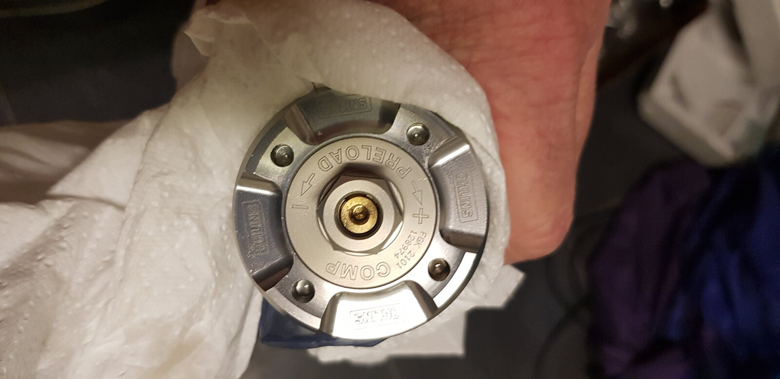

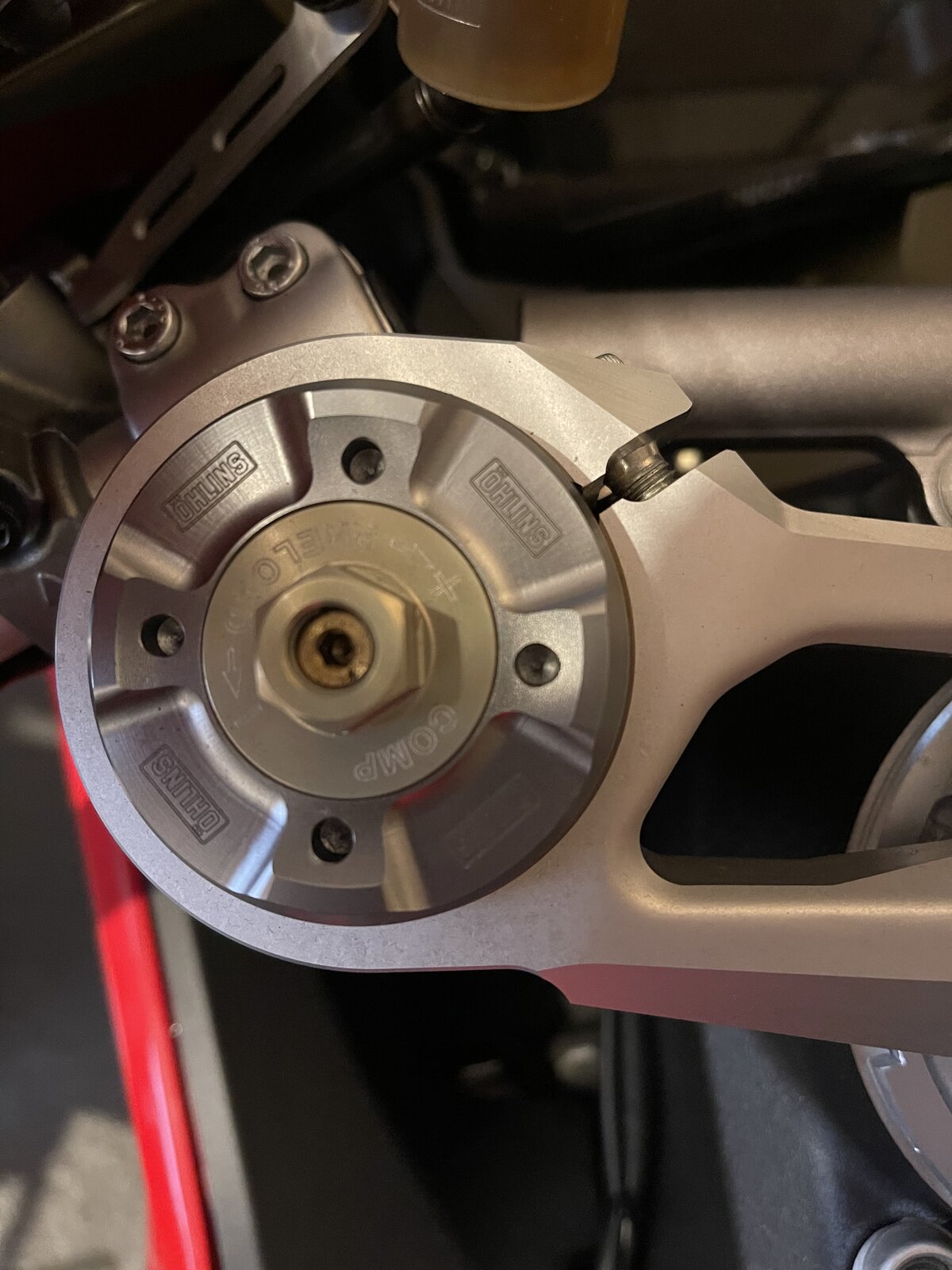

Not my day, that’s the second post I missed the point. To start again, NIX30 has rebound adjustment on one leg and compression adjustment on the other and the Ohlins FGK number is engraved on the top cap. Andy
And I thought the ttx 25 carts had same as you said about the nix , so not sure how to tell these carts apart Or are you saying ttx has a FGK no ? cheers
That looks identical to the FGR TTX25 cartridge kit owners manual picture available from the Ohlins web site. Andy
I thought the same . Thanks next question , if the are the ttx , can I change springs myself ? ( in that; does the pressurised part involve the springs ) I’ve done other fork spring changes . tia
Mounting instructions and owners handbook here, https://www.ohlins.eu/en/products/motorcycle/fgr-178--4174/. If you have the tools, I’d say yes, you can change the spring. Andy
