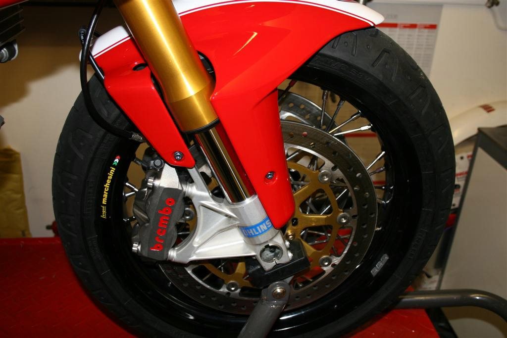

[ Very nice Are they monster 1100s forks or the monster s4r?? Did you have to change the standard discs?? Love the mono blocks think I'll bee having them as well! ?QUOTE=bolds;177855]oh dear glad i never fitted them to mine :wink: View attachment 16442 [/QUOTE]
